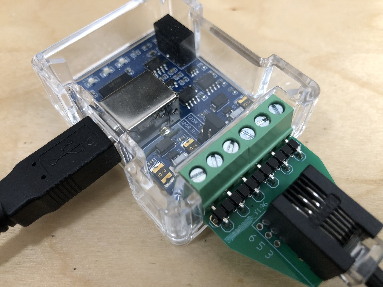

1/ Remove the four screws on the back of the DSD TECH opto-isolator, remove the cover, and then fit one of the included jumpers as shown in the photo below. Then re-assemble.

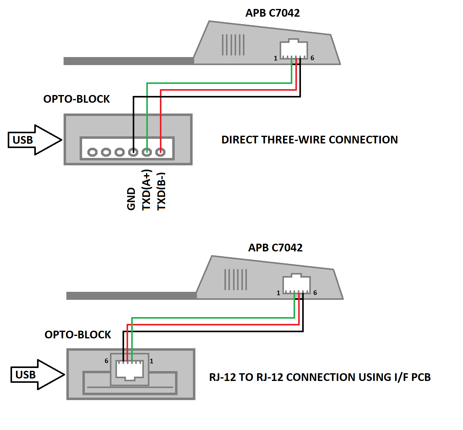

2/ Next, connect three short wires between the DSD TECH opto-isolator and the RJ12 socket on the APB C7042. Take care to wire correctly as one of the pins carries +12V so should NOT be connected by error.
I can provide a simple connector board which eliminates any need for attention to wiring details and the use of an RJ12 crimping tool. This is shown on the right hand side in the above photograph.
The wiring diagram for direct wiring or using  the connector board is shown next.

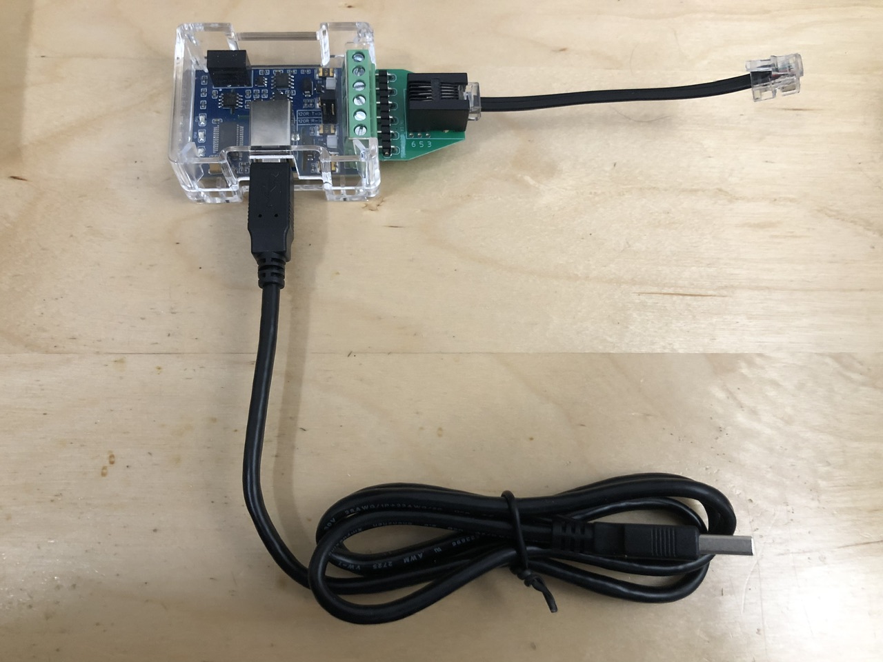

Images showing the connector board which fits into the six screw terminals of the DSD TECH opto-isolator at one end and the APB RJ12 socket at the other end.
[+] 3 members Like Dr_C2's post

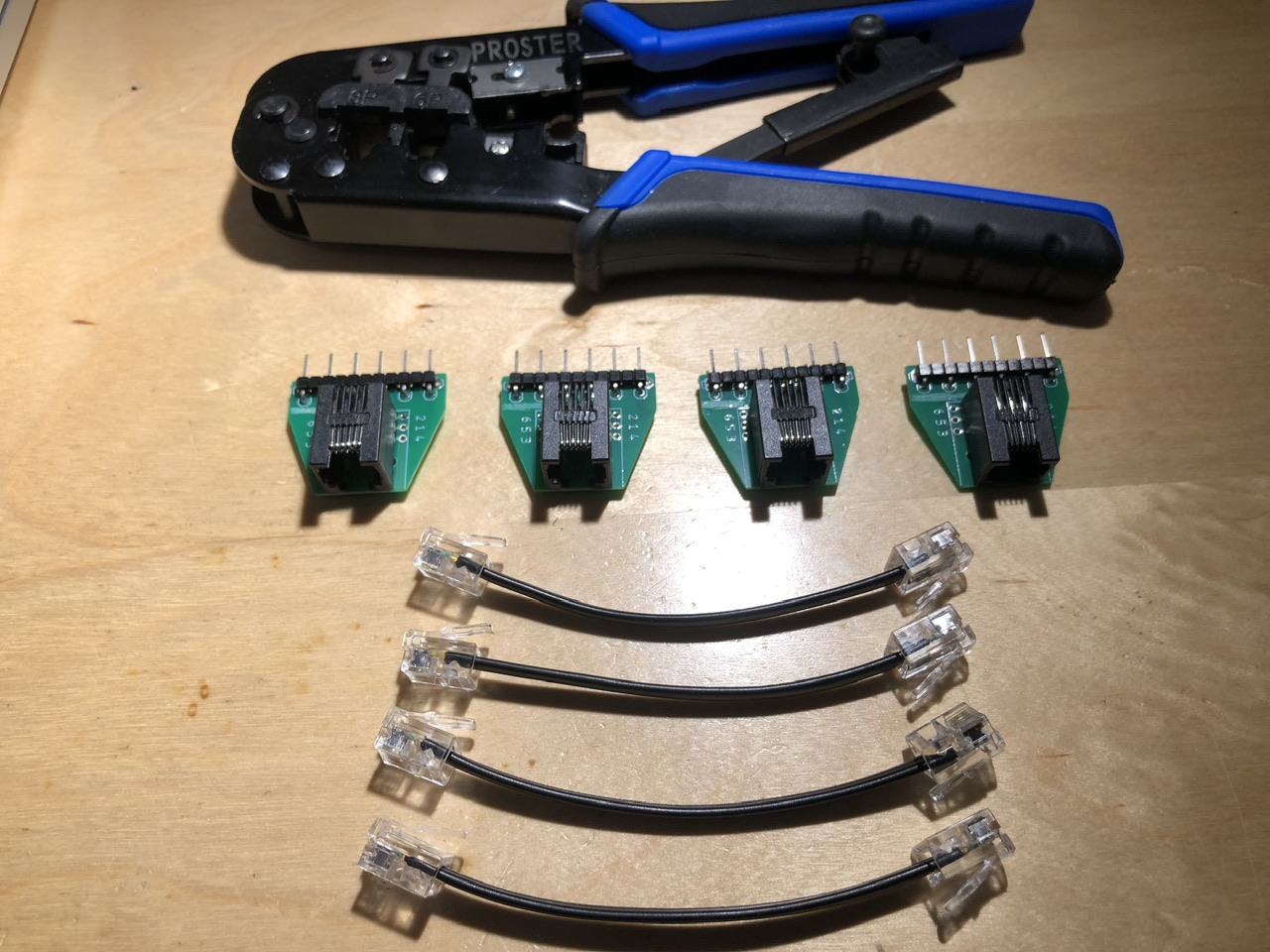

And for those who asked for the connector board - I made up a few which are heading for the post office!

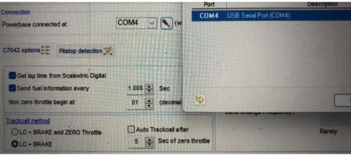

3/ my version of the opto block uses the FTDI chipset and when I look in the windows ‘device manager’ I see the USB port has an FTDI driver installed.
4/ Photos below show my PCLC options/setup screen.
Possibly you have the wrong driver pre-installed?
