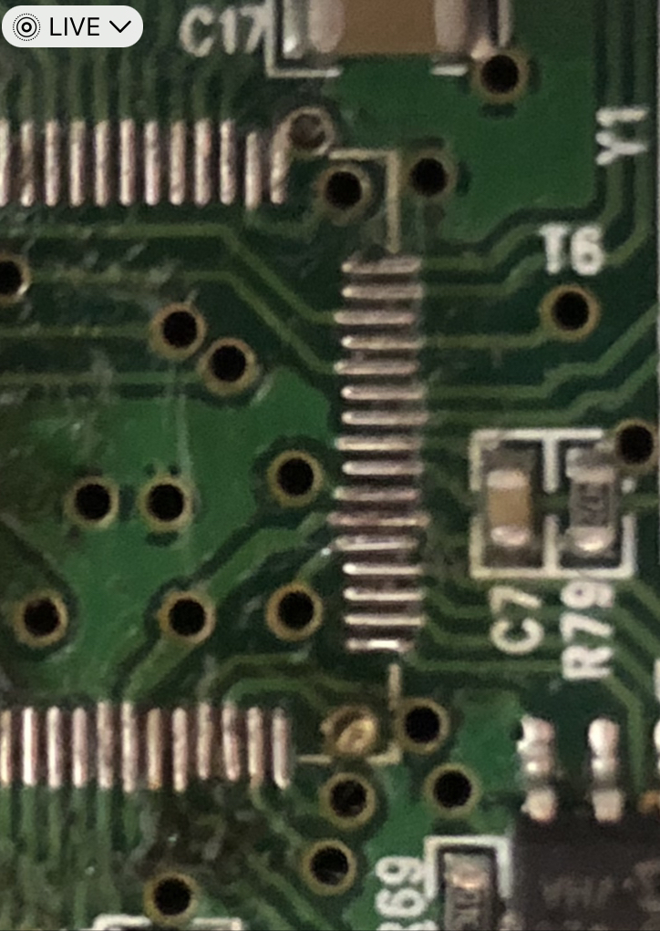

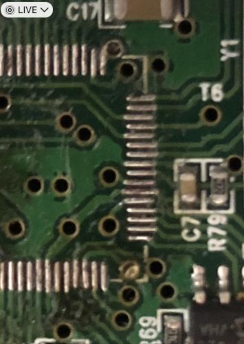

For completeness, here is a zoom-in of the microcontroller pads on the APB main board once the microcontroller has been removed.
The pad pitch is 0.5mm i.e. very fine.
