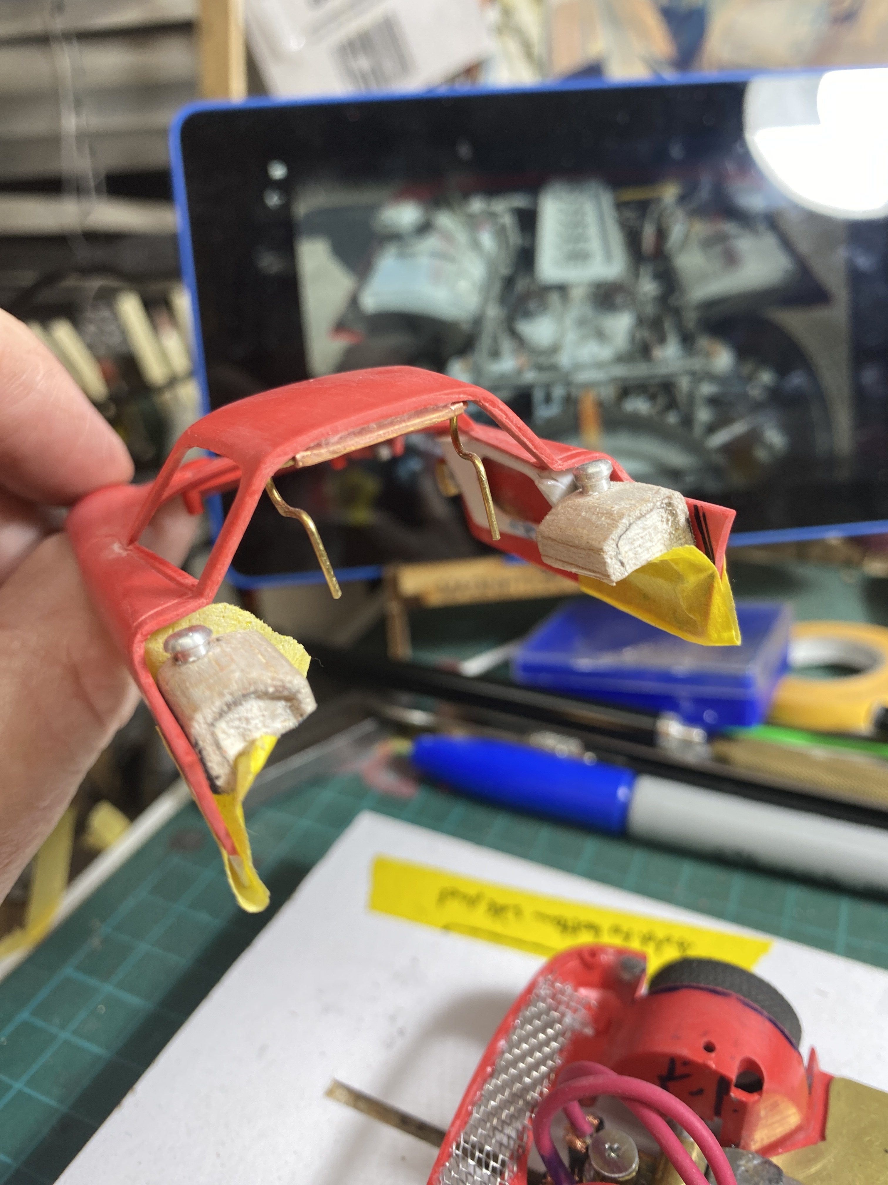

I remembered I had a few different size magnets and decided to try and use those as I wanted the boot to open.
I very patiently scribed around the mould lines of the boot, once I got through most of it apart from the two sides.
I made a hinge out of brass tube and rod.
I got this idea off Doug Whyte of Model Car Muse, this guy has a youtube channel and he is a wonderful model maker.
I then glued the brass tube with some quality super glue that Dave Diamond who is a on a scratch build facebook page I follow recommended (not sure if he's on here) then added loads of araldite to it once dry.
You can also see in the above pic where I glued the button magnets.
The model kit had small plastic male female fixings here, which I dremeled out and glued a magnet top and bottom in each corner.
I don't think I need to add the fixings I asked advice about now as these magnets snap in quite strongly.
Next step was to carefully scribe the remainder of the mould lines and the boot is separated from the rest of the body.
Next fixing to add is at the front, I'll probably ad magnets also so there's no fixing's visible underneath, because there's going to be some mesh added and its a nice looking front end. I don't want screws under there if possible.

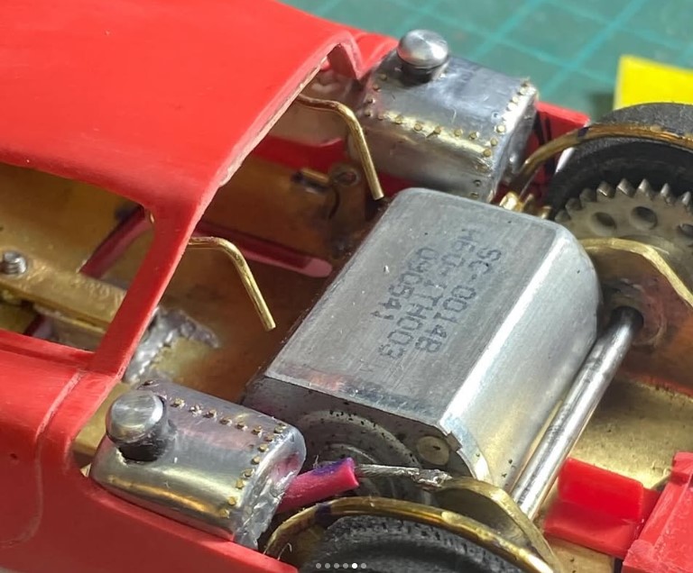

I've got a 3D printed motor coming from a friend who I met on a model site.
This will get installed in the back, hence why I've made the hinged boot.

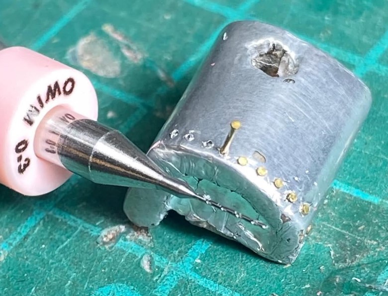

Could you please post a close-up of the end of that tool you made to score through the plastic

(16th-Oct-24, 07:22 AM)Kevan Wrote:  Could you please post a close-up of the end of that tool you made to score through the plastic
I'm not sure I can get much closer Kev with out distorting the pic.
It's a Tamyia fine engraver and it goes into a pin vice.
I'll try and take another pic.
#27
I just googled 'tamiya fine engraver' and all became clear  Thumbup

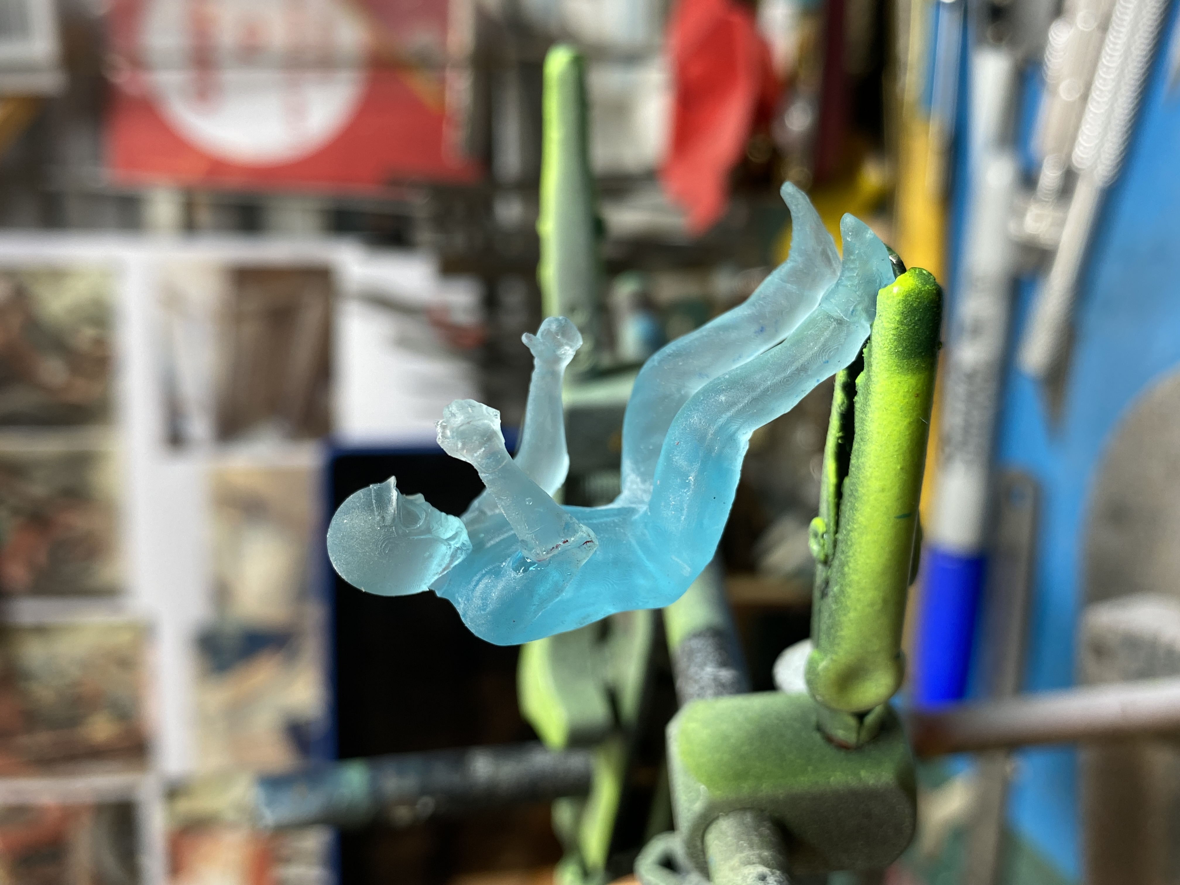

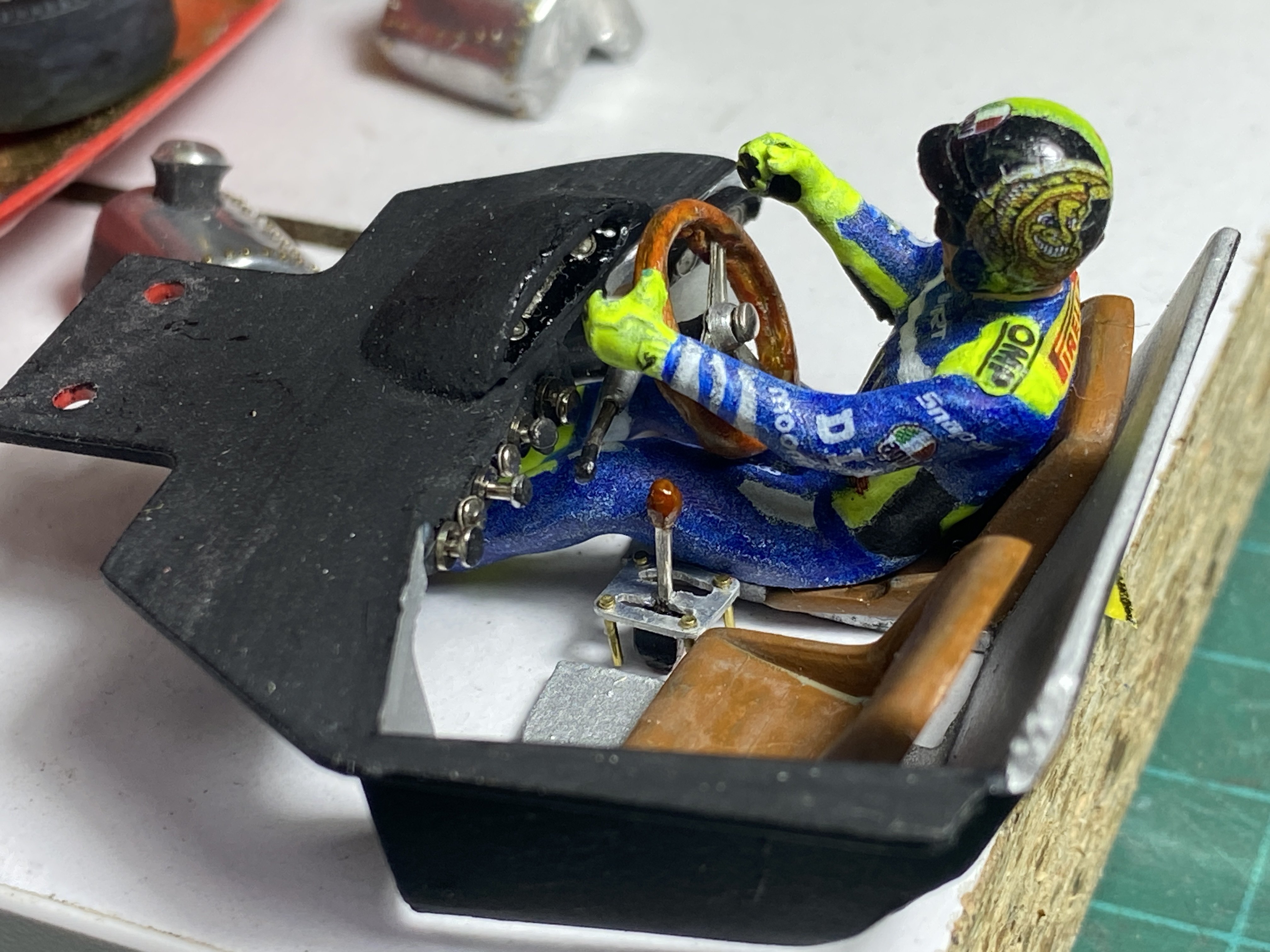

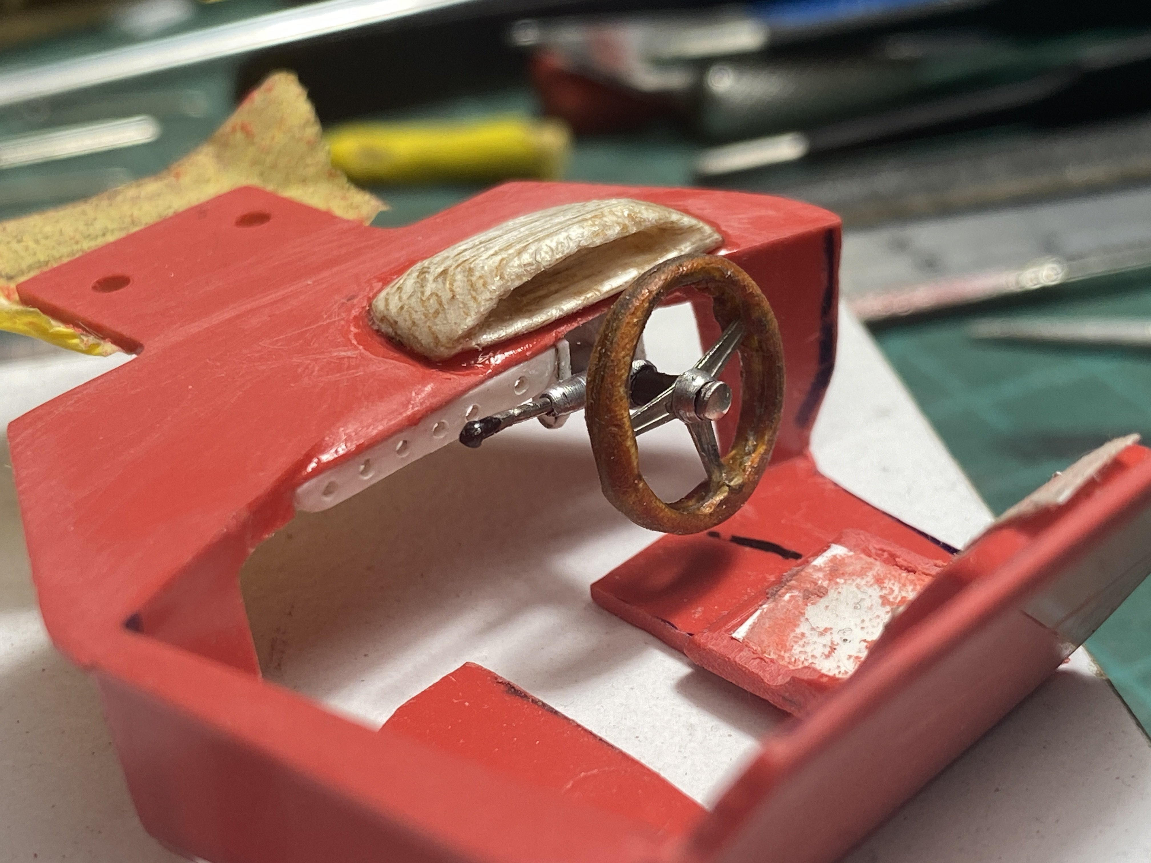

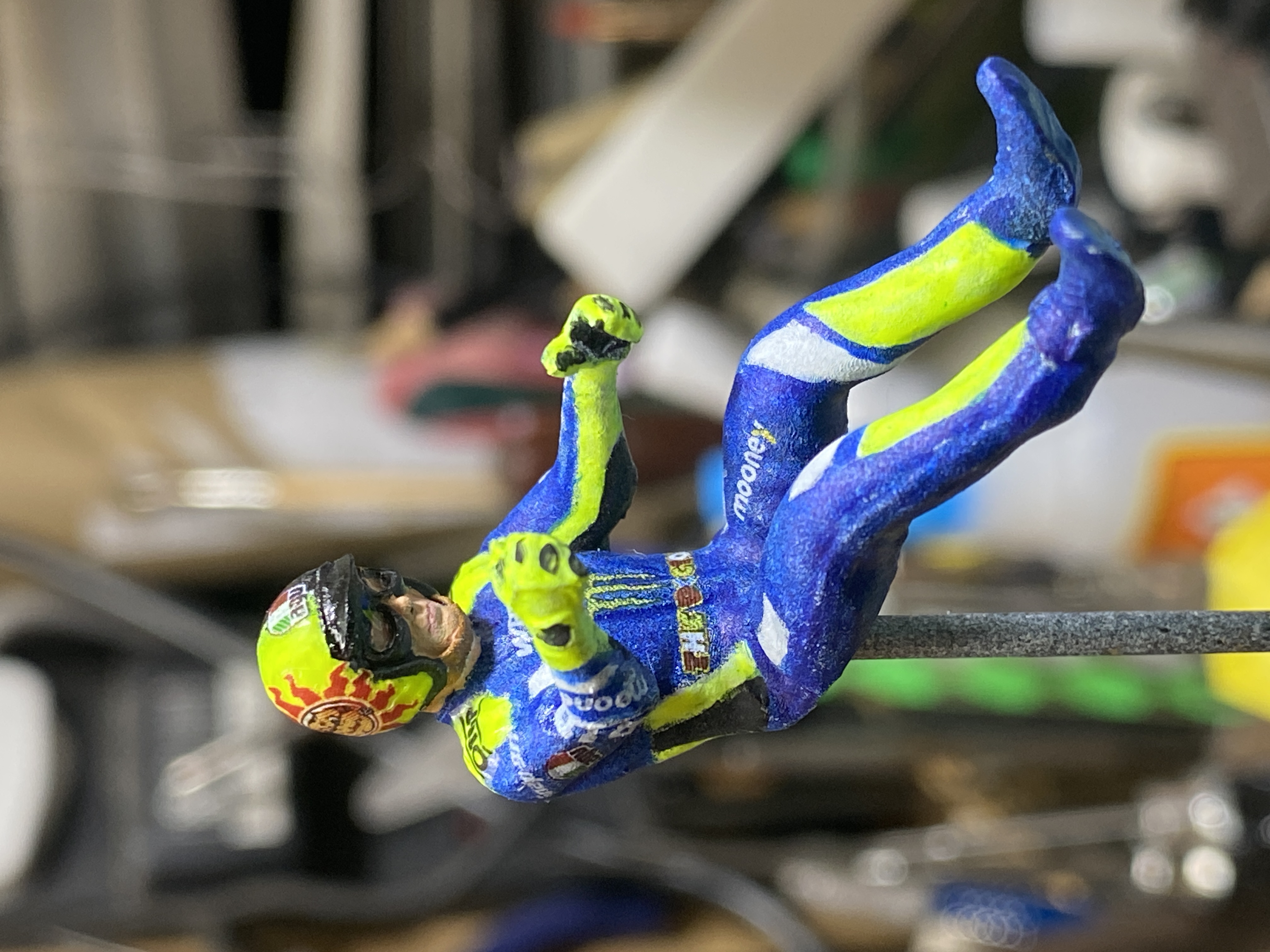

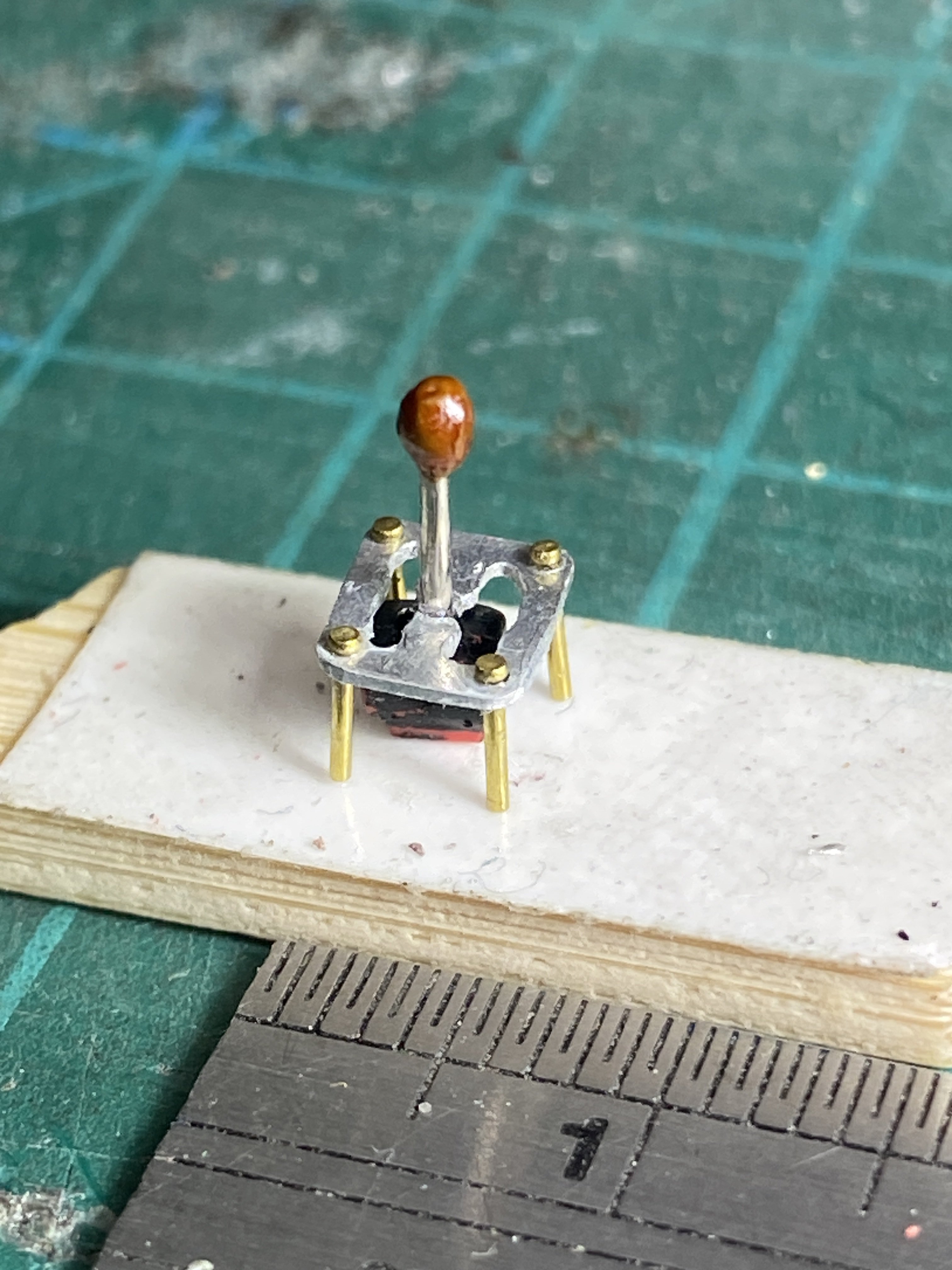

I've got the driver painted up and cut and moved his arm so he's sort of waving out the window, the dash is all scratch built and steering column and gear leaver.

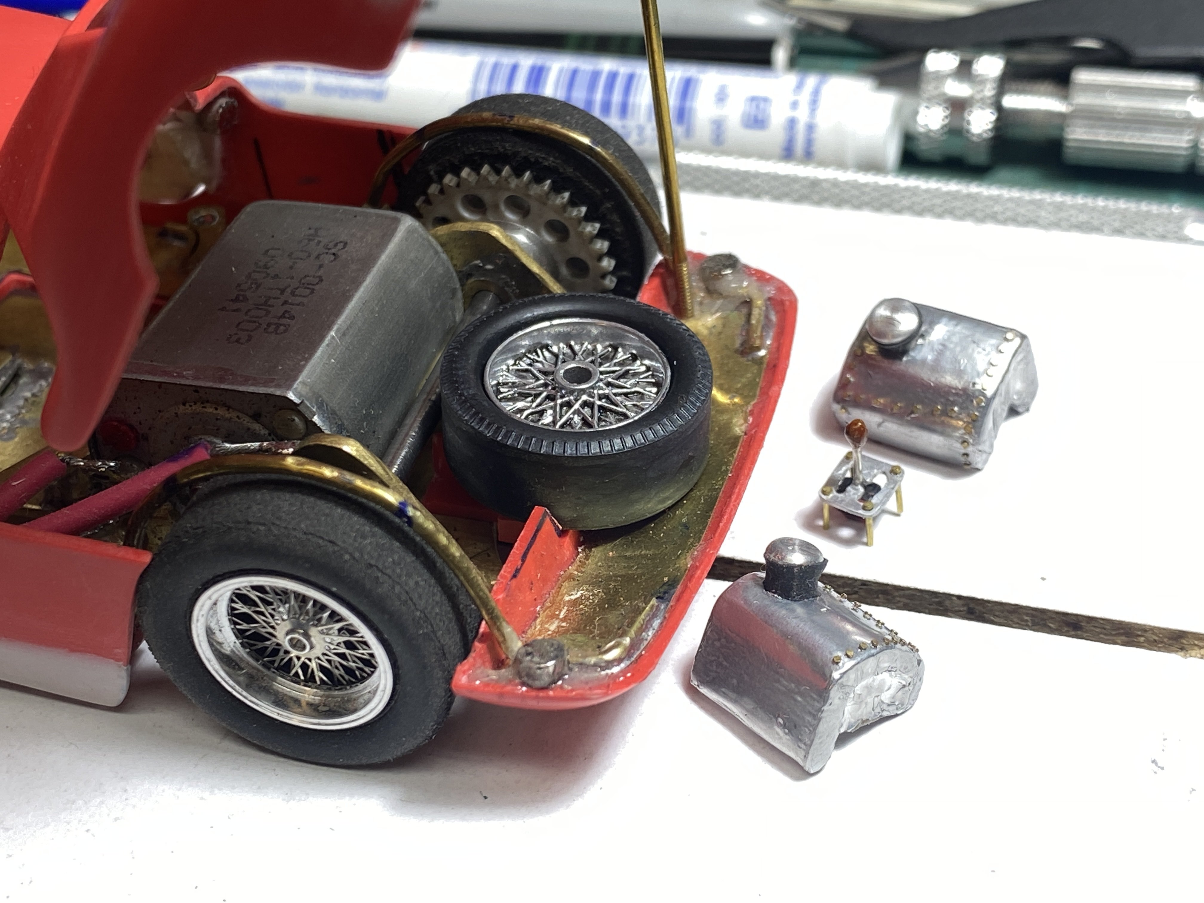

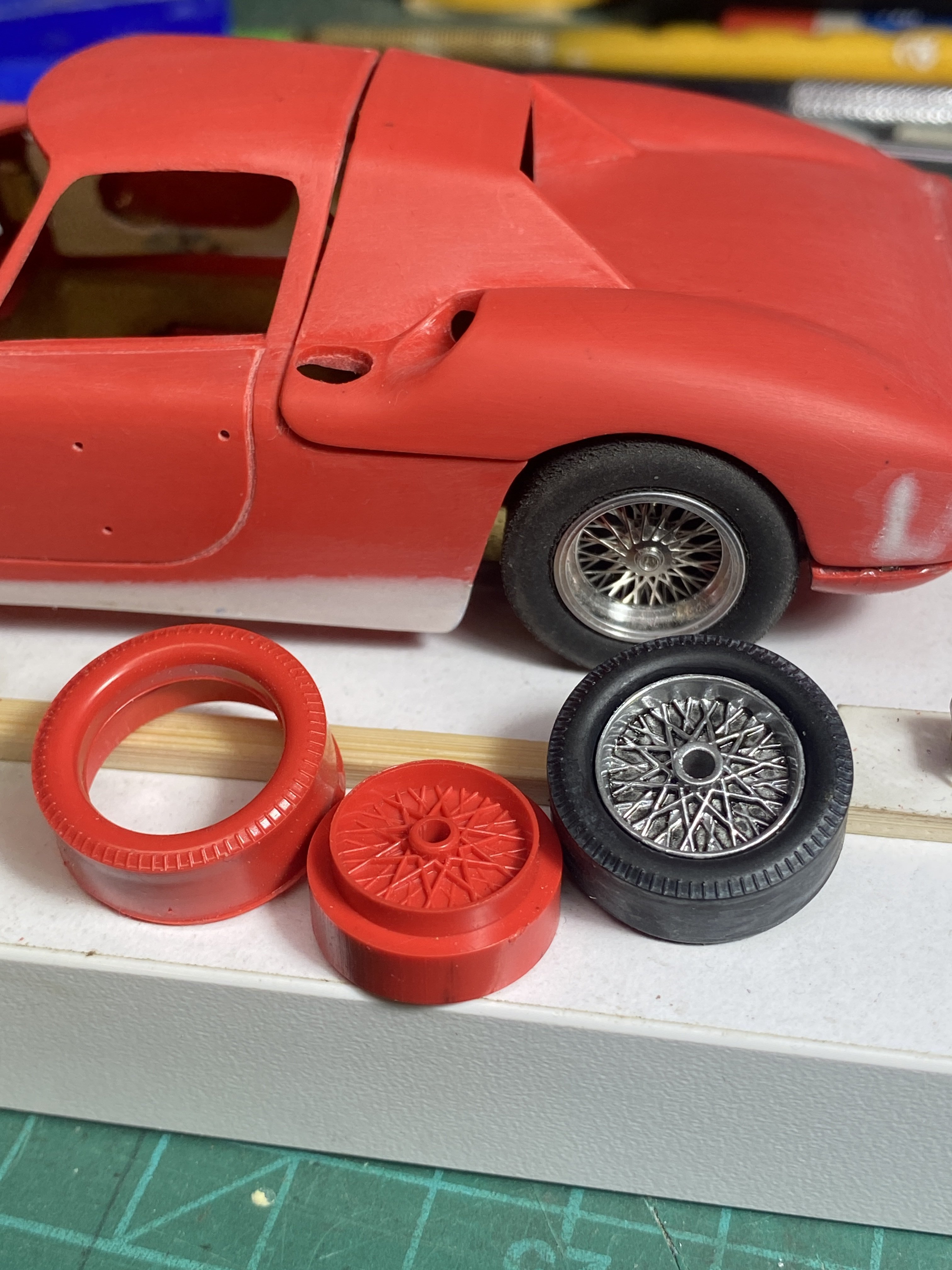

I was going to use one of the Pendle spoke wheels as a spare in the boot, but decided not to break a pair up.
I attempted to make one of the Airfix tyres looks as realistic as I could. It's a lot lighter in the back as well.

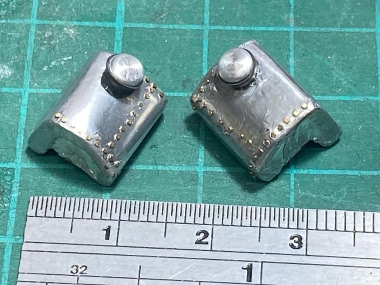

I made some petrol tanks from Balsa and had a go at ali foiling using kitchen tin foil.
It's pretty mad that you can get this stuff to conform like it has, then sand and polish it. Better ali finish than any paint can give in my opinion.
The tanks will get fixed in once the body is painted.

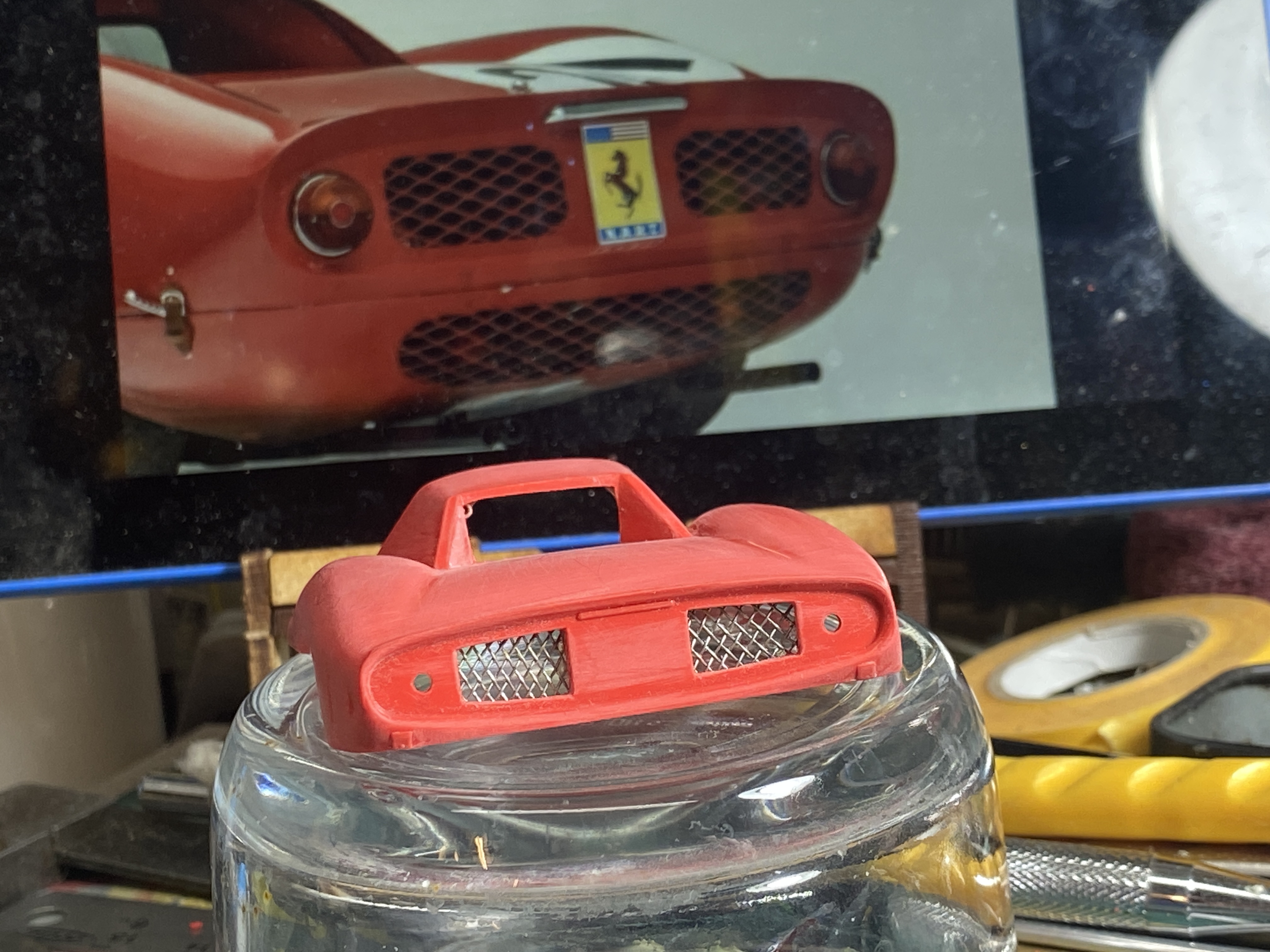

I can't remember if I post the mesh gills, I stole my wifes sieve and cut pieces to shape(I did buy her a new one Rofl )
    I've done one at the front but can't find the photo on my laptop.
