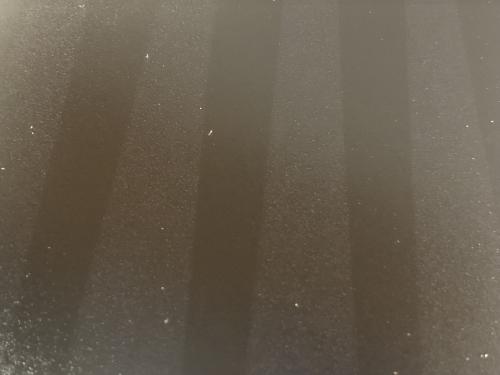

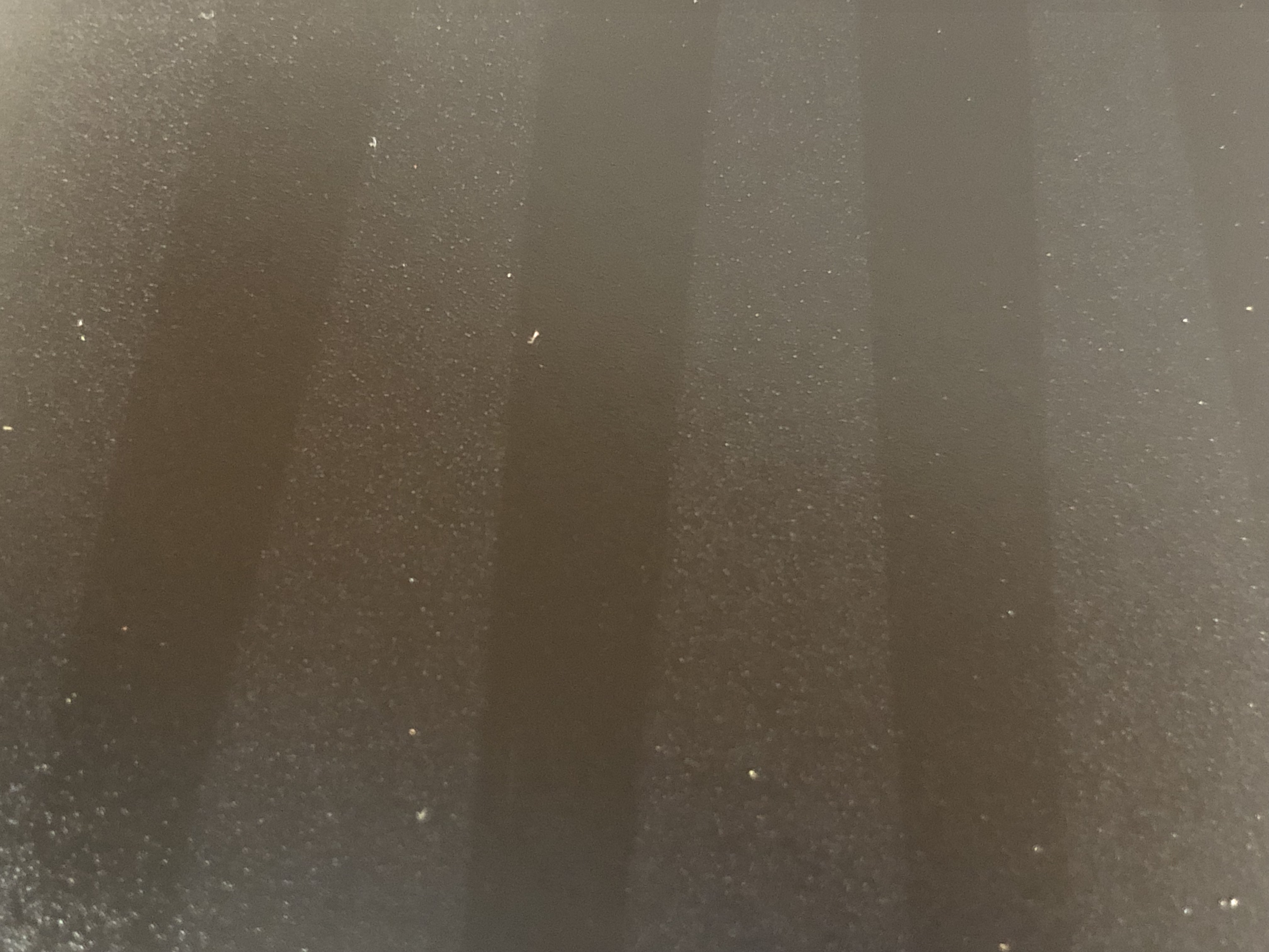

Meanwhile I am curious about the technology… I see the cars use a downward facing optical motion sensor and I see the hybrid track uses a micro-textured surface for guidance. This appears to comprise of parallel wedge shaped patterns which taper right to left across the track. I presume after optical detection and signal processing this gives a signal with a mark to space ratio that corresponds to the lateral position across the track.
I’m guessing the optical sensor uses technology similar to the optical mice we attach to our computers.
But I wonder, has any of this already been reported? It’s very interesting and certainly a highly innovative way to replace the physics of a slot and guide!

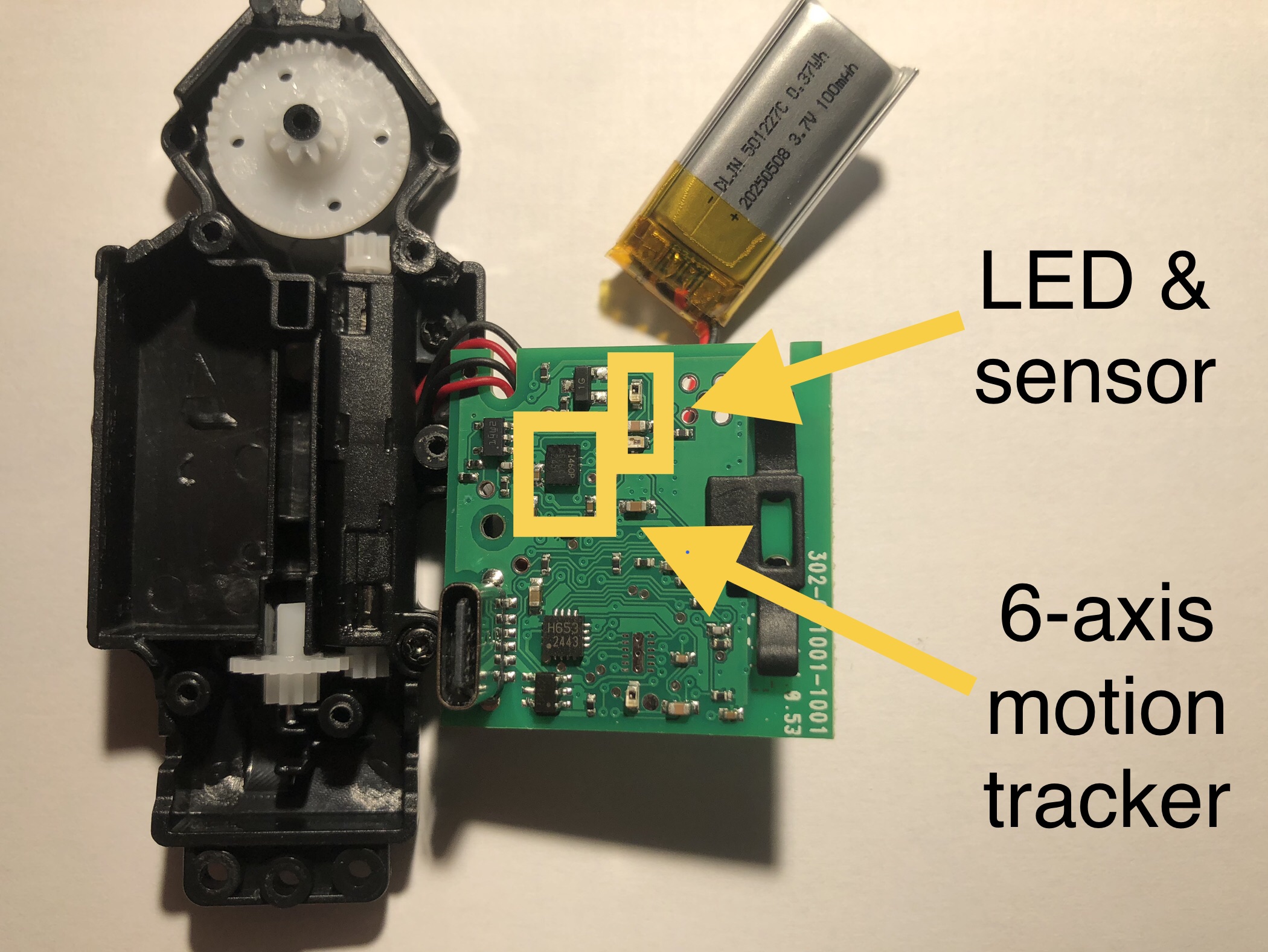

A view of the in-car circuit board of the Carrera Hybrid system showing the two components of the steering sensor system:
1/ The track reading LED plus optical sensor configuration which uses glancing angle illumination to detect the track patterns described earlier.
2/ A 6-axis motion tracking sensor i.e. gyro plus linear accelerometers.
Track racing will use a mix of these sensors while non-track racing will clearly rely on the latter.
It all makes sense - what a technically innovative system!
c
13th-Aug-26, 05:59 PM
Meanwhile the component labelled ‘H653’ is a Toshiba TC78H653FTG which has the drive circuits on board to control two brushed dc motors. Presumably one for forward/reverse drive and one for steering.
On the other side of the board sits the wireless/processor chip - an nRF52832.
c
c
