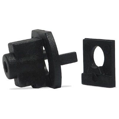

Hello Top Down,....as well a several 3D printed adapters, Slot-it do make an adapter to allow the use of a typical FC-130 motor in the SCX cars.
Slot-it # SP08.
Chris Walker
[Image: slotit-sp08-adaptor-v12-to-rx-shape-motor.jpg]

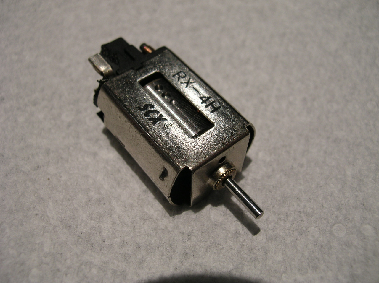

I seem to remember a club member saying a Parma Deathstar armature fit the SCX cans
(25th-Nov-25, 08:49 PM)Kevan Wrote:  I seem to remember a club member saying a Parma Deathstar armature fit the SCX cans
A quick google search finds info regarding this 'tweak' back in 2006
While it does fit,...the "Deathstar is wound with 70T of 30 AWG wire, which for the stock SCX magnets is a touch too much, as the motor will run hot particularly with any "homeset" type power supply.
If anyone is planning a rewind, 80T of 31 AWG wire is much more appropriate, but will still need a decent power supply ( 5+ amps min.)  a comm. true, and some better motor brushes, to replace the hideous things from SCX.
This wind will be a considerable step up from stock (approx. 35/40 K), with very good torque......and will likely be beneficial on only the longer/wide open club tracks.
A quick note/tip on the stock SCX motor brushes,...if the motor has been oiled/used these brushes tend to hold oil, which will cause the brushes to deteriorate quickly and the "stuff" will clog the comm slots, reducing performance/response. There is a quick fix that really works wonders for the SCX brushes..take them out, noting left/right, and, top/bottom......place the brushes on a hot (clean) soldering iron, and when they stop smoking, let them cool, and replace as they came out. (Clean the comm slots before replacing).
Chris Walker
An SCX rewind + for a club member,....80T x 31AWG,....Mura comm (trued), epoxied/balanced, magnets zapped, 16D brushes etc. etc.
[Image: DSCN5099.jpg]

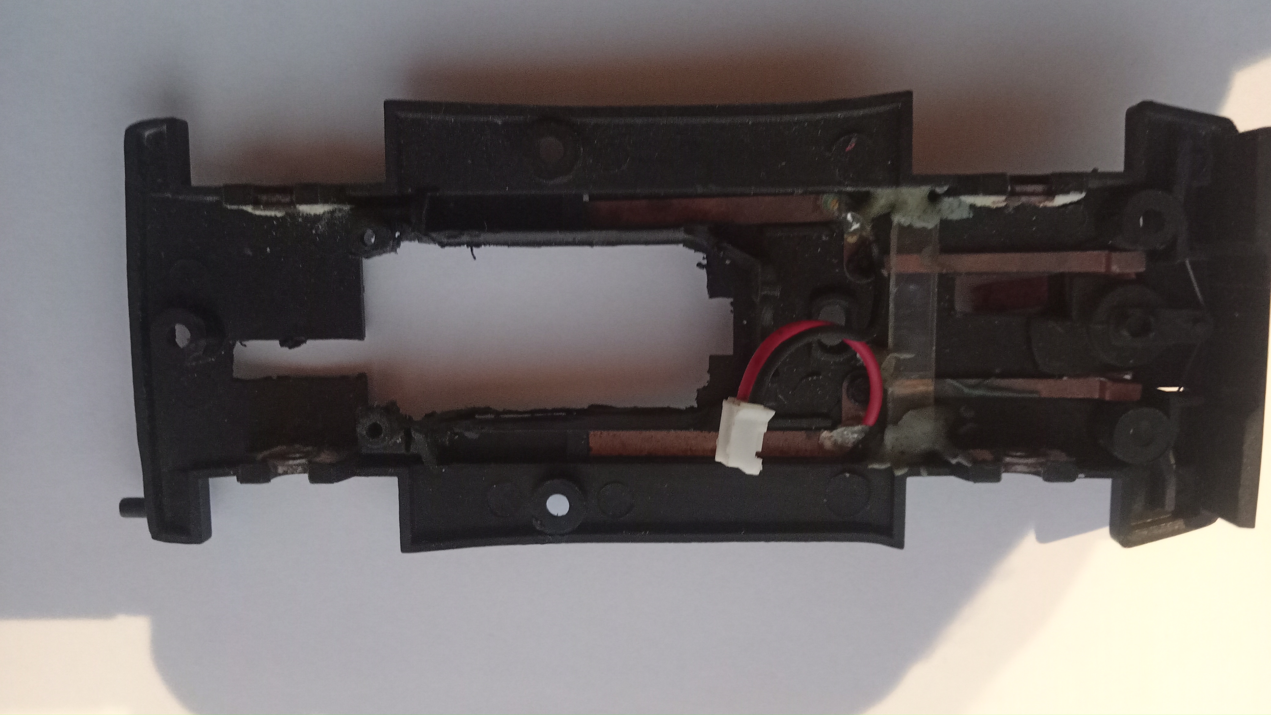

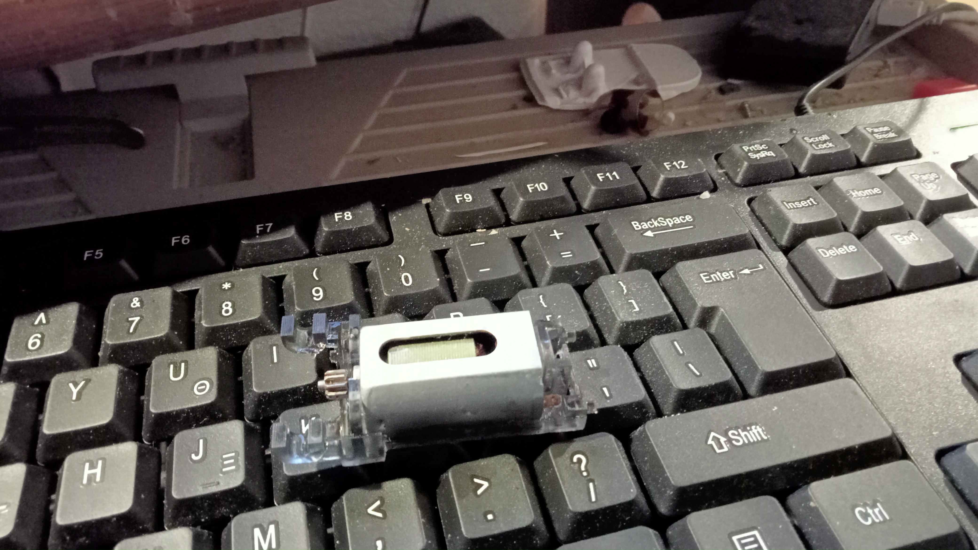

I have designed and printed several motor pods for SCX cars to allow mabuchi or boxer motors to be installed:
2 pins motor  pods
single pin motor pods
I have also designed an adptor to allow boxer motors to be installed on non poded chassis but surgery is needed,Lancia Delta chassis before surgery
after surgery
adaptor fitted
