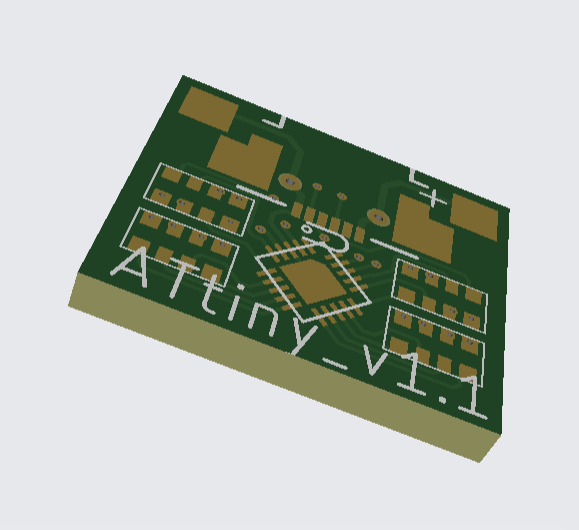

Here is the prototype PCB showing the location of the ATtiny3226 and the LED biasing resistors. The LED display modules are to be attached on the other side of the PCB. The board measures 14.5mm x 12.5mm.

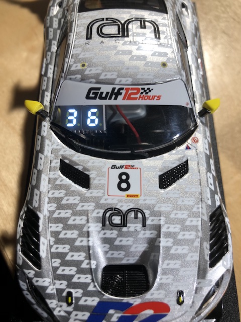

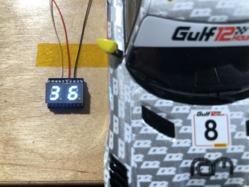

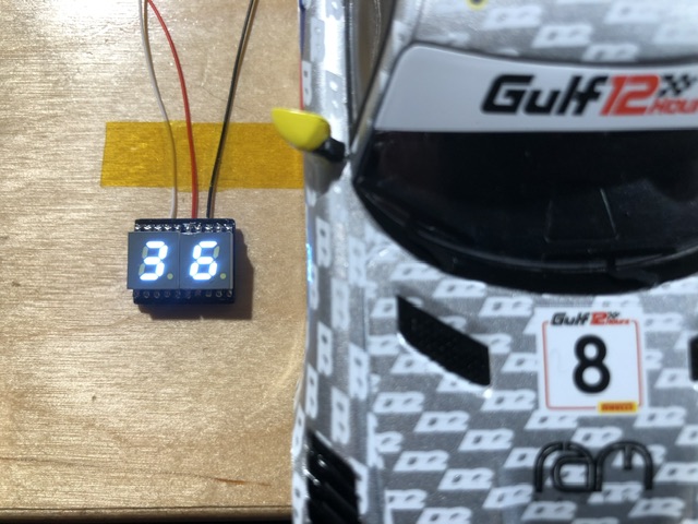

The project is starting to take shape :)
c
[+] 3 members Like Dr_C2's post
Very cool to see a functioning prototype as opposed to an image taken from an Amazon product page.
Keep on innovating! :)
printables.com/@MrFlippant
[+] 1 member Likes MrFlippant's post
#10
A car displaying its ID.
