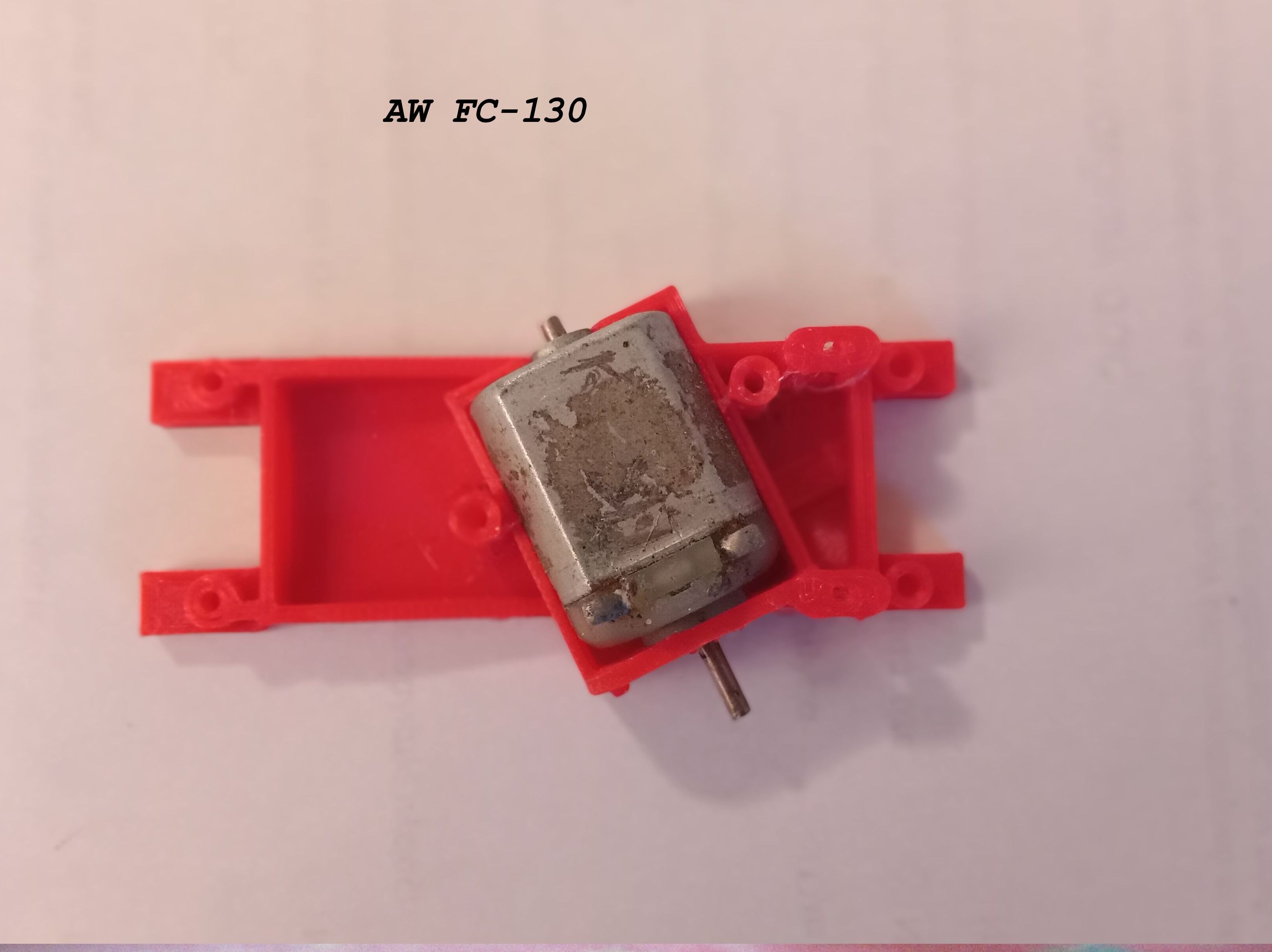

Posts: 285
Threads: 53
Likes Received: 402 in 177 posts
Likes Given: 39
is this what you are looking for?
Posts: 4,528
Threads: 147
Likes Given: 4,215
Do they fit the Scaleauto 6649B chassis he's using?
