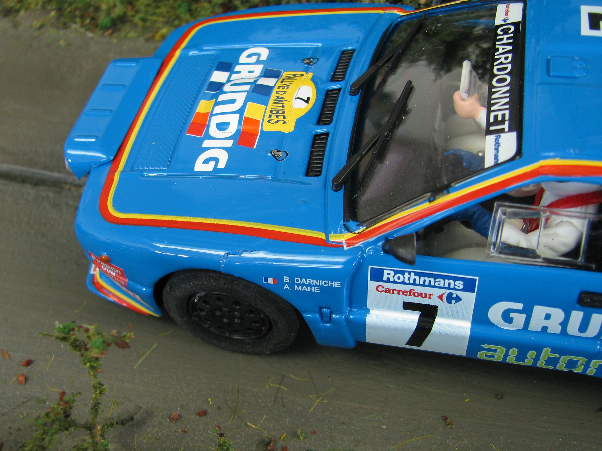

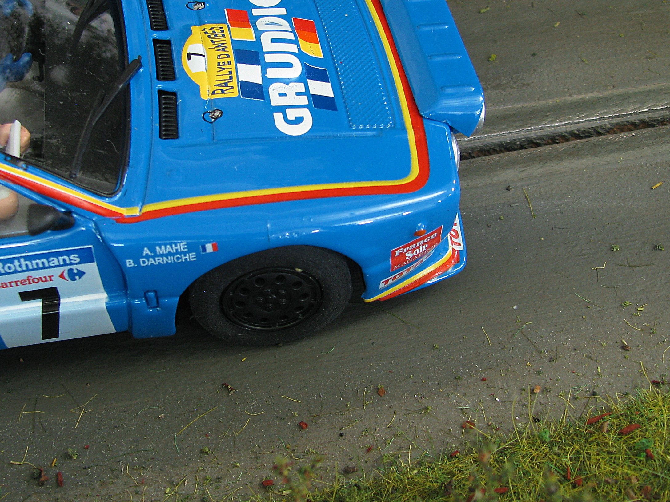

When mounting the bodywork on the floor pan, I noticed that the bodywork above the front wheel arches was torn on both sides.  Banghead
This couldn't be repaired and it was my own fault, I thought, so I bought a new one.
The windows on that car were also not perfectly positioned, but not as bad as the first car.
On this car I noticed small hairline cracks in the paint above both front wheel arches, which are not present on my other Fly 037 Lancias.
This confirms that Fly has a serious problem in the production process that quality control should pay attention to.
