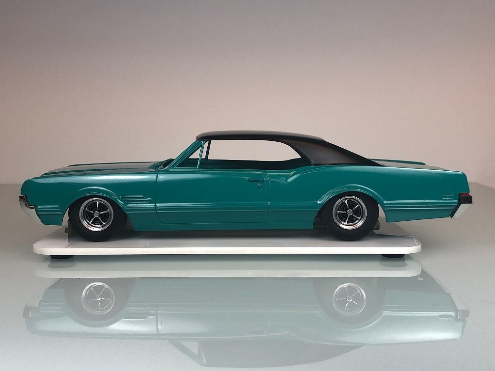

I humbly thank you Kevan. You are very kind.
It is indeed an "Olds mo boat".
