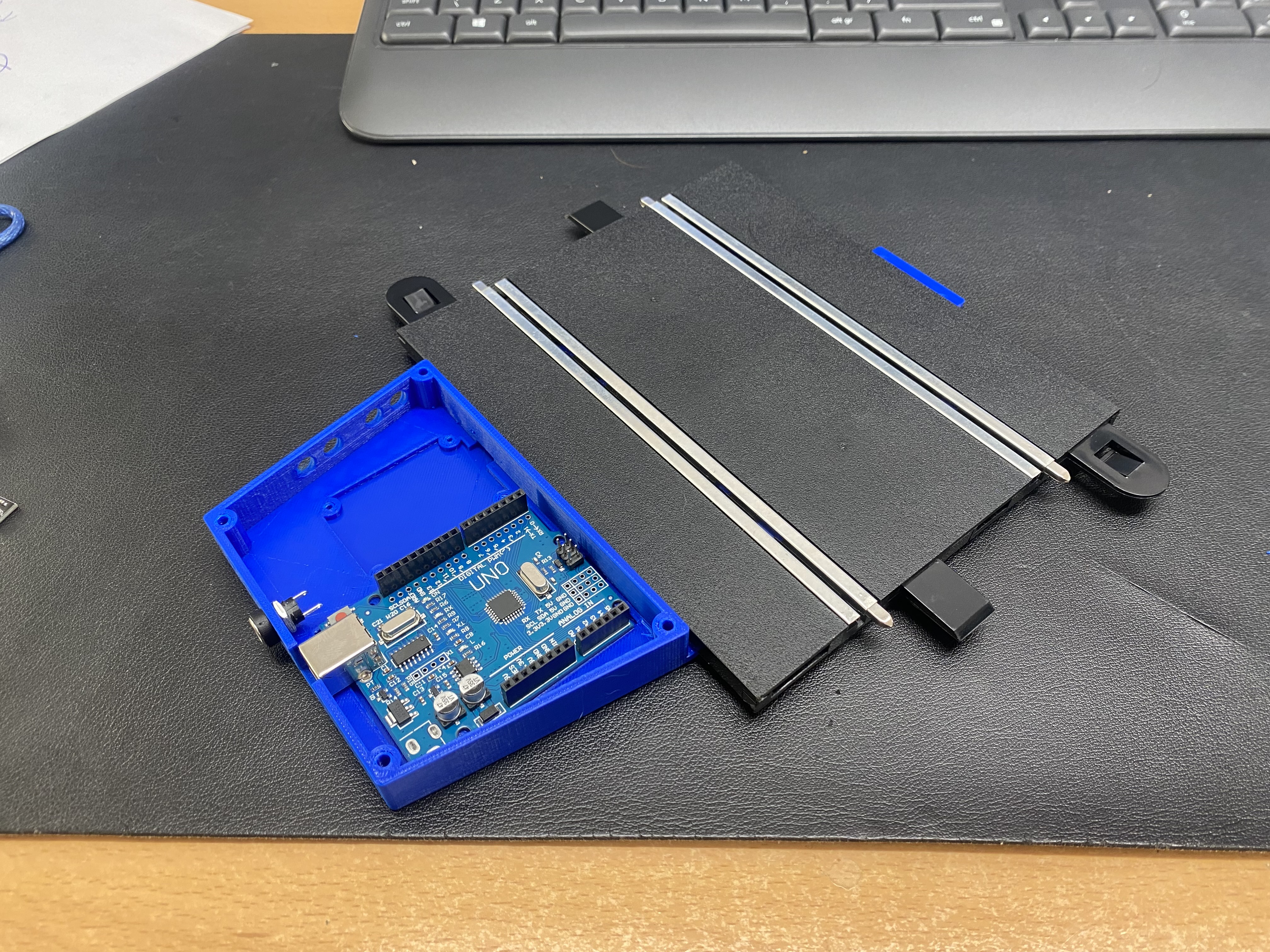

I run a semi temporary 2 lane Scalextric sport track with an arc one for timing along with a basic base and 2 power supplies. My plan is to build the following
Single power base
Single power supply
Photo-sensors for timing
Blu tooth connection to PC
Plug in booster cables
Start lights
Call button/buttons

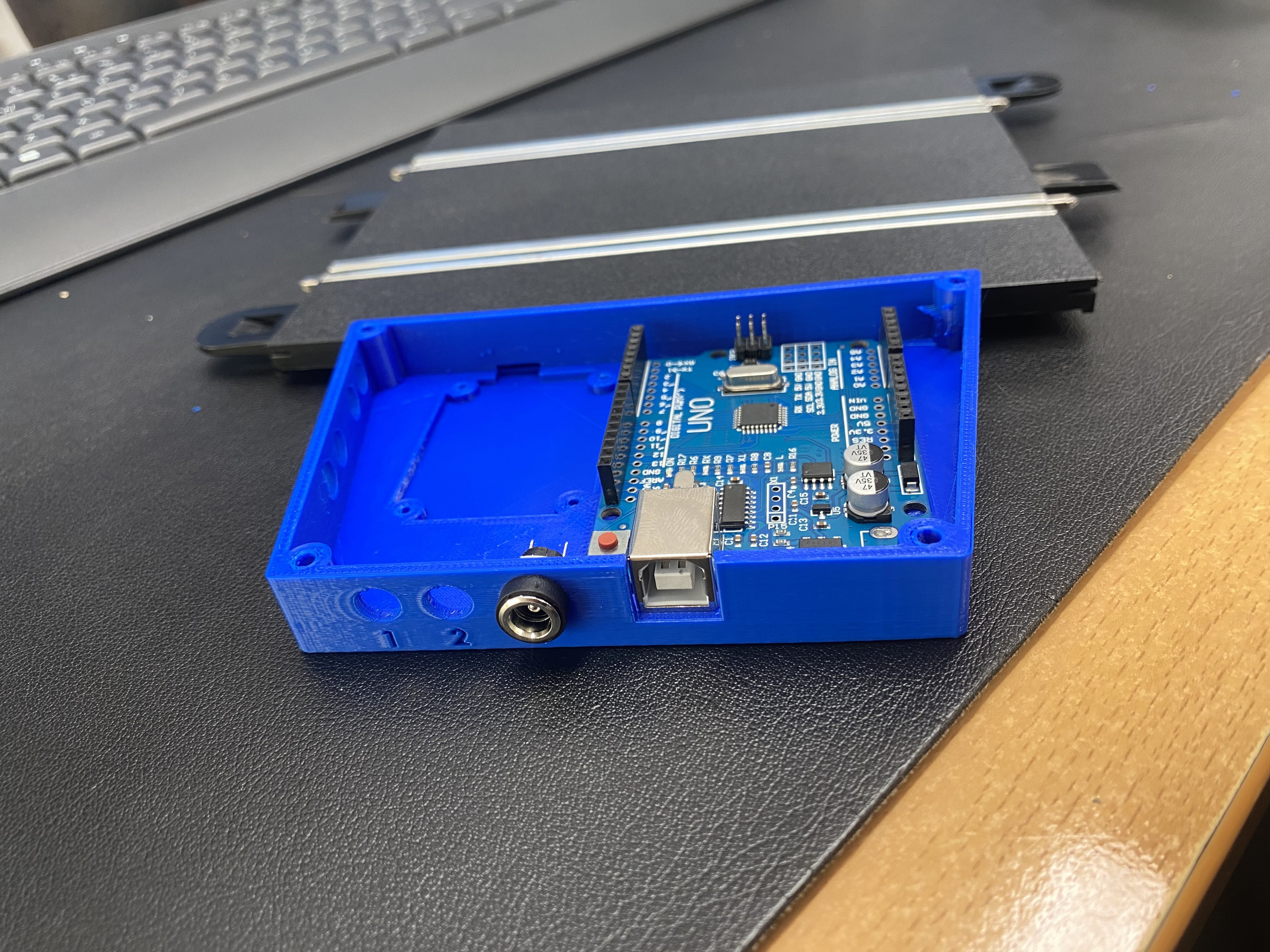

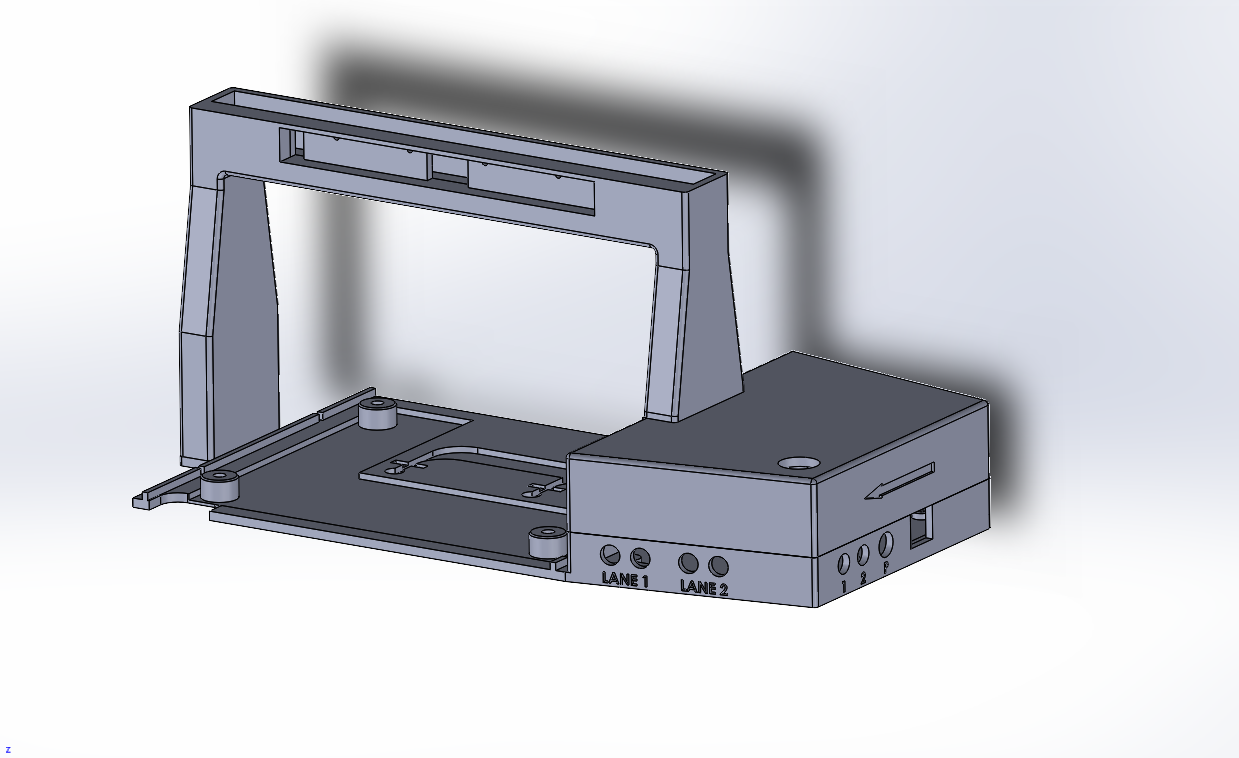

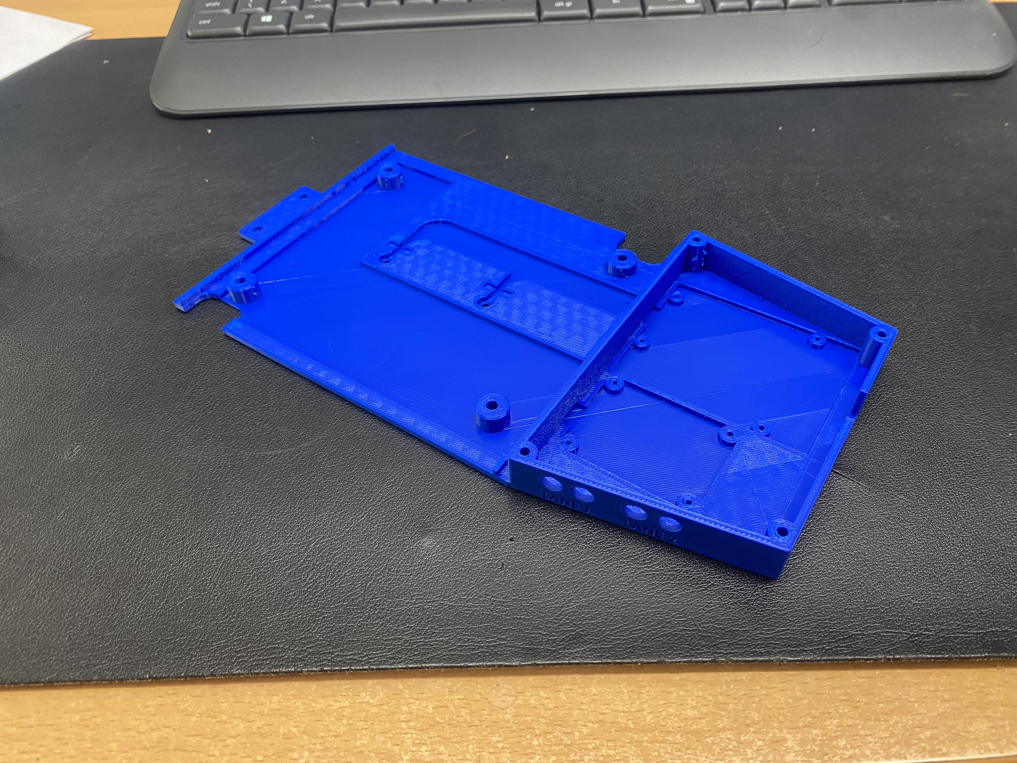

The plan is a base plate glued or screwed to the under side of a half straight , with a box on the side for all the electronics . An overhead gantry will house the IR emitter along with 16 addressable RGB LEDS. I'll be going along the well trodden route on an Arduino Uno for the PC connection along with a relay box to turn power on and off to the circuit. This is largely unnecessary, but i like techy things and the relay boxs aren't expensive. Ill be sticking with the sport controller 3.5mm jack plugs as there small and readily available.
The main parts will be 3d printed for now. But i do run a CNC machine shop so may be from aluminium eventually. Picture below is first model files that are currently on the printer. They will no doubt get a complete re-design as i compact the electric down and hopefully make them a bit more visually appealing

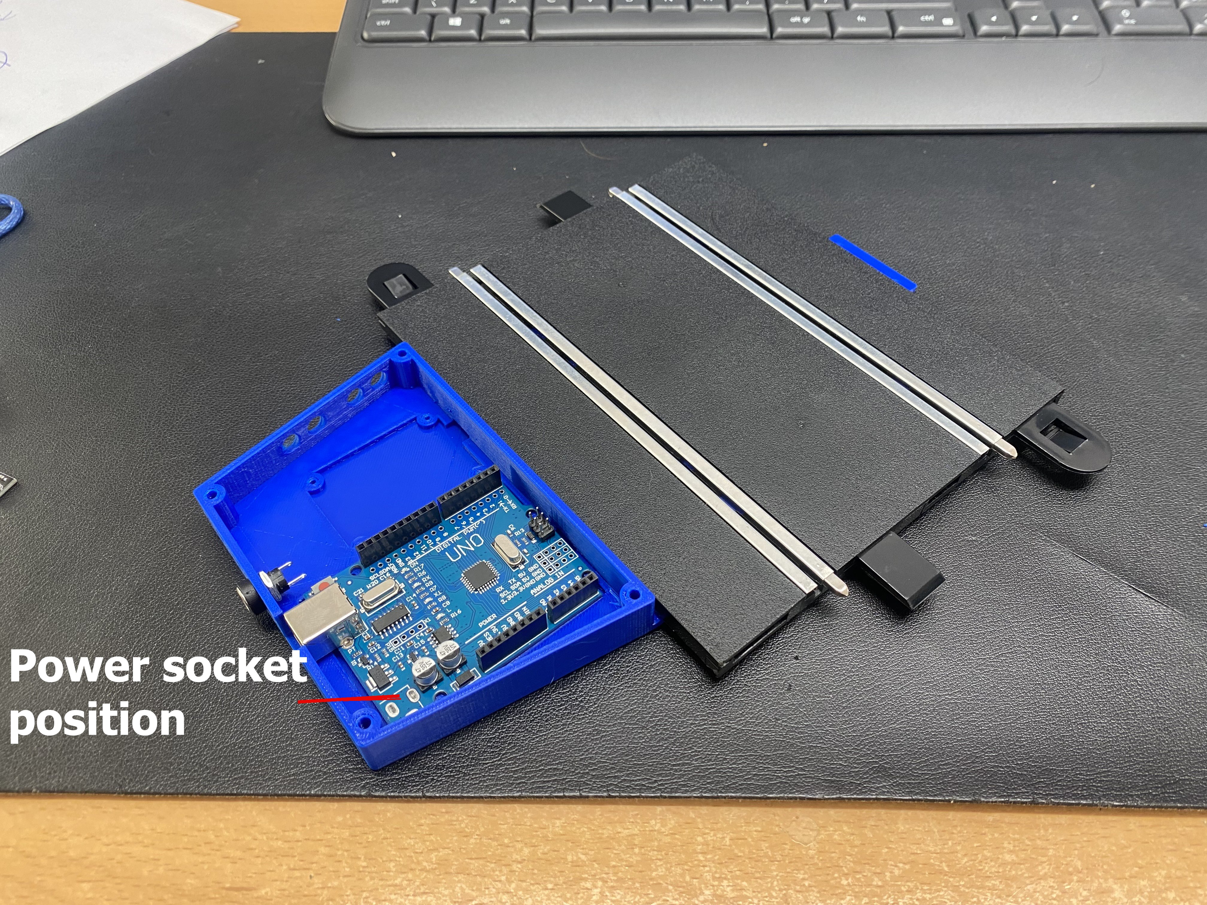

The Arduino will perform perfectly well using the 5 volts provided via the USB cable. An external power supply would only be necessary if you are running lots of LEDS from the Arduino. I have two 5volt relays plus the five start lights running happily.
For the LEDs in the "Light Bridge" I power those from a separate USB socket.
Your Arduino is missing the usual power socket that is provided for using an external power supply.

I was hoping eventually to use a Bluetooth chip for communicating with the UNO so wouldn’t necessary have power from the usb , but I think for now till I’ve got it all working I’m going to park that idea . I removed the 12v plug on a previous project . I built a wind simulator for my sim racing rig . If I decided to use the 12v feed I’ll just solder wires directly to the board and save a little space

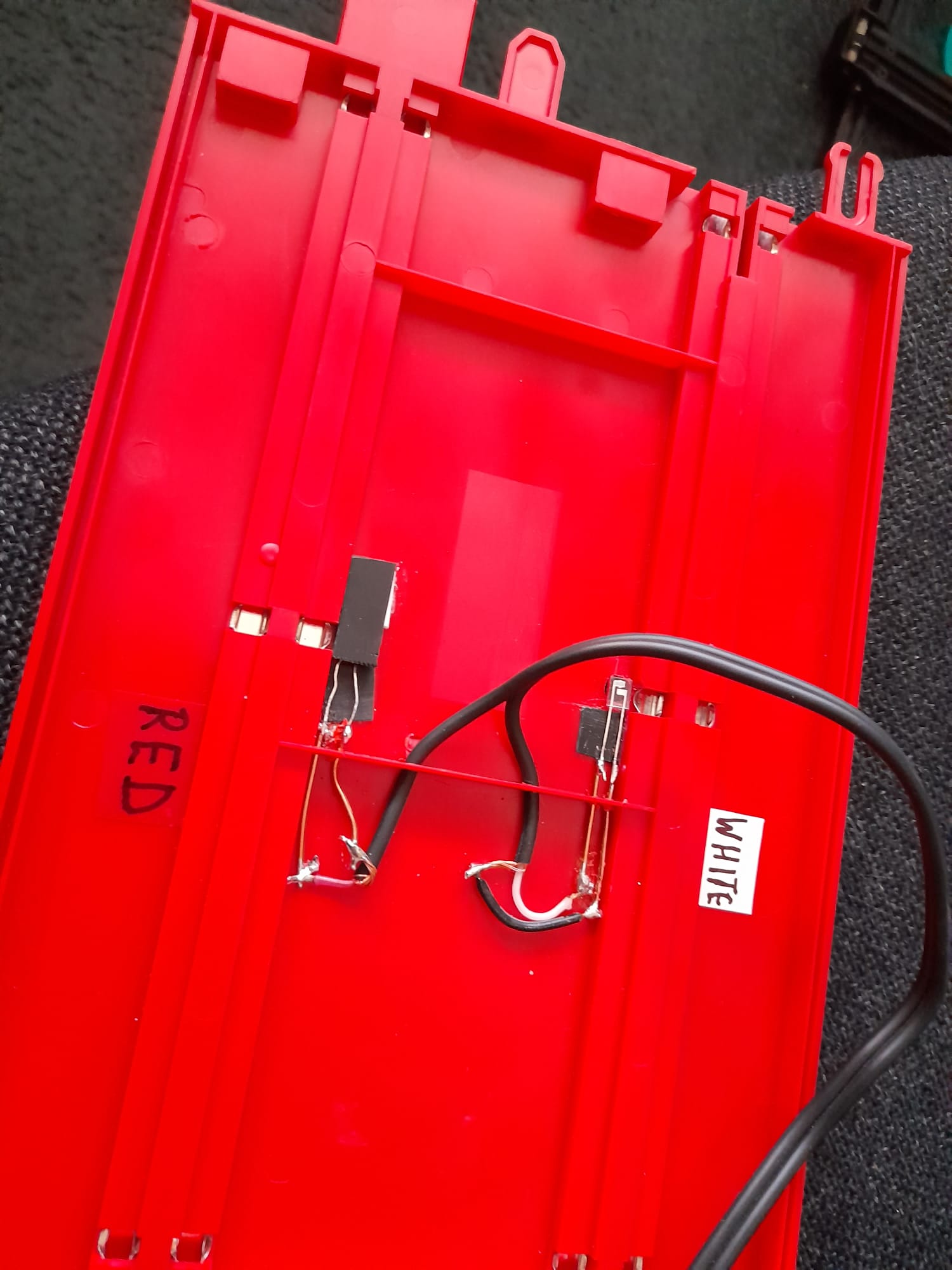

For several years I have used 5mm I-R LED receivers under the track surface with matching emitters overhead. Very recently I spotted sideways-facing LEDs and have been successfully trialling those as they fit nicely under the track surface (Policar). The receivers work well with white LEDs overhead so that will make life a bit easier when using temporary layouts and free-standing light-bridge.
Ebay Linky:
https://www.ebay.co.uk/itm/225484518933
My proof of concept set up in Scalextric START track.
