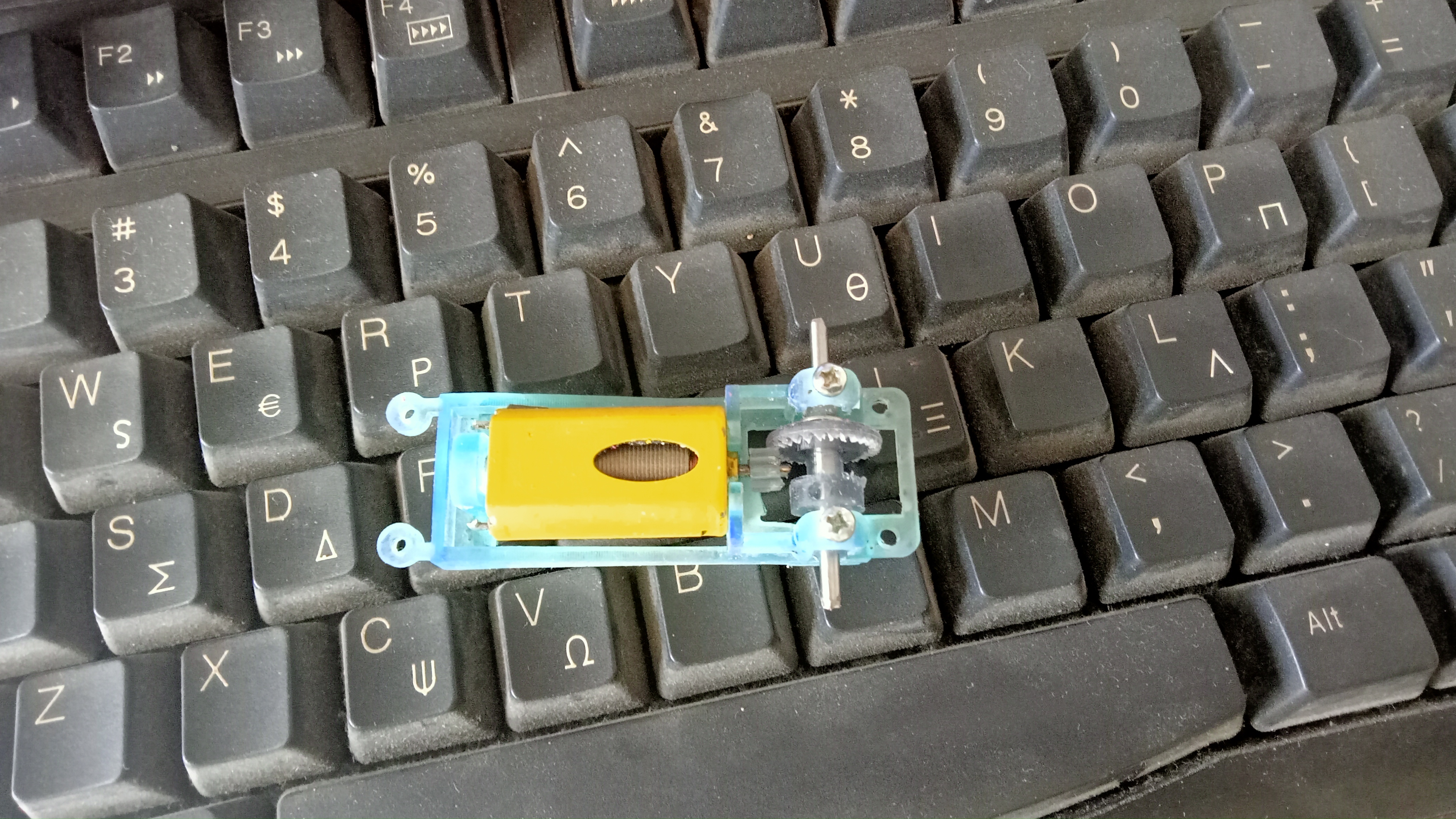

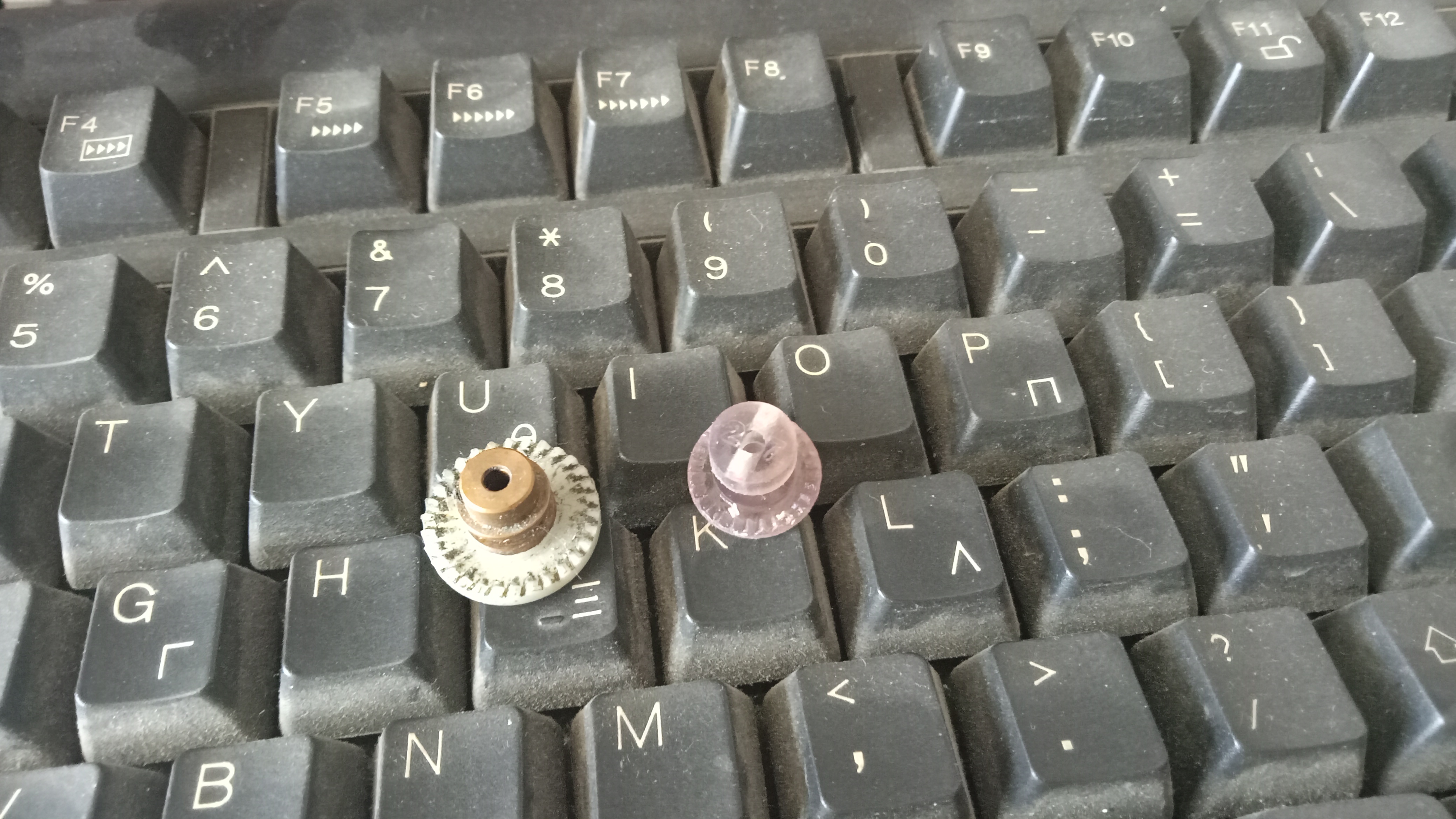

I have been building a car for some time now and the last obstacle was there was not enough room for the rear tyres,i turned them down bu then hit another probl;em,crown was touching down.After some thought i decided to venture a small crown and pinion set and it worked.The crown is 27z 13.7 diameter and the pinion is 9z for 1.5 dia shaft
Comparison to a slot.it crown
I have uploaded them on cults

What resin did you print them with?

(28th-Sep-22, 11:09 PM)GT40Racer Wrote: Nice work
thanks
David
Looks like Siraya Blu...I don't expect it to last long...
thanks
David
Siraya build

I wonder if you can get resin parts hard plated.
