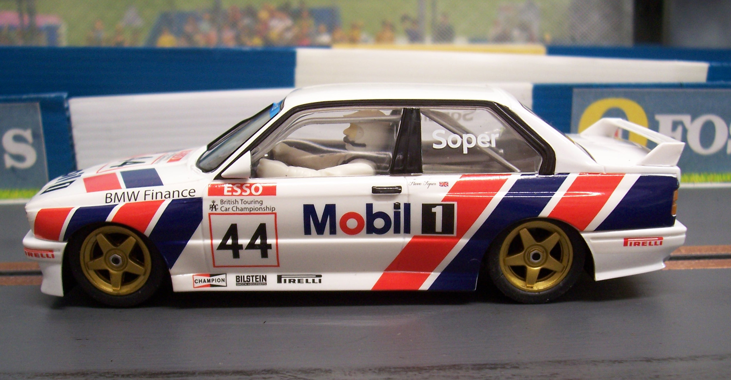

[Image: clearspacer.gif]Scalextric C3782 - BMW M3 E30 BTCC 1991 Donington Steve Soper.

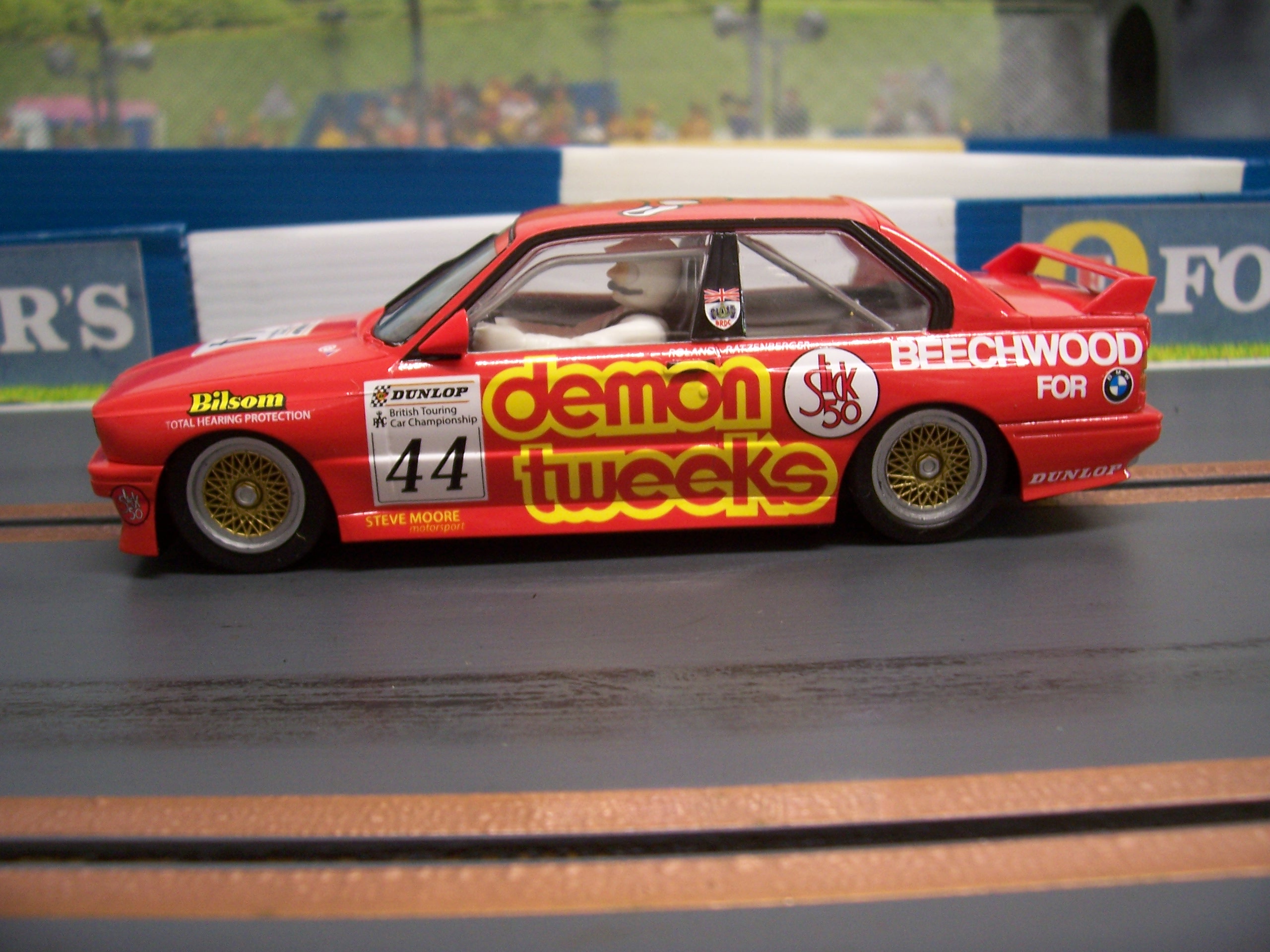

Scalextric C3739 - BMW M3 E30 BTCC 1988 Brands Hatch Roland Ratzenberger.
These M3s have been out for a few years now but various liveries  are still available so a review may be of interest.

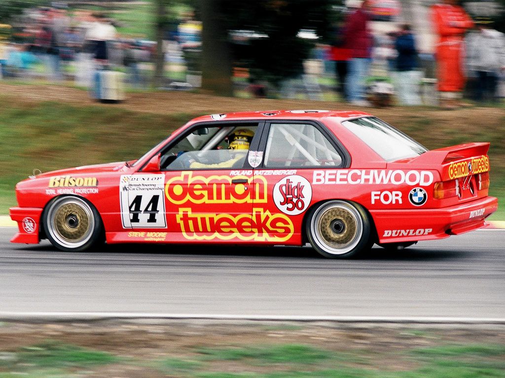

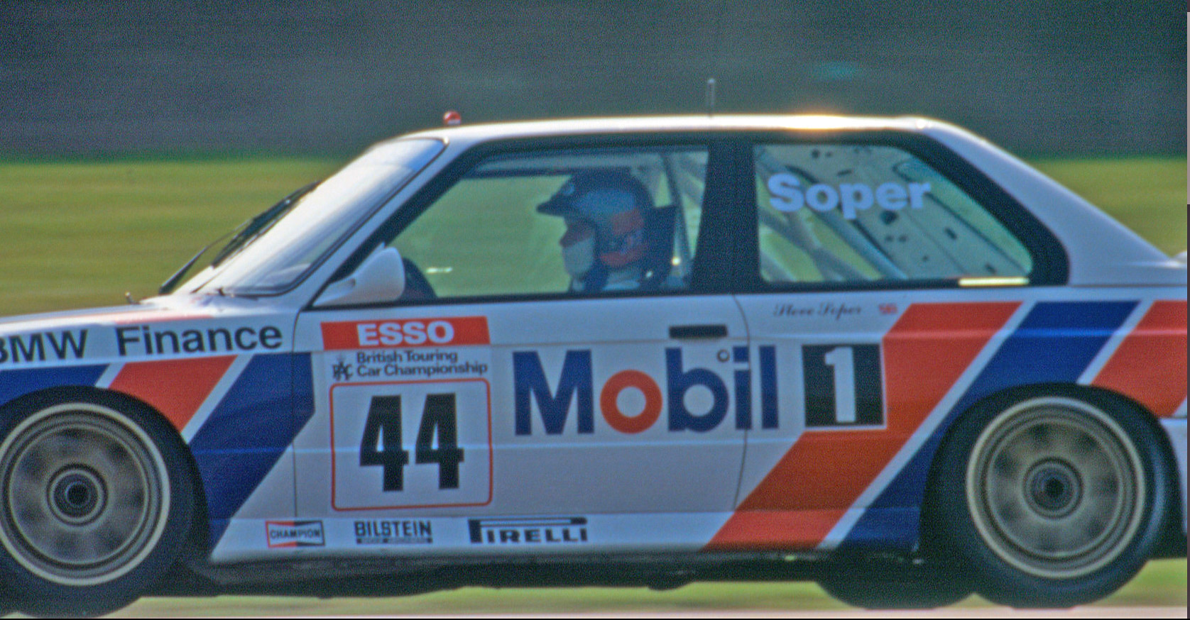

Lovely, lovely bodies! They look right and the tampo printing is just about spot on as you can see with the side by side comparison with the real thing. The BMW Finance and BTCC fonts on the Soper car could both have done with a touch of bold but nothing major to quibble about.
The real Ratzenberger car does look a slightly different shape but I think that is a wide angle lens shot which tends to distort things a bit.
Top marks also for the rear wings, they are made of more bendy plastic than the rest of the body so should be less prone to breakage.
Unfortunately Scalextric blotted their copy book by fitting incorrect drivers' heads. They have lifted one from their rally cars so we have a microphone attached which was never there in real life. Why they keep doing this is beyond me, they have plenty of correct ones they could have used.
A dropped point for that gives us 9 out of 10 for the bodies then.
