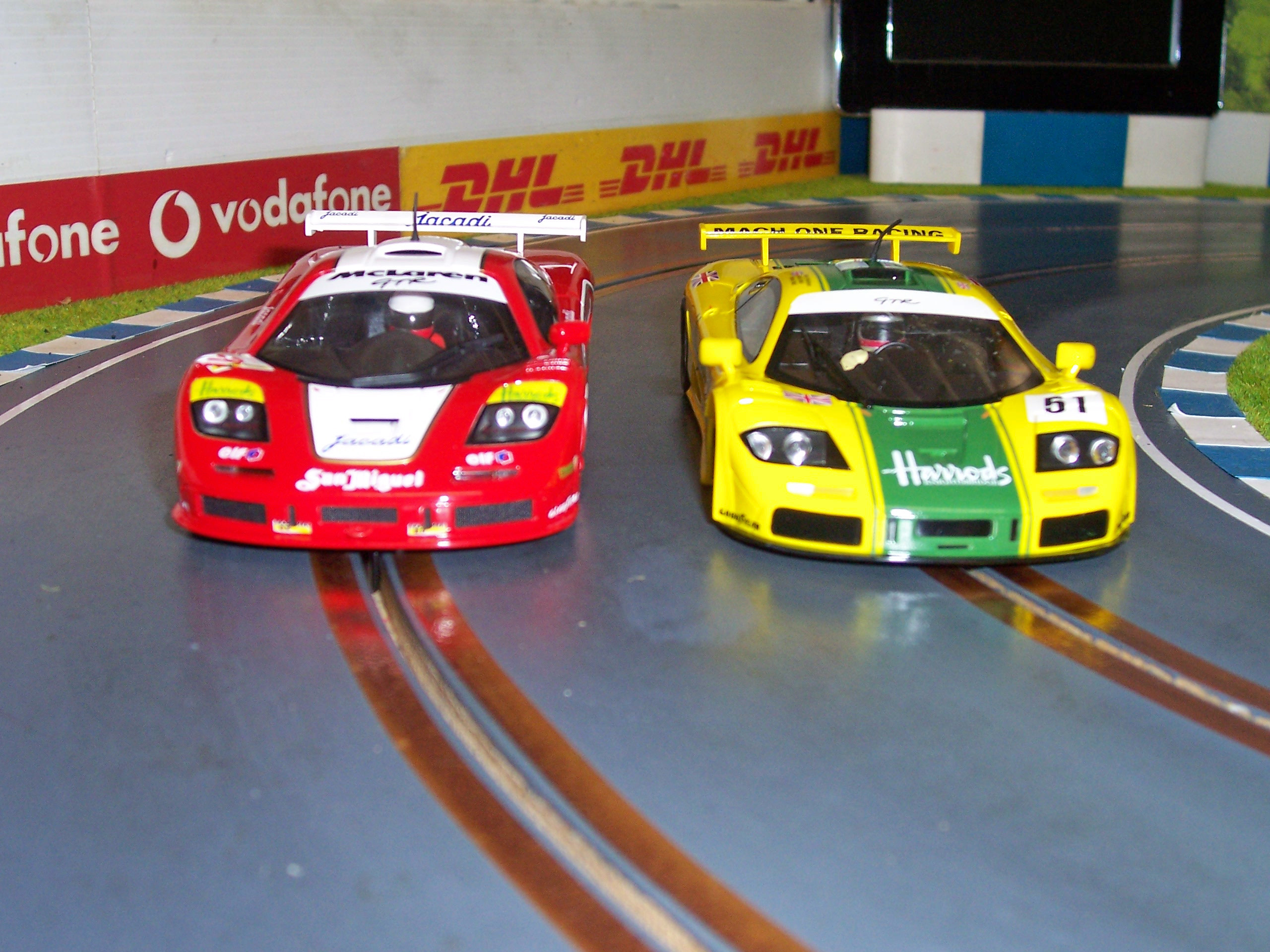

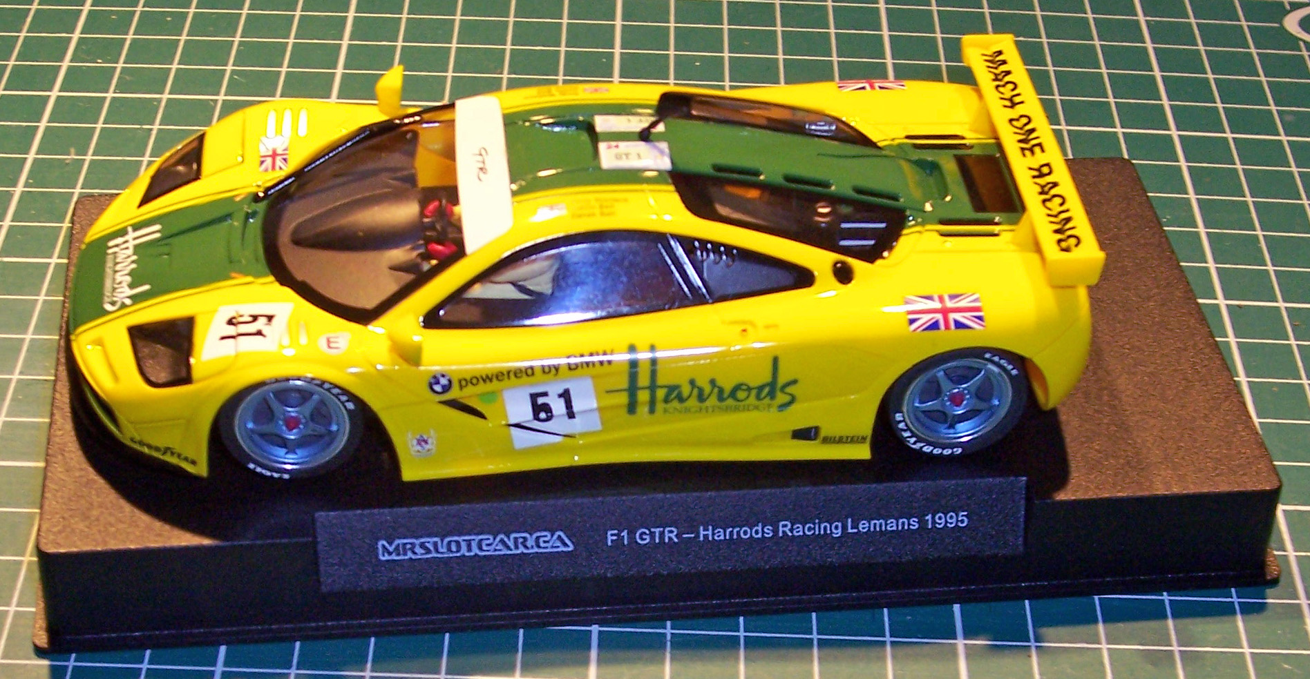

I purchased the Andy Wallace/Derek/Justin Bell, Harrods sponsored one in bright yellow for the simple reason that I have red and yellow lanes on my track and already have the red Revoslot car so potentially a matched pair for racing.

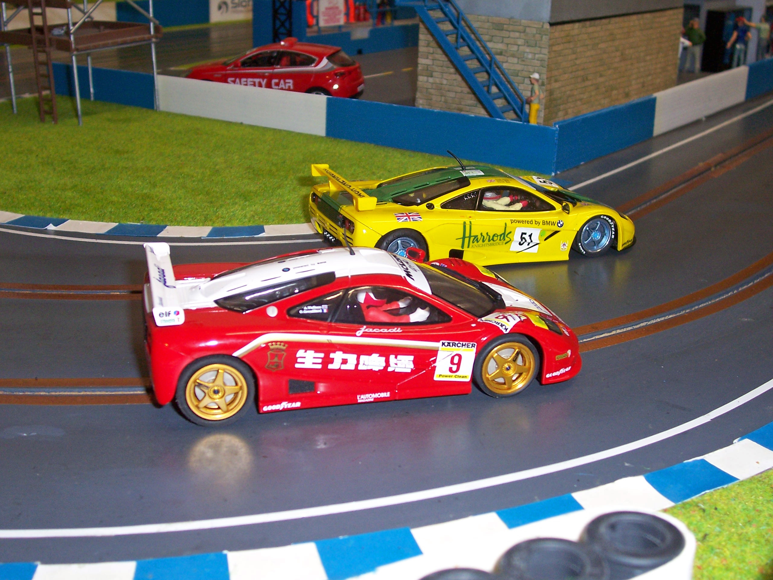

Ultimate lap speed, on the rare occasions I got everything right, was extremely good. Fastest lap on my 50ft track was a fraction over 5 seconds which is not far off Thunderslot times and 3/10ths quicker than the Revoslot but I couldn't do it with any consistency and lap times varied wildly by over a second. The Revoslot would undoubtedly win a race between the two as it is much more predictable.

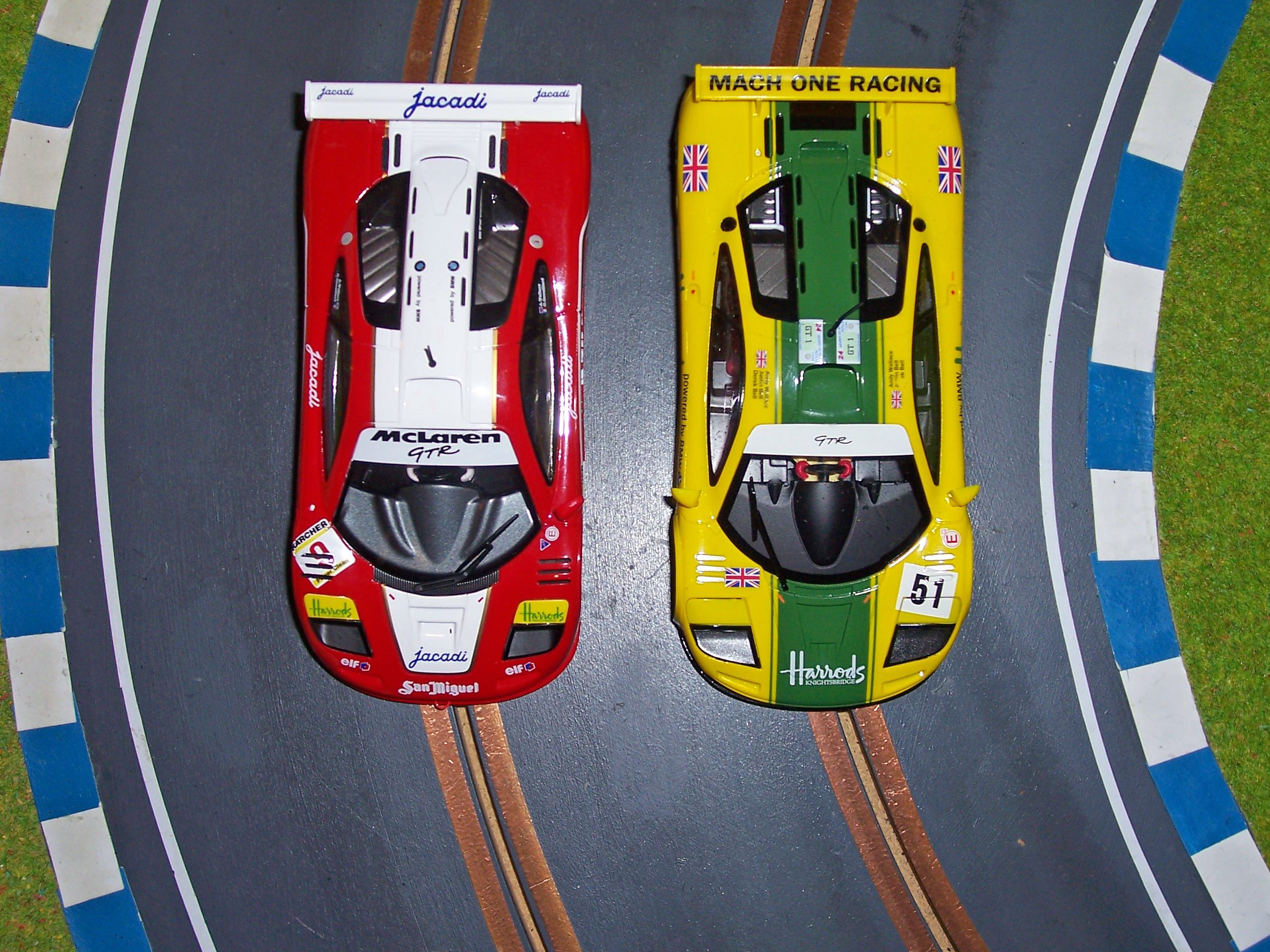

Nowhere near it actually. Of all the different manufacturers it has the widest divergence from true scale being too long and way too wide. Not quite a 'pancake' but veering towards it so, If such things worry you unduly, then this one is probably best avoided. It doesn't look that bad on its own but the Revoslot version is much closer to the real thing so here is a comparison of the two:
