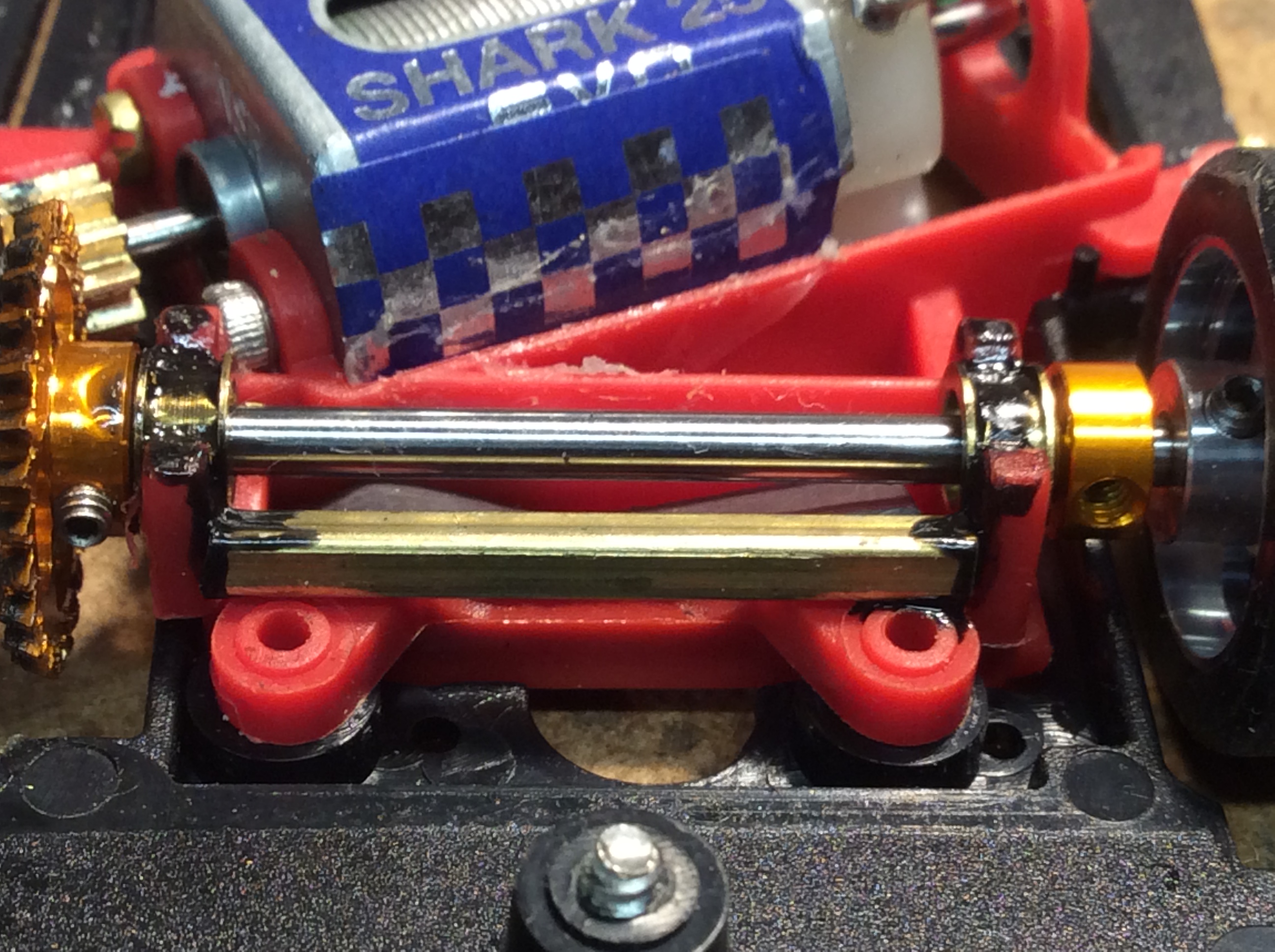

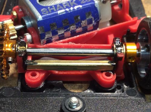

Even the best of my newly acquired GT3 cars have a tendency to “dance” or chatter on acceleration out of corners. chrisguyw has been a big advocate of bracing the axle holder uprights on SW and AW cars, recommending the Slotting Plus combi bushing/brace or aiding a wire U brace. So, the Slotting Plus product is $10 and currently out of stock at my usual supplier. My chances of accurately bending wire so that it fits snug but not so tight it distorts the uprights are nil. So I looked around the workbench and came up with some 3/32” square brass tubing that even I could cut and file to fit. Secured in place with some IC2000 adhesive it works great. The chatter is significantly decreased.
If building a car from parts or for a Proxy, the Slotting Plus setup is worth tracking down. But for a quick, easy and cheap solution I am happy with this.

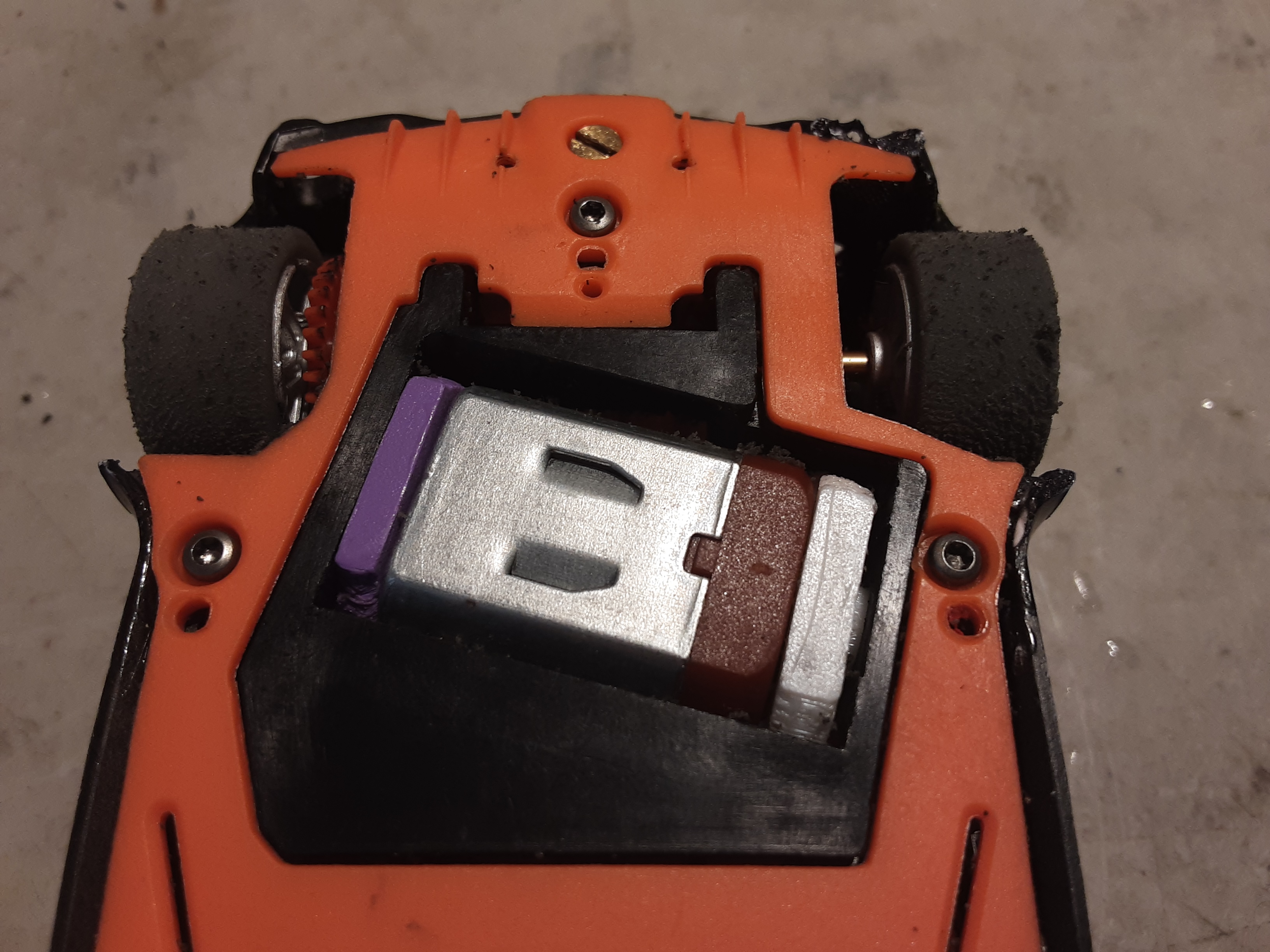

A main source of shuddering is flexibility in the motor to axle alignment.
I see you have put a short can motor into a long can motor mount.
If the motor is only anchored on one end , this is asking for the kind of behaviours you describe.
Shims are available on thingiverse for 3d printing.
The shims will anchor the motor on both ends and also help to centre the weight of the motor in the centreline of the chassis.
A small dab of epoxy at both ends will ensure that the shims stay in place.
Below is a pair of shims anchoring a Slot.IT MX16 S-Can motor into a Black Arrow motor mount

(27th-Oct-21, 03:41 AM)mickey thumbs Wrote: So I looked around the workbench and came up with some 3/32” square brass tubing that even I could cut and file to fit. Secured in place with some IC2000 adhesive it works great. The chatter is significantly decreased.
Maybe next time you can think of a vertical strip instead of square. It gives even more rigidity.
For example: Instead of square 3/32" you can take a 1/32"x1/4" brass strip, which is about 10% lighter and its moment of inertia is more than six times greater;
which means six times stiffer.
Ix=1/12b
h³
Square 3/32" Ix=2.673mm4
Strip 1/32"x1/4" Ix=16.93mm4
Hub
