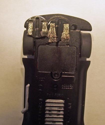

A useful modification for all Scalextric cars with the disc guide is unfolding the braids into an SCX pattern thus lowering the guide. It also increases the contact patch for the braids.
Standard on left, unfolded on right.

Thanks for the reply's, I should have thought of the SCX style braid as I have a couple of SCX cars.
I have just fitted new braids to a couple of the Cadillac Le Mans cars in the SCX style and the braid slightly compressed length ways and the cars are running pretty nicely.
