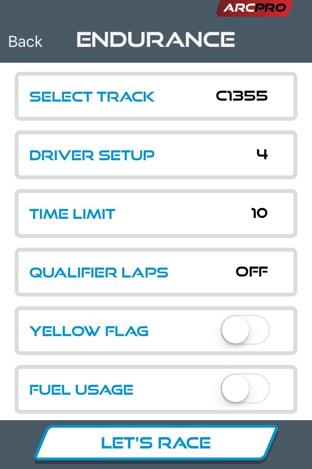

1. Qualifying Session

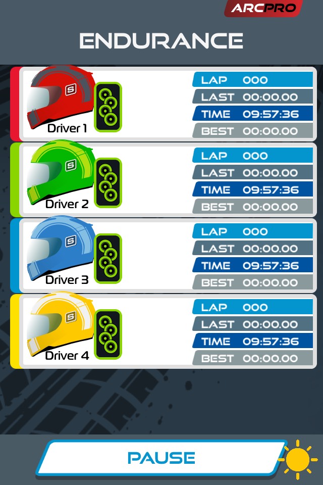

This is the first competitive action of a BTCC weekend. I set up the session as an 'Endurance' race from the Race Mode screen. This gives me more control over the settings and - importantly - allows a timed session, rather than a set amount of laps as is offered in the 'Practice' mode or the 'Qualifier Laps' in the 'Grand Prix' mode. I also use Endurance mode for practice and qualifying sessions as the race stops when the time runs out - all the cars do not need to be on track to trigger the race end as they do in a lap race or in practice mode.
The race is set up for ten minutes - plenty of time to get cars running nicely and to set a fastest lap that will determine grid positions for Race One. Of course, any work on the car must be done via a trip to the pit lane - there is no stopping out on track, which causes a unnecessary hazard for other cars. Although there will be none of the simulations - Fuel Use, Tyre Wear, KERS, Incidents or Weather - in the BTCC races, I do sometimes add the Tyre Wear simulation to qualifying. That means cars must pit every ten laps or so. There is no extra grip from new tyres, but it means that there will be times when fewer cars are on track, which might allow an opportunity for a clear run and a quick lap...

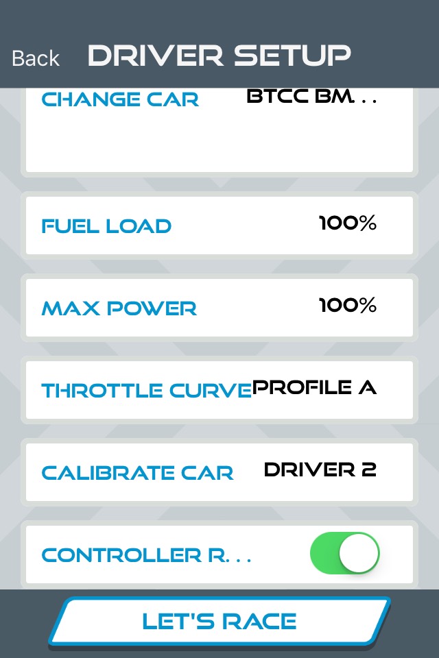

Clicking 'Driver Setup' I go to the 'Choose Driver' screen where I can add or remove drivers (minimum 2, maximum 6) depending how many racers are qualifying. If there are more than six drivers, it would be necessary to divide them into groups - ideally of equal size - and run separate sessions. As you can see, I have chosen to run the colours in default order (Red, Green, Blue etc) and chosen to have corresponding coloured helmets as the driver icons. Clicking on the Green driver (Driver 2) takes me to 'Driver Setup' where I can change the driver name, image, car name and set specific values for the driver - fuel load, max power and throttle curve - and also gives me an option to calibrate the low speed for the car (see pages 16 & 17 of the ARC Pro Quick Start Guide) and toggle the controller rumble on or off. I cannot imagine any reason to turn the rumble off - it means you can concentrate on racing and only look at the screen when prompted by a rumble. I have left all the settings on their default values for now.
The 'Back' button moves you back to the previous menu, or - when all the settings for all the drivers are done - you can tap 'Let's Race' at the bottom to bring up the race screen, then tap 'Start Race' which brings up the start lights...

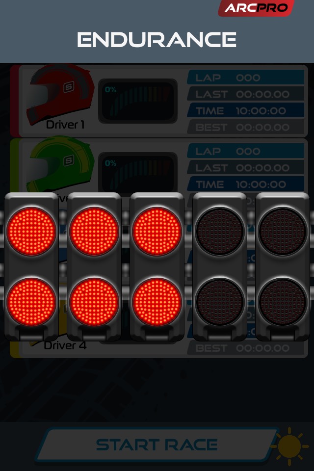

The Endurance race screen shows all the drivers, plus number of laps, last lap time, time remaining and best lap time. For our BTCC qualifying session, the best time is all we are worried about. The graphic to the right of the helmets indicates tyre use - I sneakily added that simulation to this session. As you can see in the ARC Pro Quick Start Guide (p.18 & 19), the graphic starts green, gradually going down by a set amount each lap, until it goes orange, then red, then the 'PIT' icon comes up and the controller rumbles. At this point you must pit your car in the pit lane - see page 13 of the Quick Start Guide - press and hold the lower brake button on the ARC controller (with the 'X') until the graphic is back to green and the 'GO' icon comes up. If you pit too late, the red graphic will flash and your speed will be limited to your car's low-speed calibration until you pit and change tyres. Practicing with this one feature is the basis for understanding all the other simulations in ARC Pro and executing a perfect pit stop and playing with pit stop strategy.
I won't talk you through the race - that's all part of learning and having fun. At the end of the ten minutes, click on 'More Stats' to study all the results in detail - and to save and share them, if you want, via the 'Options' button. Don't forget to write down the fast time for each racer!

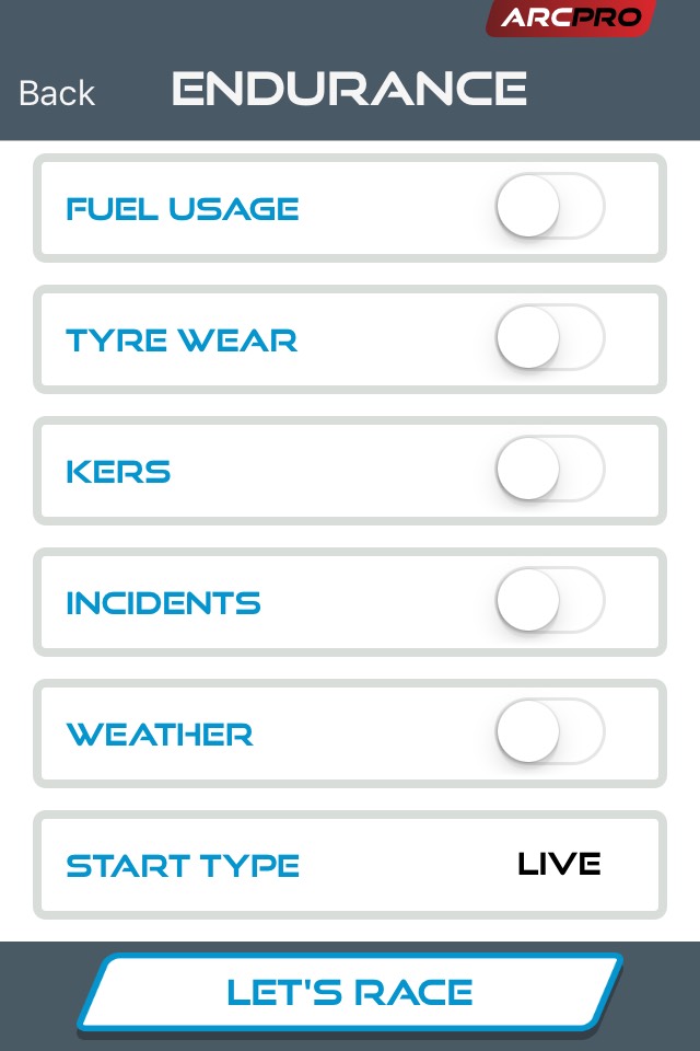

The grid for Race One is set by the fastest laps achieved in the qualifying session and the pole-sitter gets a bonus point for the championship. With six cars or less, the race is a straightforward sprint over a set number of laps using only the 'Jump Start Penalty' and 'Yellow Flag' features of the ARC app. If we had more than six cars, then the top three or four qualifiers automatically start in the feature race - with the others taking part in a 'B final' to fill the final places in the main race. Like the BTCC races, the action should be fast & furious - I've chosen 'Grand Prix' from the Race Mode menu and then tapped on 'Number of Laps' and chosen 20.

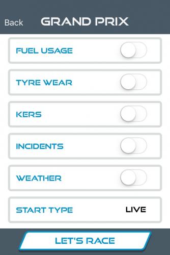

I've also tapped on Jump Start Penalty and chosen the 4 second option - that will add 4 seconds to a car's race time if it jumps the start. I toggled-on the Yellow Flag feature so the toggle switch is to the right and the background shows up green - that indicates a feature is active. All the other features are off - their toggle switches are to the left and the backgrounds greyed-out. Tapping 'Driver Setup' shows that we still have the same drivers as in the Endurance race for the qualifying session. The cars are the same and the settings - Fuel Load, Max Power, Throttle Curve, Calibration and Controller Rumble - are unchanged.
Starting the race is the same as before and the race display is similar - laps completed / total laps, last lap time, race time elapsed and best lap time. There is no need for pit stops in the BTCC race, but if there is a big pile up that blocks the track, there is the option of a yellow flag. The Yellow Flag feature is activated by tapping the race screen during the race - a waving yellow flag appears in the centre of the screen. The cars are then limited to their calibrated low speed until the screen is tapped again - the race continues, but at a safe speed, during which the crashed cars are re-slotted. I don't always use the yellow flag, but it feels quite authentic in the cut-and-thrust of a BTCC race.

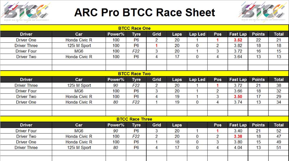

Don't forget to record the results on paper or in a spreadsheet and also give a bonus championship point to the driver with the fastest lap. The standard BTCC points system is: 20-17-15-13-11-10-9-8-7-6-5-4-3-2-1. In the More Stats pages, you can also tell from the graph who has lead a lap - and each of those drivers gets one bonus point for leading a lap during the race. If a 'B final' is run, race points (7th position - that's 9 points - onwards) are awarded to those not 'stepping-up', but the bonus points for fastest lap and leading a lap are only awarded for the feature race.
3. Race Two
The starting grid for the second race is the finishing order of the first - the Race One winner starting on pole (no bonus point this time).  Race Two is also where 'Success Ballast' comes in. This slows down the top drivers from Race One. After the first race weekend of the championship, the championship leaders carry 'Championship Success Ballast' into qualifying and Race One of subsequent weekends. It's a crucial feature of the BTCC, so it is important we simulate it in our ARC Pro version. We do this by using the 'Max Power' feature - which can also be used to slow down novice drivers, handicap better drivers or simulate differently performing cars (eg a 1960s saloon car vs a 2019 Formula One car) in other formats.

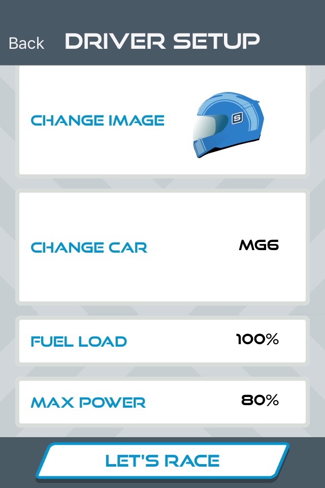

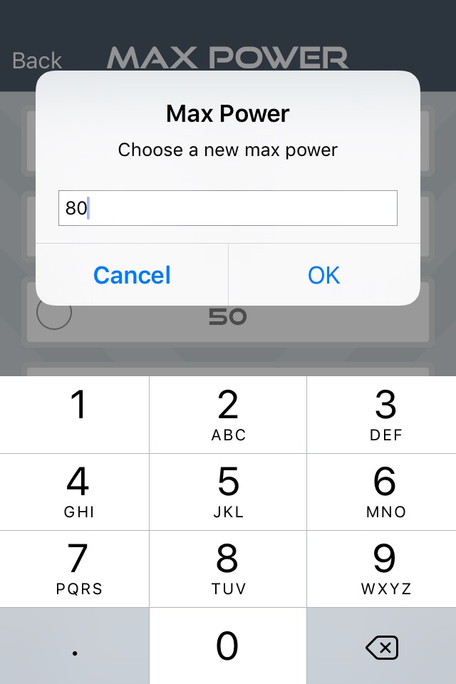

In the Grand Prix race, we need to go to Driver Set-up, tap on the driver and scroll down past Fuel Load to Max Power. Tapping on Max Power gives us options of 100, 75, 50, 25 and Custom - all percentages. The Custom setting means any value from 1 to 100% can be keyed-in. Testing on a small-ish home track, I know that reducing the Max Power setting has a different impact depending on whether the cars are running with traction magnets or with them removed. I started with using a Custom setting of 80% for the Race One winner and 90% for the runner-up. I found at 90% that lap times dropped by 10% for non-mag cars and hardly at all for those with magnets. At 80% lap times dropped by around 15% for non-mag cars and by 20% for magnet cars!
For cars running without magnets, the 80% and 90% reduction works quite well in a four-car field. On larger grids, I might use 80% for the winner, 85% for second, 90% for third and 95% for fourth. With the standard magnets cars, I now run 80% for the winner and 85% for the runner-up in a four-car field. Of course, the result usually comes down to whoever drives the best, but the ballast can make a difference to the result. If you want success ballast to have a bigger impact on the result, simply reduce the Max Power even more. Be careful with standard cars with magnets - there will be a point when they are full-throttle all the way round and you might strain the motor (it will get hot).
Using success ballast via the Max Power setting means carefully recording the settings and remembering to change them for the next race. Having a race sheet on paper or in a spreadsheet makes this much easier.

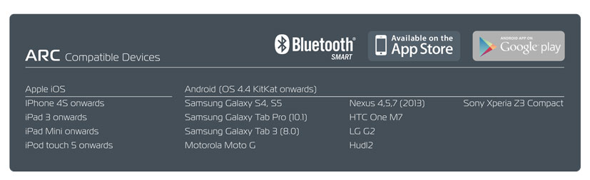

When the ARC app was first developed back in 2013-14, the basic compatibility requirement was for a smart device to have Bluetooth version 4.0 BLE (Bluetooth Low Energy) to allow the ARC app on the smart device to ‘talk’ to the powerbase. The right sort of Bluetooth required Android phones and tablets to have Android OS 4.4.2 (KitKat) or above; and for iPhones and iPads to have iOS 5.0 or above.
However, it has not proved to be that simple. What became clear was that some Android devices failed to connect to the ARC Pro powerbase and many more did not connect well enough to run the app or could not maintain a reliable connection. Those who know about these things explain that different manufacturers of Android devices use a variety of hardware and software configurations to drive the Bluetooth BLE. That’s too much variety for an app like ARC to handle.
As a result, the ARC compatibility list contains all the Apple devices that run Bluetooth v4.0, but only twelve Android devices of the hundreds available. Of course, the list is not exhaustive. Some users have found other Android devices that the ARC app works on. These are discussed on the ARC app compatibility thread on the Scalextric website discussion forum: https://www.scalextric.com/uk-en/forum/a...atibility/
Another worrying finding is that that newer models of those Android devices on the original list are not always found to be compatible. It seems that what ARC is trying to do just isn’t good for all Android devices. Other apps controlling electronic systems have suffered similar compatibility issues. What is incredibly frustrating is that most people probably have an Android phone, but not all are able to use it with ARC.
However, there is one piece of good news. The 2016 and 2017 versions of the Amazon Fire tablets have been found to work well with ARC and the app has been added to the Amazon Appstore, including the latest version in April 2018. Even better news is that the Fire Tablets are very good value for money. However, the very latest (2018) Fire 8HD tablet does have problems with the latest app, but works with the Legacy app. The development team know about this and are hopefully working on a fix.
