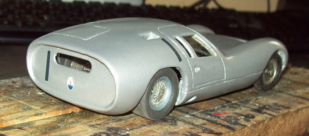

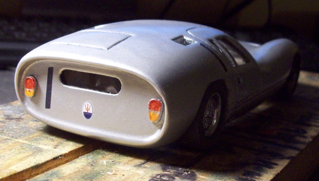

Did manage to get some glazing on the Maserati although I'm not very happy with it. I thought that the plasticard would be thin enough but the glazing looks too inset. What with that and the fact that the shut lines are a bit wooly rather tempts me to consign the car to the 'finish off at some stage in the future' box. However, there is a Pittman 196B coming so I'll probably get it running at least. Have an MRRC steering unit for it too although it doesn't have wires.

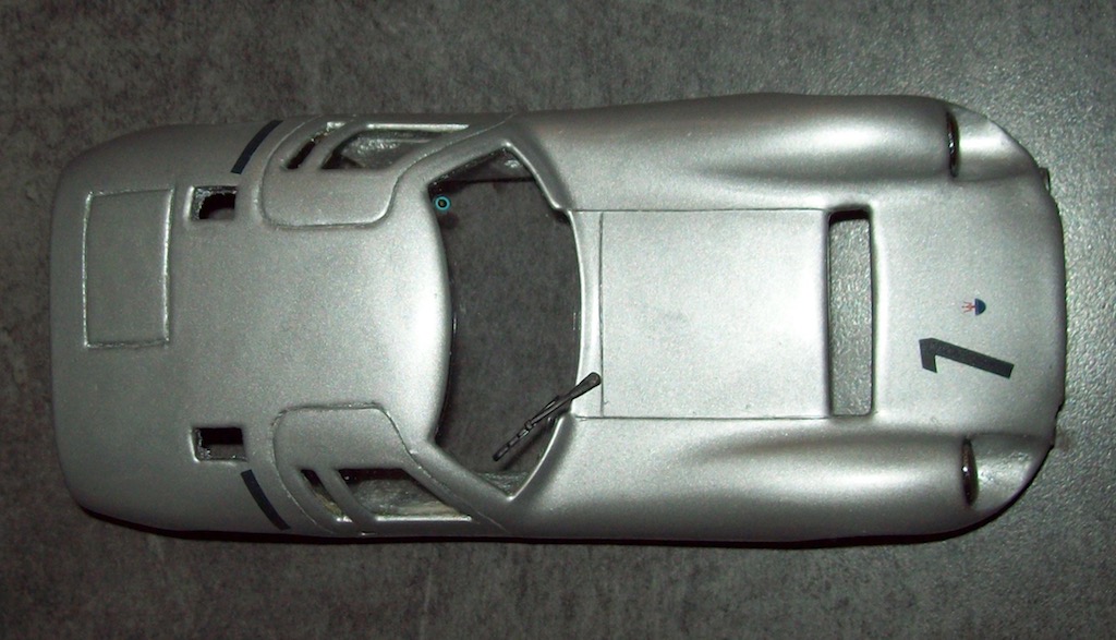

Almost there now. It's clear that I need to change my technique with the shut lines. Cutting them direct into balsa leaves them too fuzzy, even with a new scalpel blade. I need to be brave and do them AFTER the surface is filled, maybe just before the final coat of paint. The bonnet ones here are easy as they are straight but much neater than the others.
