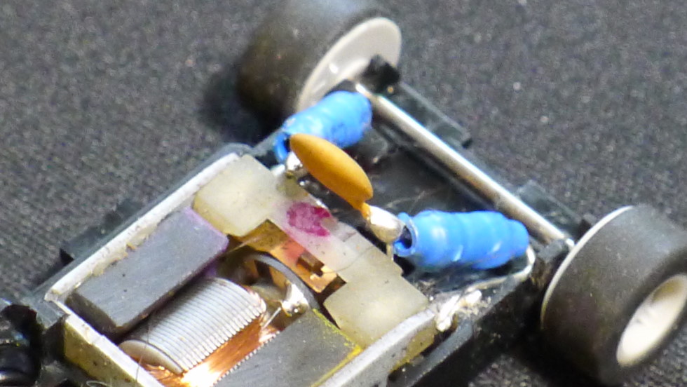

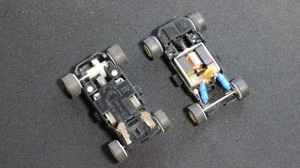

Here are two of the filthiest Micro Scalextric chassis I could find (I was after the bodies, no doubt)...
It shows the layout, the very nice and smooth gearing (older versions have black gears, newer ones are a white translucent shade), the resistors (blue, red or black coloured) and ceramic capacitor attached to the front of the motor. The armature windings have been red, gold or green. Here's a close-up of the all important 'fly-wheel' between the stacks and the commutator - something that identifies the slightly under-powered Micro can motor...
Not a lot you can do to the car, apart from clean it, get it running smoothly and fit it with some silicone Supertires (from SlotCarsDirect in the UK: https://www.slotcarsdirect.com/shop#!/si...ual/page/2) and probably some new braids. There are some Micro braid-tweaking tips here: http://www.whoracing.org.uk/microtuning.html

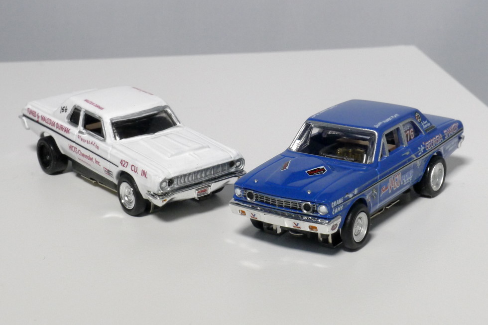

T-Jet NTRA Super Stock - based very closely on NTRA Pancake Super Stock rules
  • Chassis: Any Thunderjet 500 chassis – including Aurora, Dash, Johnny Lightning, Auto World, Model Motoring etc. Auto World Thunderjet 500 Ultra-G chassis is permitted. No chassis modifications. Top (gear) plate and chassis must match.
  • Motor: Minimum 14.0 ohm armature (eg Auto World, Johnny Lightning, Dash 3-Lam). Blueprinting allowed to include balancing and commutator polishing. No de-winding or timing adjustments allowed.
  • Motor Magnets: Ceramic grade only. Auto World, Johnny Lightning, Dash and OS3 (red, blue and white) are allowed in any chassis.
  • Traction magnets: Permitted. Two maximum.
  • Electrical: Original or direct replacement pick-ups, springs, plates, rivets and brushes. Braids and shunts allowed.
  • Braids: Must be soldered to pick-up shoes. Any braids – steel, copper or plated.
  • Axles, wheels & gears: Any axles, wheels and crown gears. Original top plate gears only.
  • Tyres: Any single compound tyre. Maximum diameter on wheel is 0.490” or 12.45mm.
  • Body: Pre-1979 closed wheel sedan or muscle car body. Injection moulded plastic or cast resin only. No lexan bodies. Drag or street racing liveries. Re-paints and hood scoops are most welcome.
  • Maximum width: 30mm or 1.181”.
  • Weight: Minimum weight of entire car 21g. Ballast may be added to body only.
  • Wheelie bars: permitted.
I do love these 60s and early 70s cars. Auto World have produced two sets of authentic 1960s NHRA Super Stock cars and there are bodies and decals available to create many more. Below is the blue Auto World 'Georgia Shaker' Ford Thunderbolt and a Dodge body that I tried to convert into Malcolm Durham's 'Strip Blazer' Chevy...

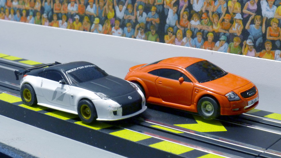

A couple of street stocks on their way to me.
I was going to turn one into a super stock, but now Gareth has got me worried there might be more to this exercise that I first thought...

I can definitely spare a couple of Need for Speed Nissans for repaints. I also have some surplus Ford Focus rally bodies which might look really handsome with a flashy repaint. During my rummaging, I came across an American cop car with a flashing blue light, but I’m keeping that.
I think my Street Stock will be the Audi TT. Maybe a Focus or a 350Z for Super Stock. I have too many T-Jet options... and more 60s Super Stock decals on their way from the States.
