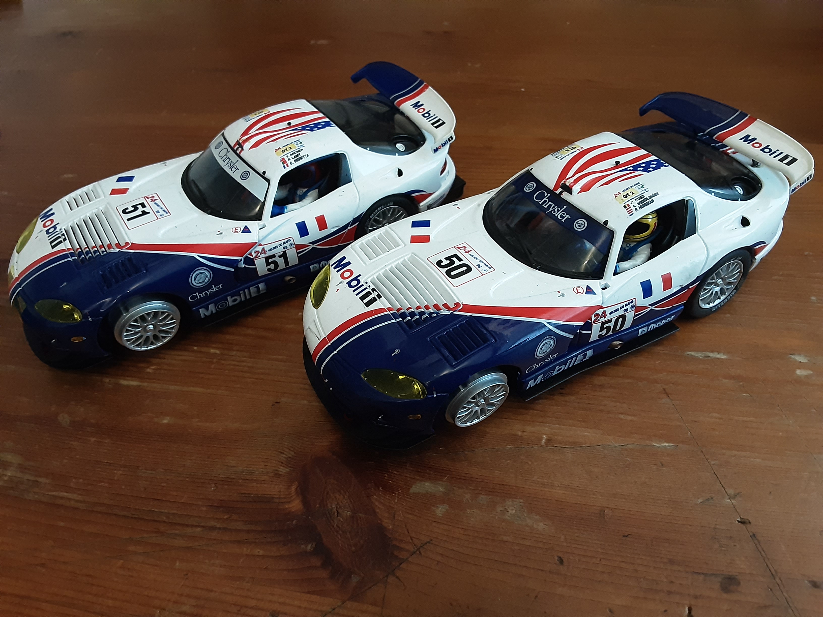

So I have seen a slot car that would fit nicely into a race series at the local club which uses standard Scalextric motors and track...but the car has the motor at the front end of the chassis.
1. Has anyone, ever, managed to build and tune a front motored slot car into a competitive machine using the original chassis configuration?
2. Does anyone have any clever tips for installing a digital IR LED somewhere at the front amongst all the guide and motor kit?
Be honest with me, I haven't bought it yet... But I am up for a challenge (with all you help!)

I have only ever owned 2 front motor cars, A pair of fly vipers.  Banghead
Not quick, don't handle well. Even with the factory magnets installed.
Without the mags, they don't work at all.
Convert to digital? Not a chance!   No space at all for the emitter LED because the motor is right up against the guide.
Bronze bushes for the axles but a plastic brush for the prop shaft..  not good.
Having dug these out of a box in the shed, I'm looking at them and considering if there is anything that  could be done to make them competitive.
Probably  not (in  any classes at any clubs I go to)

We race without magnets.
So it must be about weight distribution, and what having a heavy lump at the front does to handling? But doesn't it mean the guide stays well planted as the rear wheels fight for any sort of grip?
Let's go...OFF ROAD!
(28th-Apr-20, 01:22 PM)BourneAgainRacer Wrote:  ..weight distribution, and what having a heavy lump at the front does to handling? But doesn't it mean the guide stays well planted as the rear wheels fight for any sort of grip?
Yep, that would be my guess too.
The driving wheels really should really have the majority of weight over them.
