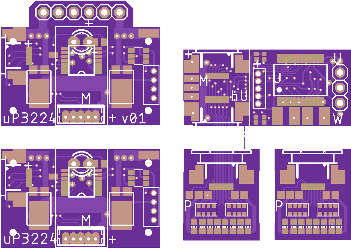

Here is the set of recently designed PCBs for the sensored brushless slotcar project. They should arrive in 7-10 days.
The photo shows in order clockwise from bottom left:
1/ The DPR sized SSD microcontroller core which includes IR LED, front/rear lighting socket, windscreen display interface socket, and the 5-pin socket that connects to the motor. The microcontroller is coded in C++.
2/ This is the same DPR sized SSD microcontroller core as above but with a six way IDE header for direct mounting onto my NSR test cars which have a matching socket.
3/ This PCB is the experimental sensored brushless motor DRIVER MODULE. It is a complete evaluation board with some extra interface ports for system optimisation. The five-pin socket towards the centre of the board is for the three Hall sensors. This is a motor piggy-back design. The final design will be significantly smaller once those extra interface ports are no longer required and can be removed. The design point has already been tested using a manufacturers full size evaluation board - so next steps should progress swiftly (hopefully!).
4&5/ These are the optional LED displays - purely a diagnostic tool for use during system development.
These components represent a fun brushless motor ‘sand pit’.
Thanks for reading.

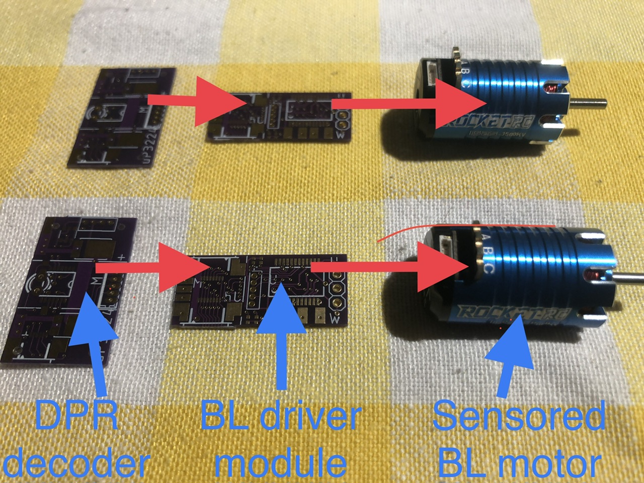

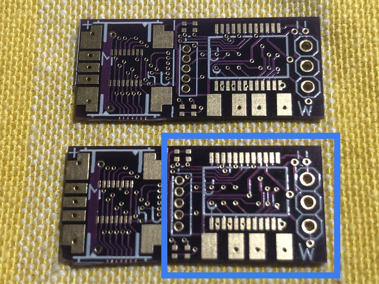

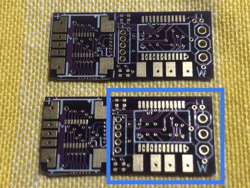

First photo shows the SENSORED brushless driver module. It’s a development board at this stage. The blue box shows the core of the driver board with the additional circuitry to the left providing a diagnostic interface capability. These boards check out correctly and shortly will be populated with components and fitted into digital slot test cars.
The second photo shows the drive components which are required for a GT3 install… a DPR-sized decoder, the driver module and the brushless motor - in this case a 3500Kv variant. The red arrows show the signal path from decoder to motor.
Next, some assembly required ;)
c
