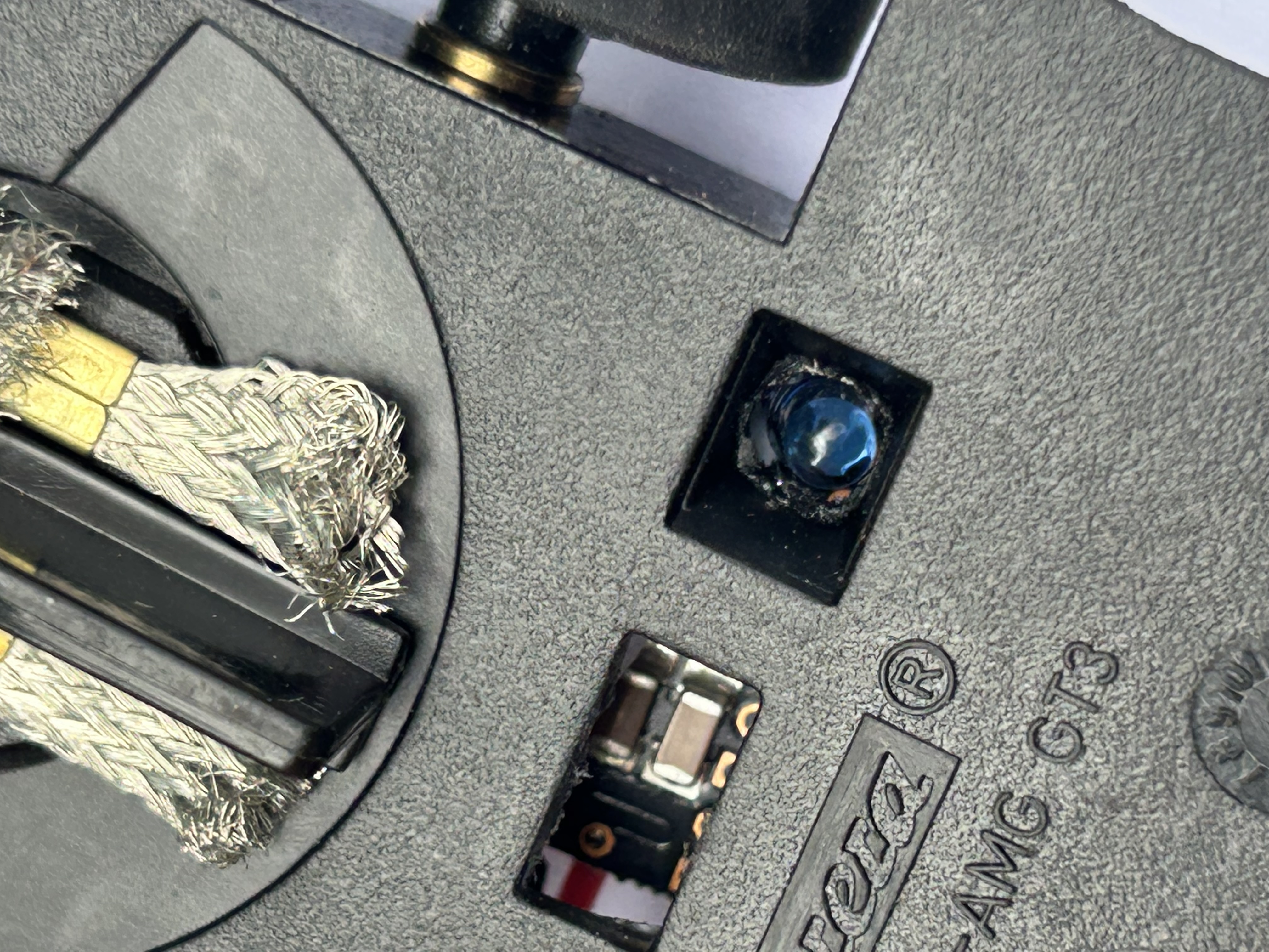

Thought I’d show off the MPD install into a Carrera 132 car.
This one has added features, exhaust flame simulator LEDs at rear, an OLED windscreen display and a super capacitor just right of motor to keep lights from flickering or going out, even if deslotted.
App connect, wirelessly upgradable, 256 step throttle and brake mapping.
If you look carefully you can see the LED line up perfectly with the hole specifically placed in the chassis by Carrera. Braid and headlight wires symmetrical.
Available early 2026.
