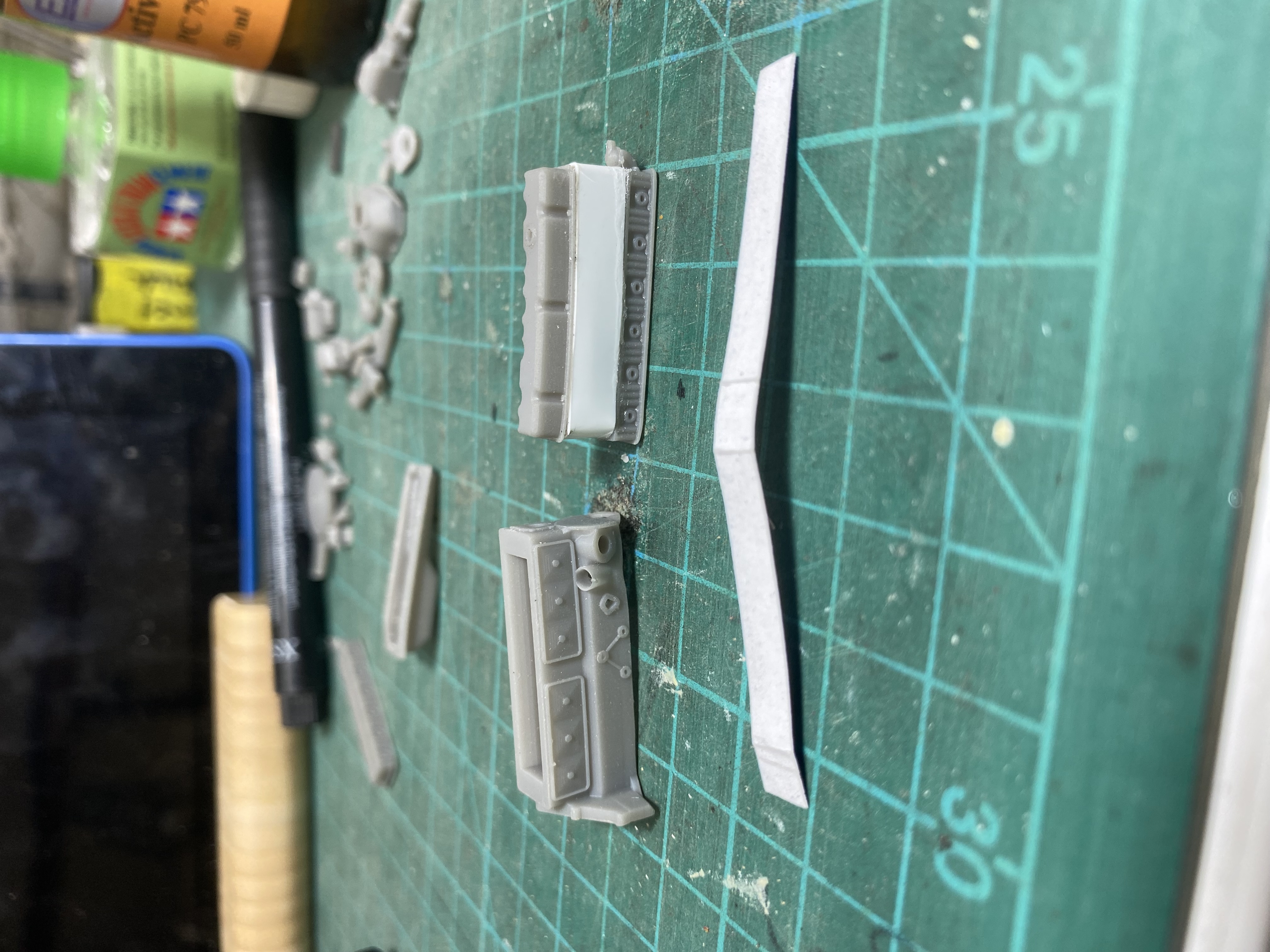

The motor, I found a stl file on thingyverse and had my friend Paul print it for me plus a gear box.
The motor has be customised with something done to the top section above the head.
I made a template from paper and then used styrene(I think that's what you call it).
A bit of filler and sanded to shape.

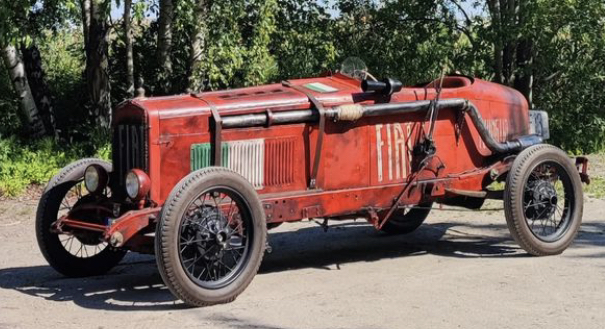

To answer Anthony B's question and reply to yours, I used the size of the Georges Fiat to get my chassis made up.
The Fiat of Georges is similar shape to Flying Fiona.
When I get to the body work I'm going to either chop parts of the body off, and make my own panels, ie firewall, sides, bonnet so I can hinge it to open.
I might use the radiator and the section where the dash is but it will need a lot of modification.
I'm planning on making a frame like the actual car that the panels sit over.
I'm trying to think ahead how each section will marry up, I sort of figure it out as I approach each section.
The rear section I think might be balsa as that's the only way I can get that shape.
