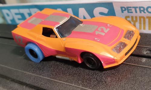

Chassis #1
XTraction 5.5 Ohm
No time for a re-paint this time
Of course on HORNET SILICONE TIRES!
Nico
[+] 2 members Like nkarres's post
Weapon of choice for the Stock 4gear class
Nico
[+] 4 members Like nkarres's post
