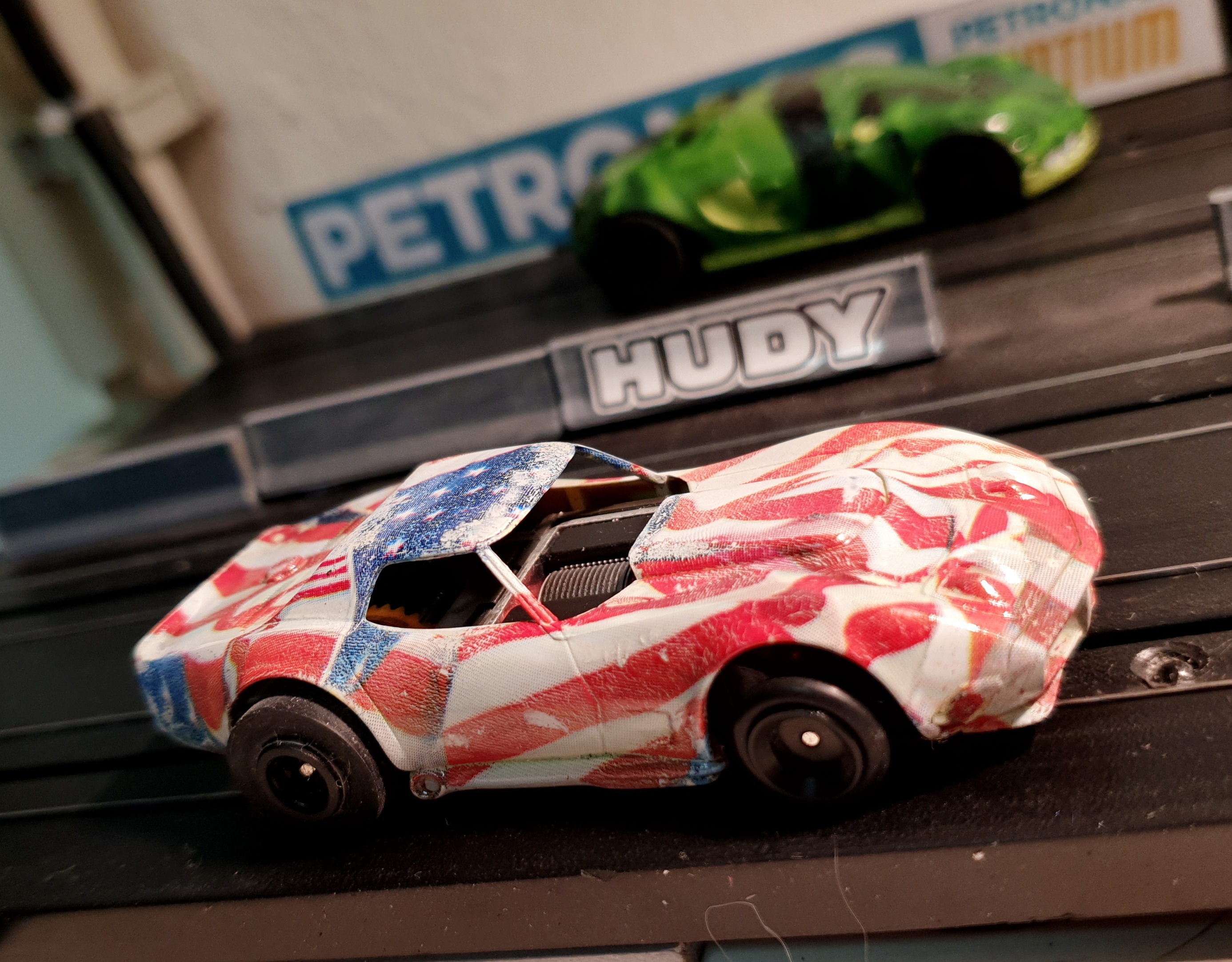

regarding my pro stock DNF Andy , did you notice what the cause of the problem was ? loose wheel/tyre , shoe springs too strong ?  Ambulance

Kev - we've always had issues with the non-mag pancake cars, especially if they have plenty of power... as yours does. There's a tendency for the front to lift dramatically under acceleration - getting F1-style 'porpoising' or a deslot. If the cars are also a little unbalanced, it will veer to one side or other - and on inspection, one shoe spring on the Chevy was firmer than the other. The fix? Balancing everything perfectly, plus a combination of weight at the front, plus a wheelie bar and/or button magnet at the back. A short RCR-style test track is a useful thing to have to perfect that launch phase.
