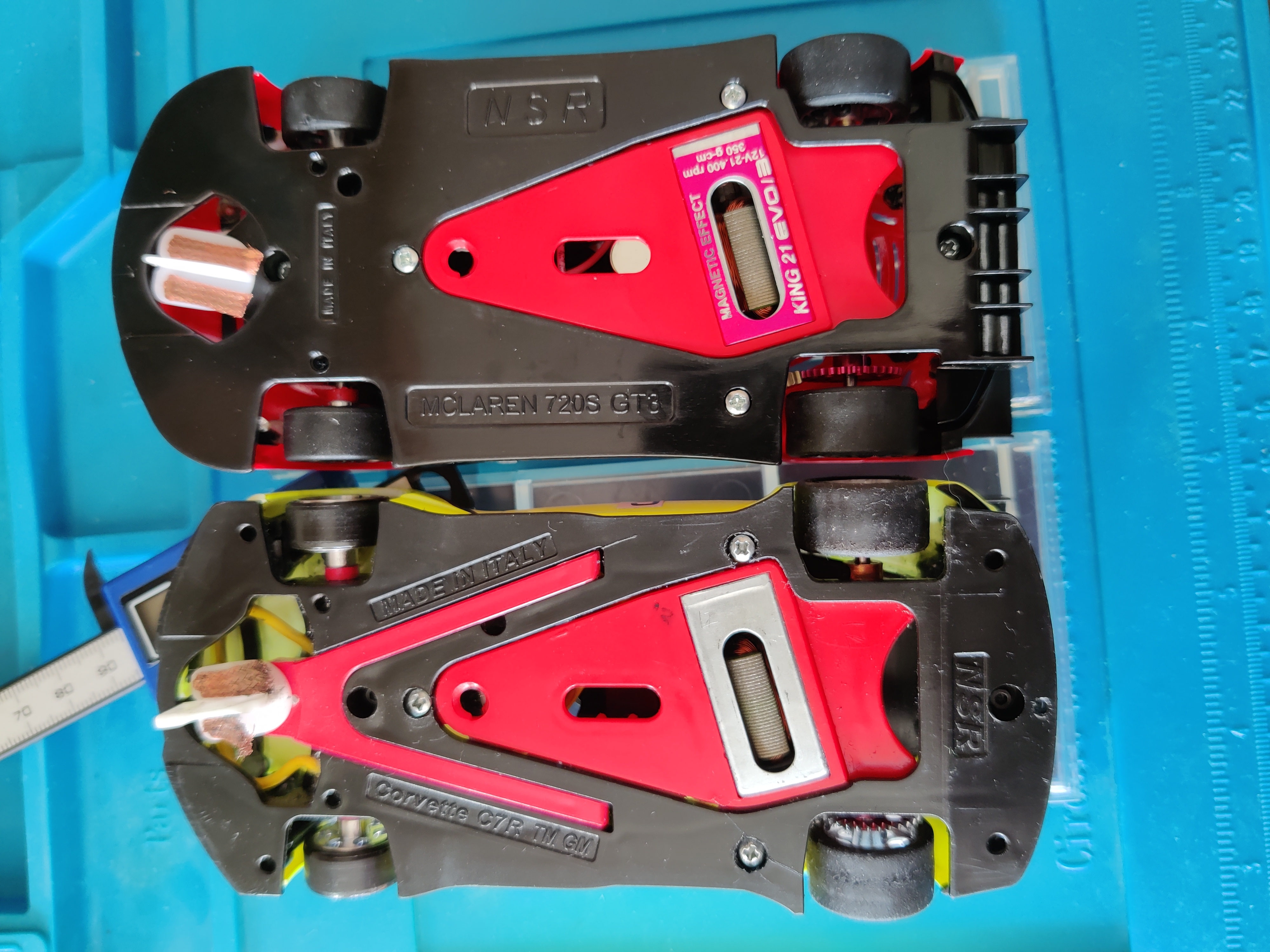

Arrived today, slightly wider, taller and longer than the Corvette but not much in it. The cab/interior is significantly further forward so I wonder is a different centre point will make it handle differently. I don't have a sideways 720s to compare it to but happy with the detail compared to the Corvette, familiar nsr style but slightly more detailed.
[+] 6 members Like tatter06's post
