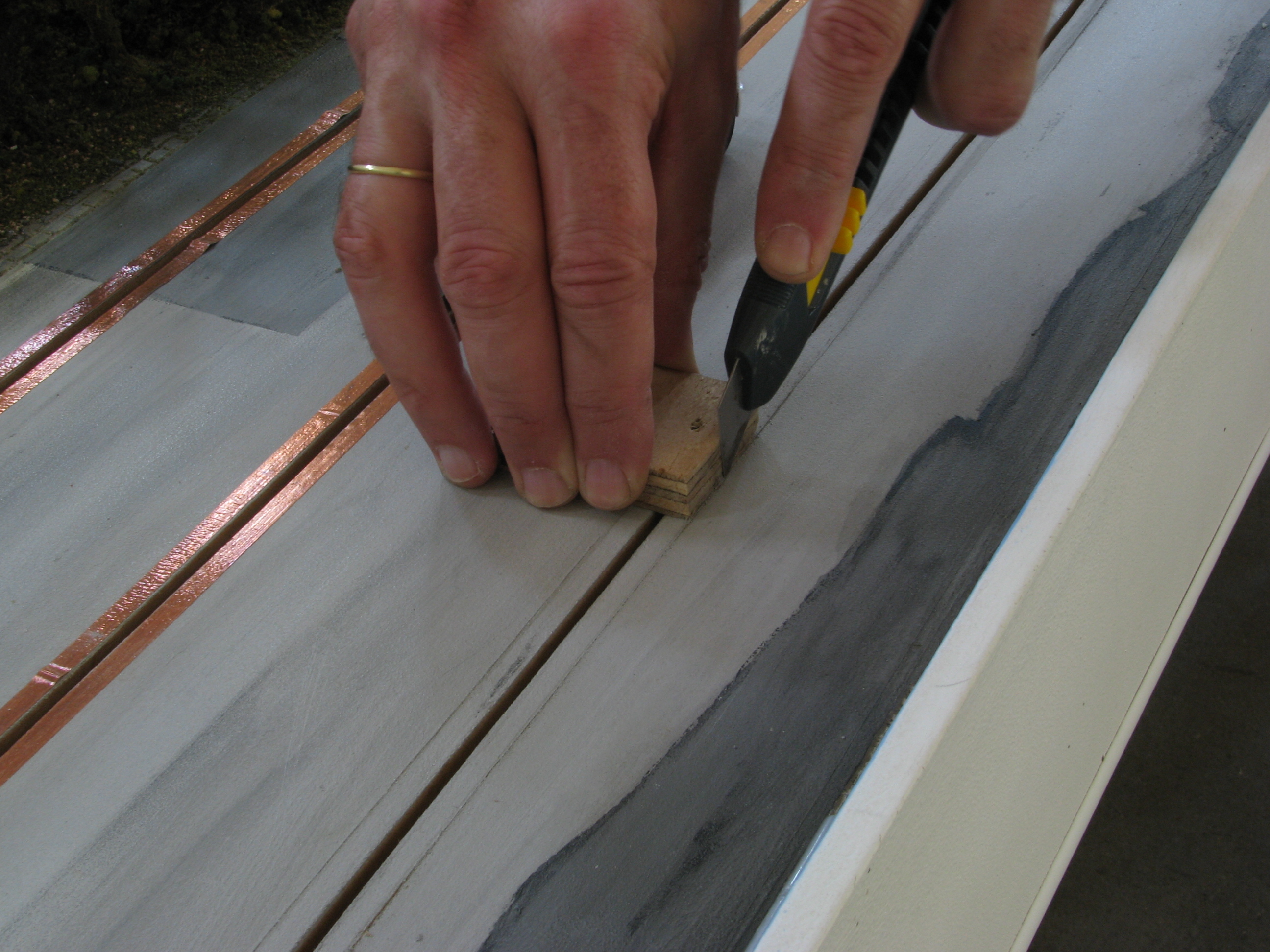

In 2006 the Dutch Trio Track started "live" as a copper taped track.
After six years, the copper tape had to be repaired so often that I decided to go for braids.
Here is a photo report about that replacement:
Hub Thumbup

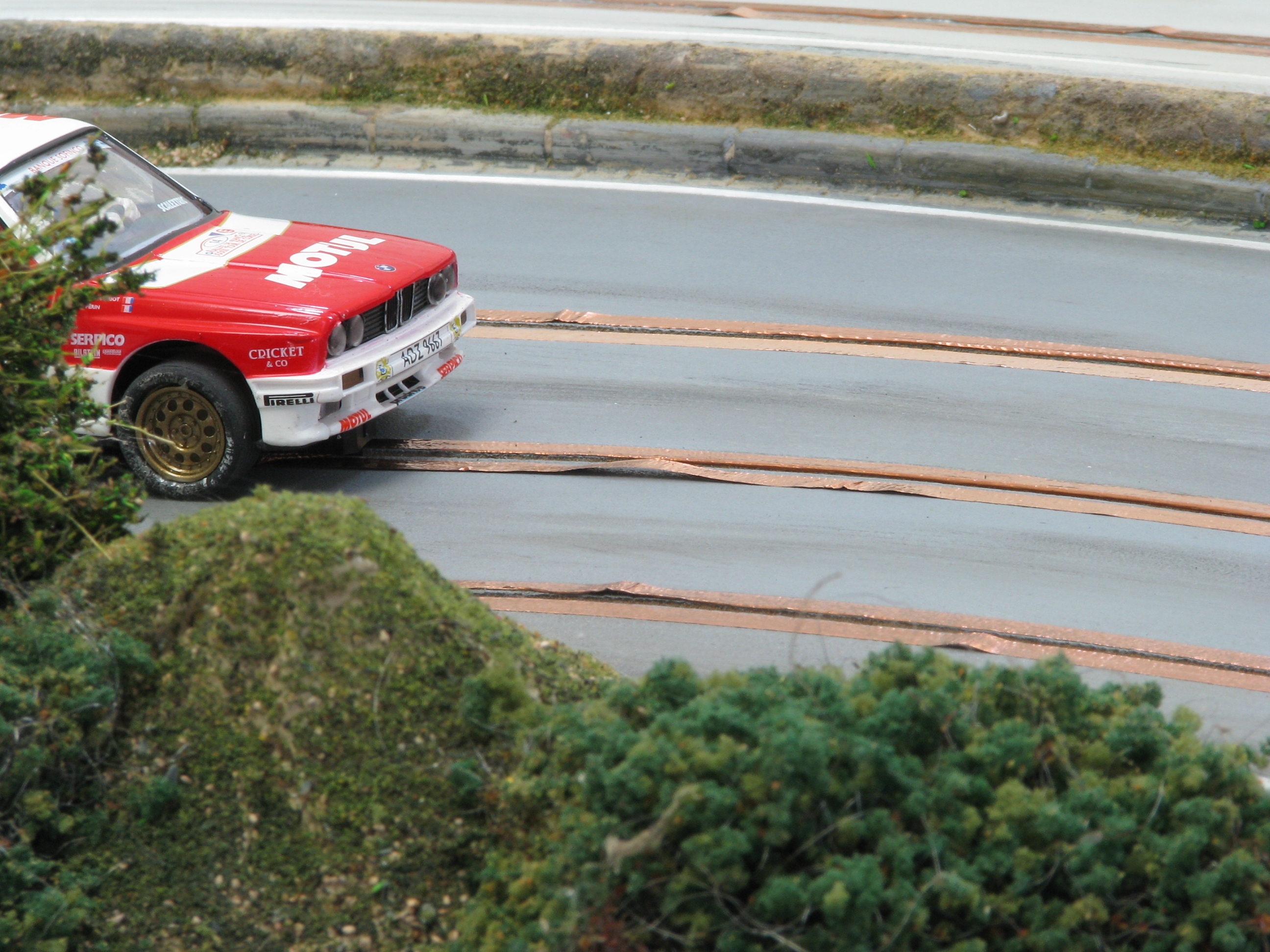

The condition of the copper tape before it was replaced with braids.

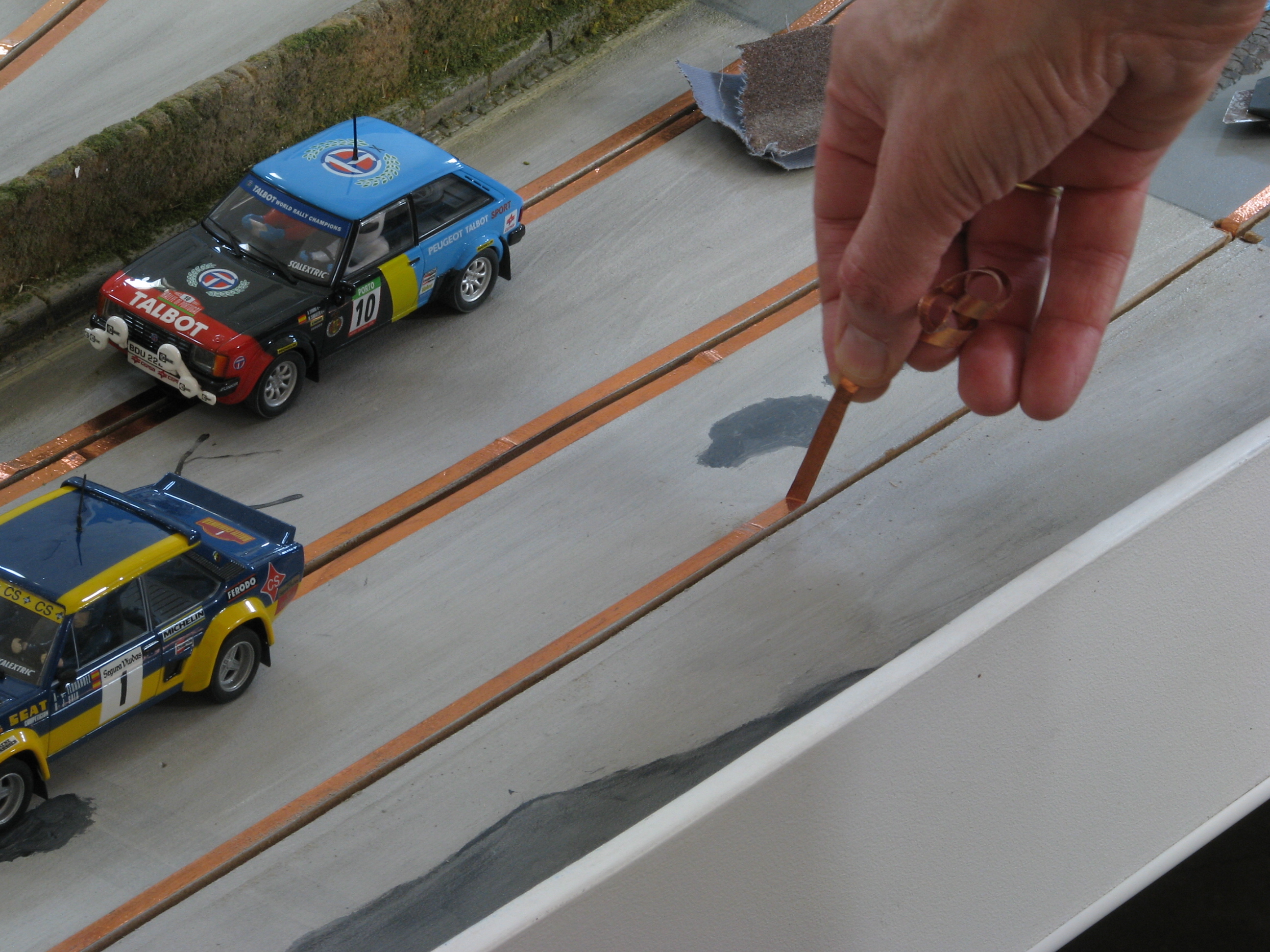

The removing of the damaged copper tape.                                                                        Cutting one side of the braids chambers with a simple handmade tool.
                                                                                                                                                                 (block of wood and 3 mm pin)
[+] 5 members Like rallyhub's post

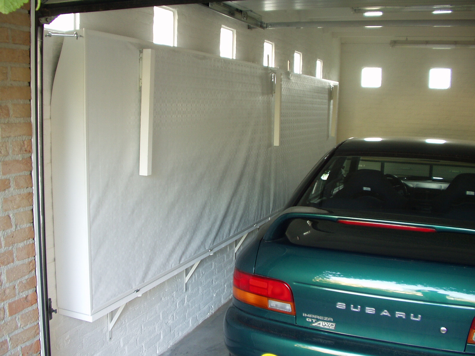

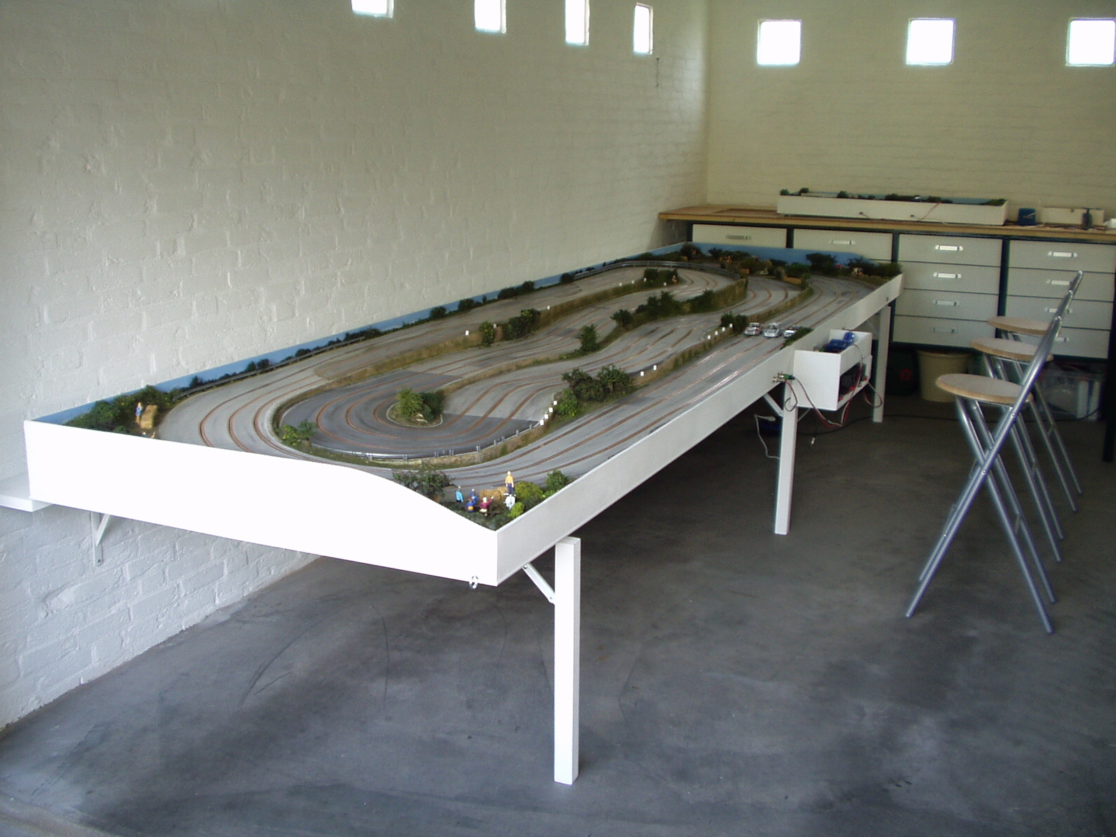

How did the copper tape get in such a terrible state Hub? In over ten years I have only had one breakage on my track, due to the MDF board shifting slightly. The rest is as good as the day it was laid.
#14
Hi Brian,

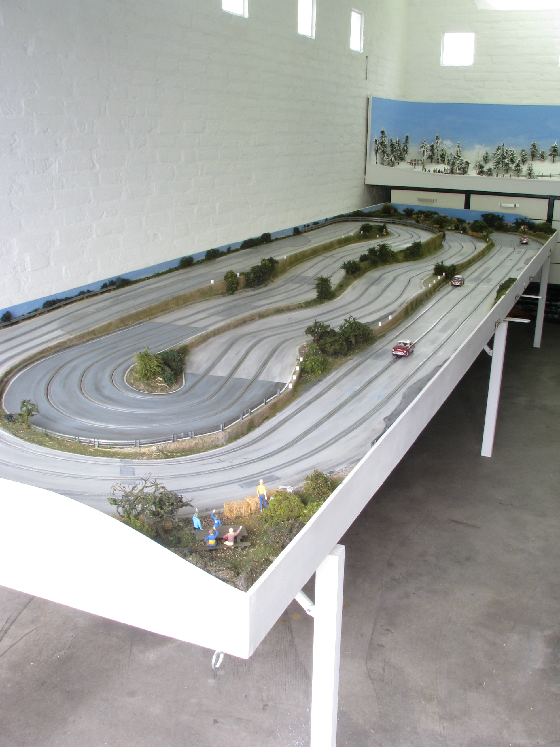

I think the temperature in my non-insulated flat roof garage fluctuates more.
The garage is placed against the house on one side only.
When not in use, my racetrack is positioned vertically against the outer non-insulated garage wall (the longest wall without a door).
In winter it can freeze and in summer the temperature can rise above 40°C, after the hot car has been parked inside.
There are always forces on the copper tape adhesive in that vertical position
But maybe my choice of copper tape was wrong or it was just bad luck.

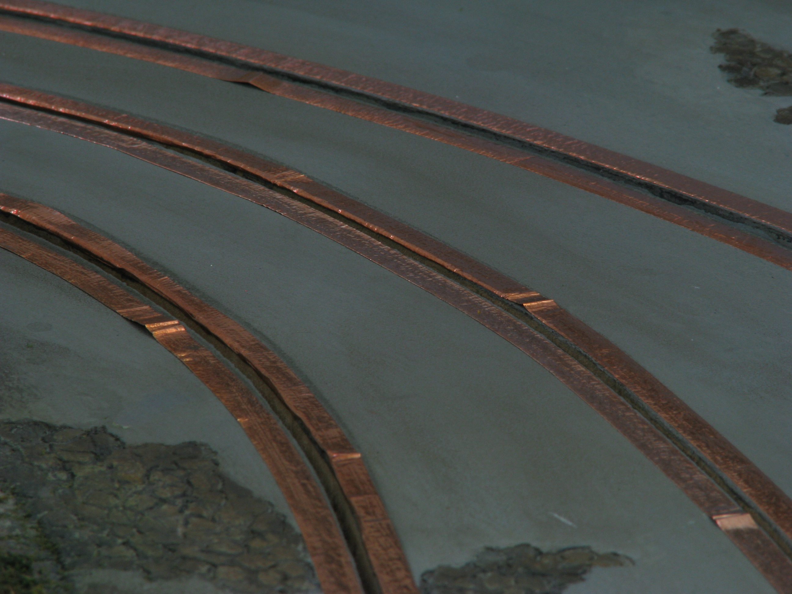

I used copper foil tape 13/64"x36YDS 5.2mm (.00125).
The copper taped Trio Track ready for use.                                                                           The hot car parked right next to the vertically tilted track.

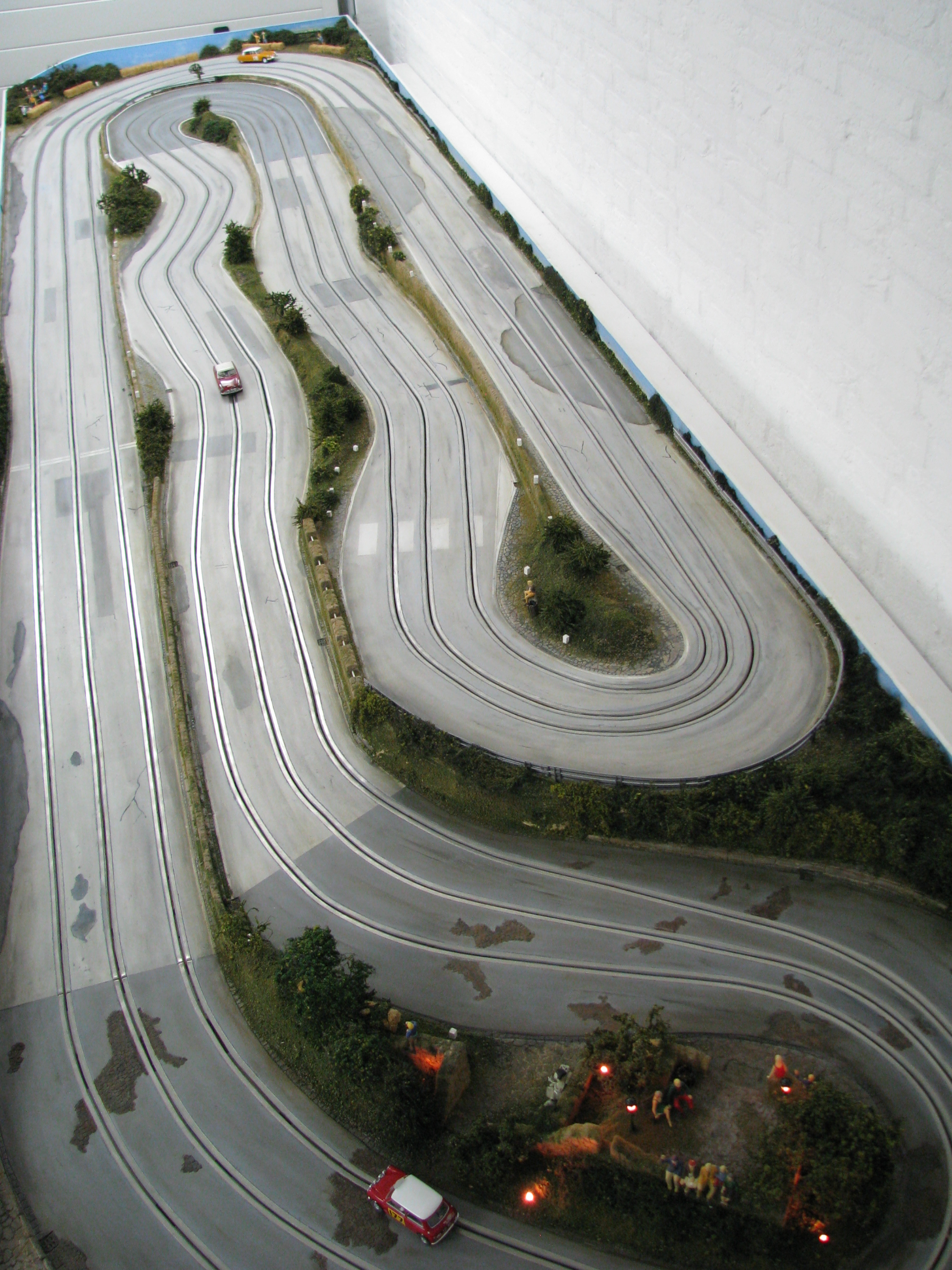

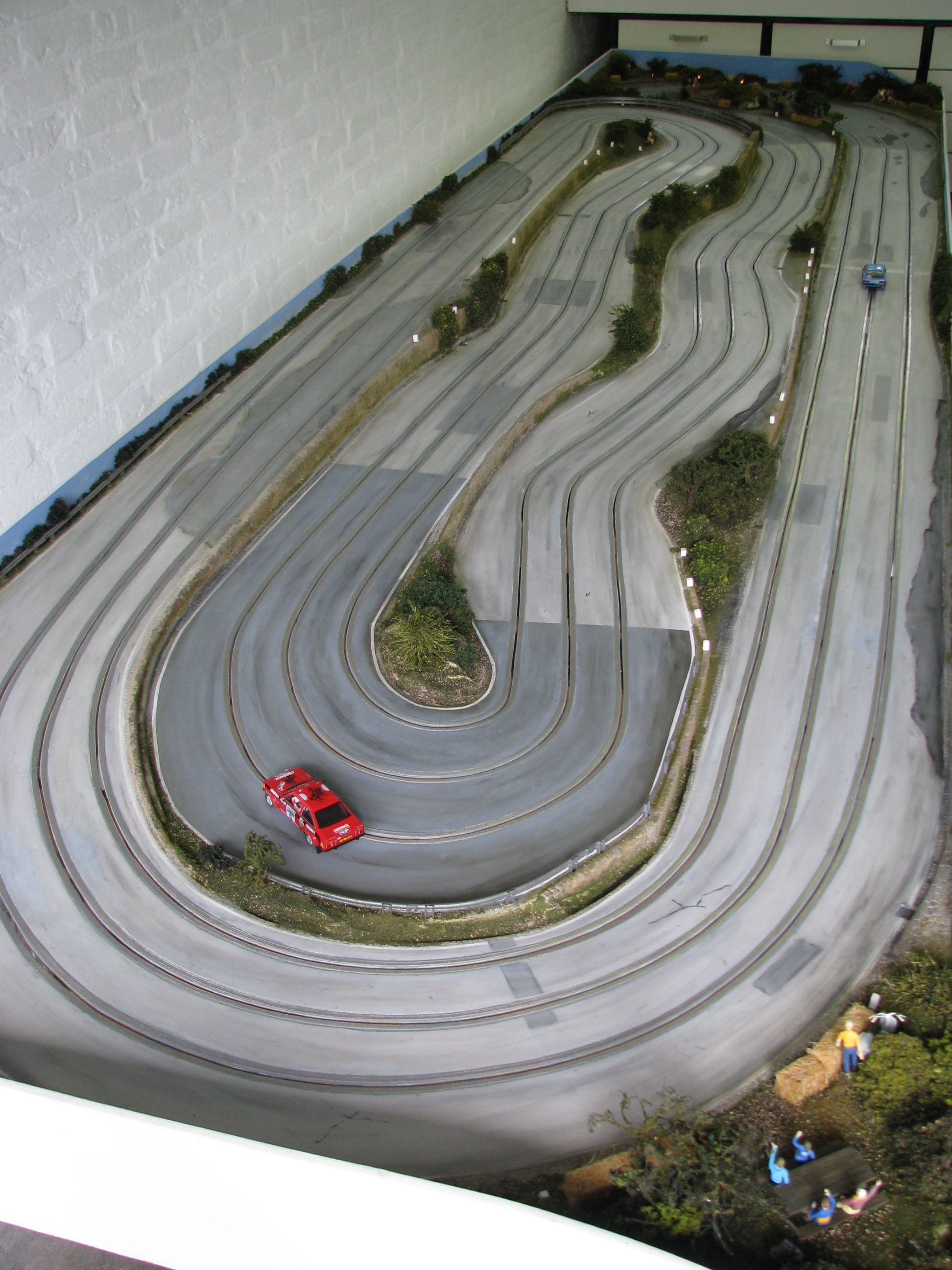

Here's the final batch of photos about the change from copper tape to braids on the Trio Track.
I hope you liked the photo report.
Hub Thumbup
Connection to the cabling.                                                                                                           One lane done, two more to go.
All three lanes ready.                                                                               Braids on the Trio Track.                                                                         View from Ruin Bend.
[+] 9 members Like rallyhub's post

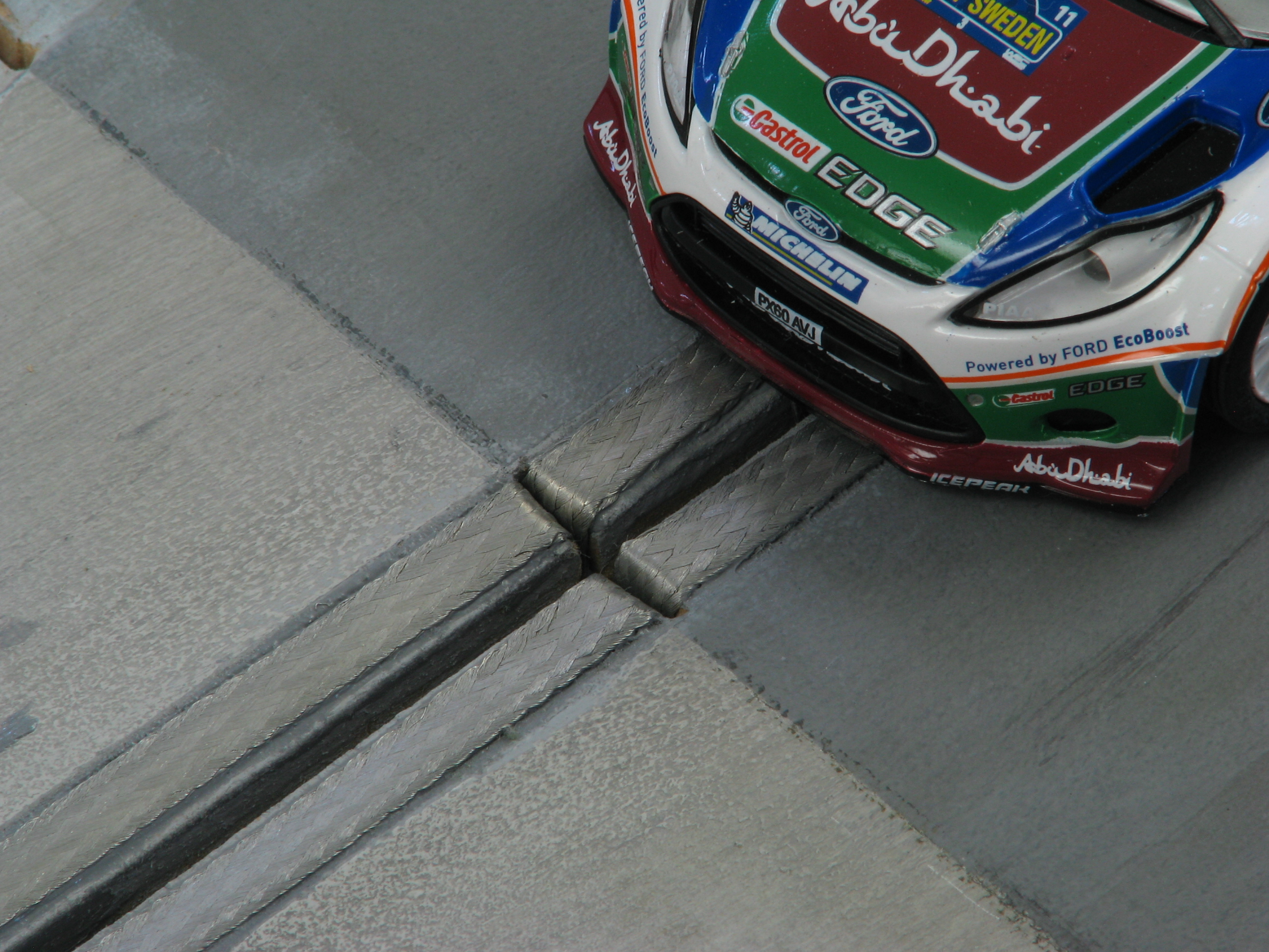

A quick question: the picture labeled "Connection to the cabling" - how did you cut those nice, thin openings?  I'd like to have mine look the same!

The thin openings were made with a small flat file.

Not enough space between the inner slot and the border for using a router.        The thin openings are made with a small flat file (photo of another track).

Hi hub, I love how you have made this track so you can fold it away.
Have you done a complete build thread  on  this?
It's the solution for what I want to do in my garage, so many questions like how things are fitted to the board and don't move when folded away.
I would love to see any construction pics if you're willing to share.
