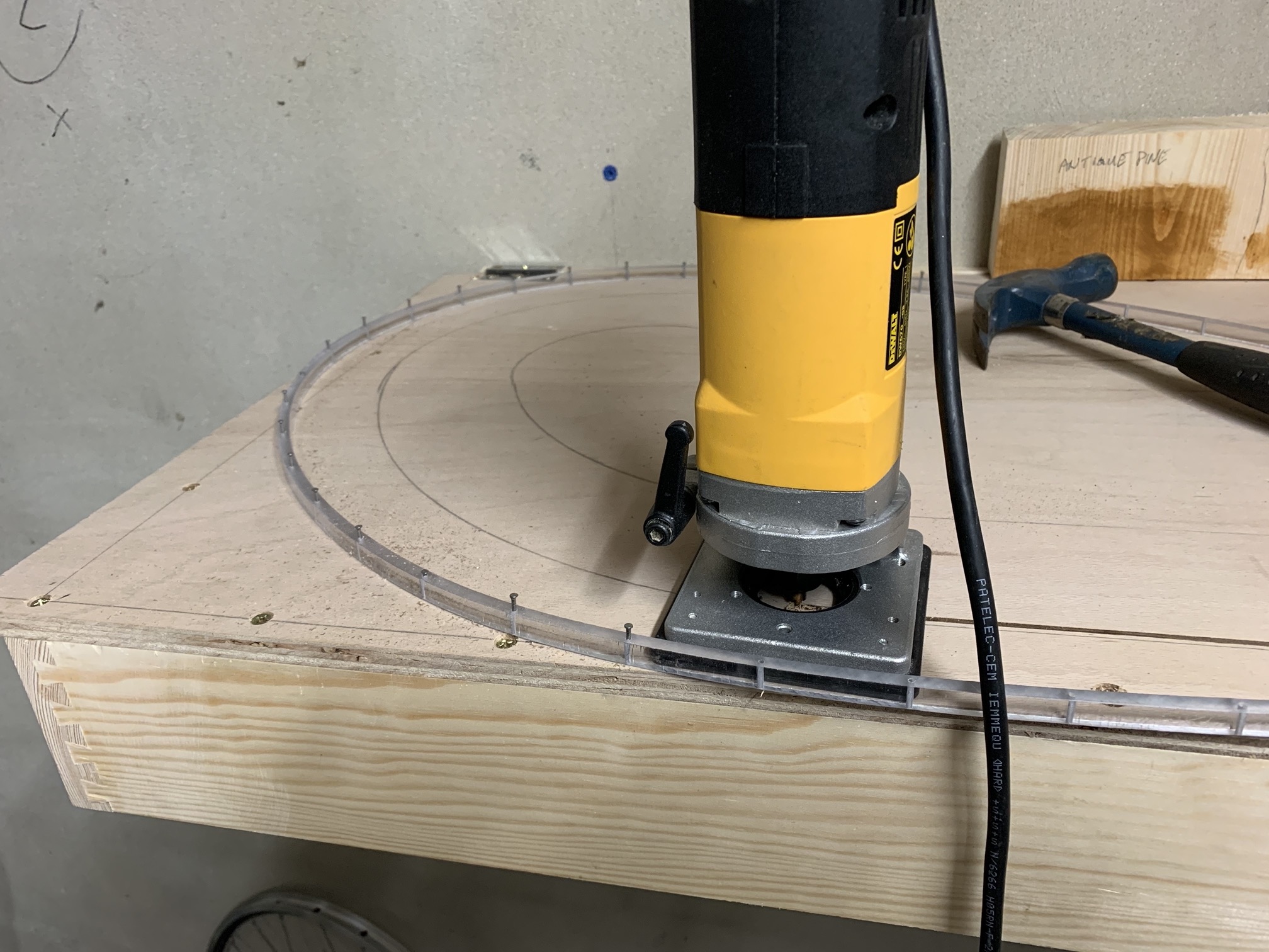

This is my first post here, I've been building a wooden slot track for quite a while as per these photos. It took about a month to build over a few evenings and weekends in Jan 2019. The basic plan is two lane routed track that uses Scalextric digital technology to drive lane flippers and run races via the iPad app.
The track curves were designed with the existing Scalextric flippers in mind so there are two overtaking spots and one pit lane.
Flippers work well and the digital or analogue also runs cars around quite happily.

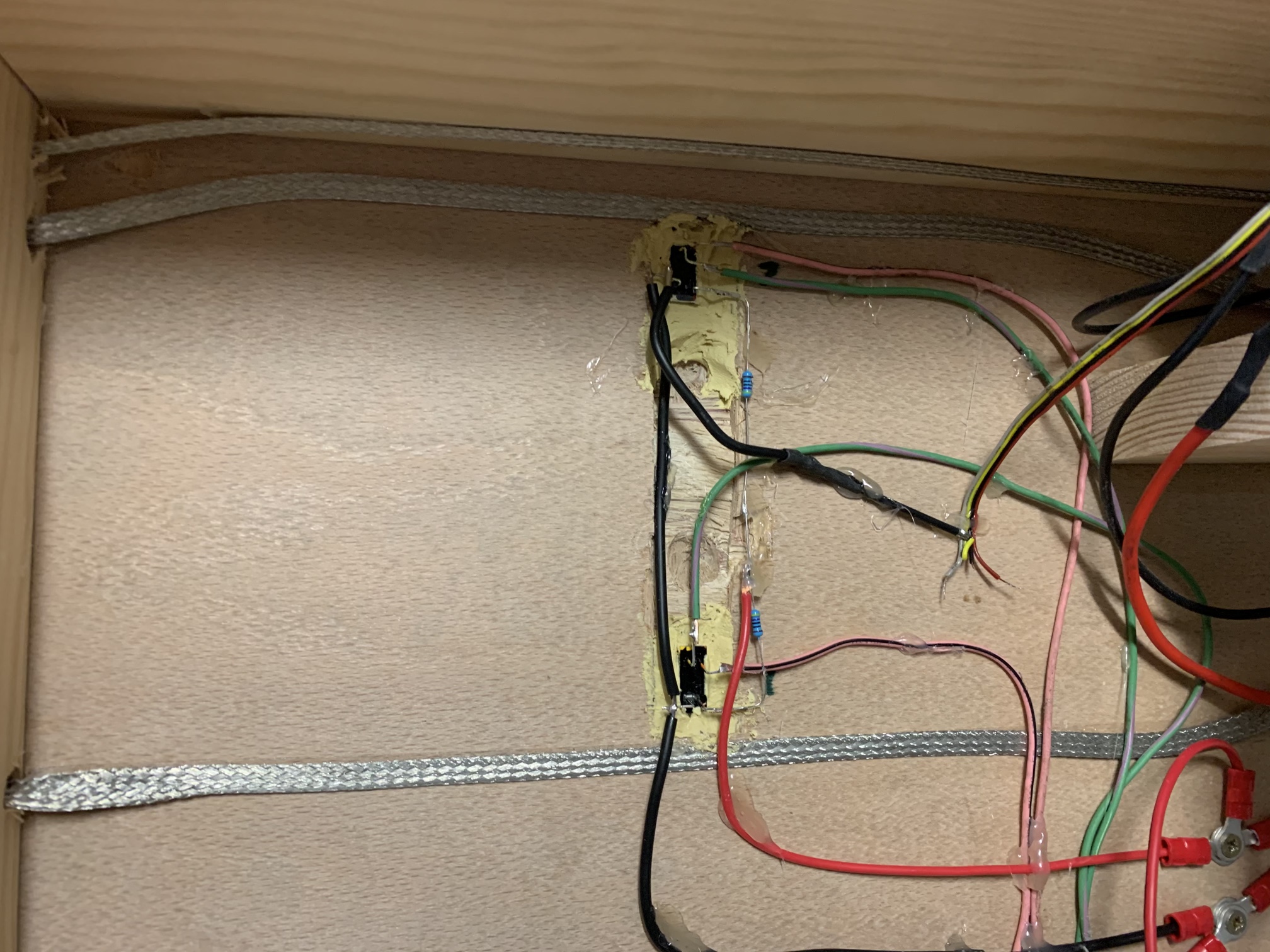

And so onto the problem, no idea if anyone here can help. I'm trying to replace the opto couplers with these:
https://www.truspeed.co.uk/products/8mm-...ack-sensor
https://www.truspeed.co.uk/collections/s...nterface-1
But I've tried a few things to get it plumbed into the Scalextric head unit for the Pro but it's doesn't count laps. The out of the box Scalextric sensors do not like being de-soldered from the board and they fail.
Does anyone know what the pinouts are needed to get this little box of tricks communicating with the Scalextric system? there are four wires for each sensor module in the Scalextric system and I think they are as follows, but clearly not as they don't work!
yellow = gnd
black = +3v
red = lane 1
gray = lane 2
Any info anyone might have would be a massive help!

I've just been doing some bench testing with an old Arc Air powerbase and a multi-meter. I think my assumption that a +5v pulse to a certain pin on the sensor connector is the problem, it's not how the Scalextric system detects the guide blade; instead what seems to be the case is the following:
red = gnd
white = +2v with no car on lane 1
white = 0v with a car's guide blade blocking the IR sensor on lane 1
Back to the instructions for the track interface for 'negative going' - I think this is more likely the right setting to fool the Scalextric unit...

Thanks Dr_C, I've managed to get it working now. The key was configuring the opto sensor interface for 'Negative Going', this essentially provides +5v to each of the four scalextric lane detection wires and when the guide breaks the beam the +5v drops to 0v and the system is triggered correctly.
For anyone interested and for future reference the wiring required was:
wire the opto sensor interface for Negative Going
flip the switch on the interface to Negative Going
scalextric ribbon yellow - common ground for the opto sensor interface
scalextric ribbon red (lane 1) - lane 1 on the opto sensor interface
scalextric ribbon black (lane 2) - lane 2 on the opto sensor interface
repeat for the other two sensors.
The track works timing and counting laps for races in both analog and digital modes. One oddity of the digital mode is that neither car can get a whole lap ahead it seems. The other car has to come around and count a lap before the other can do so. I don't remember that being a feature of the Arc Pro system but maybe it is?
