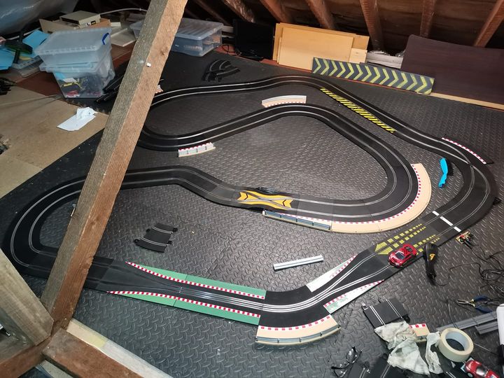

Also a pic of Simon's "Martyrs' Mile" stage...
Seen some video too Sun

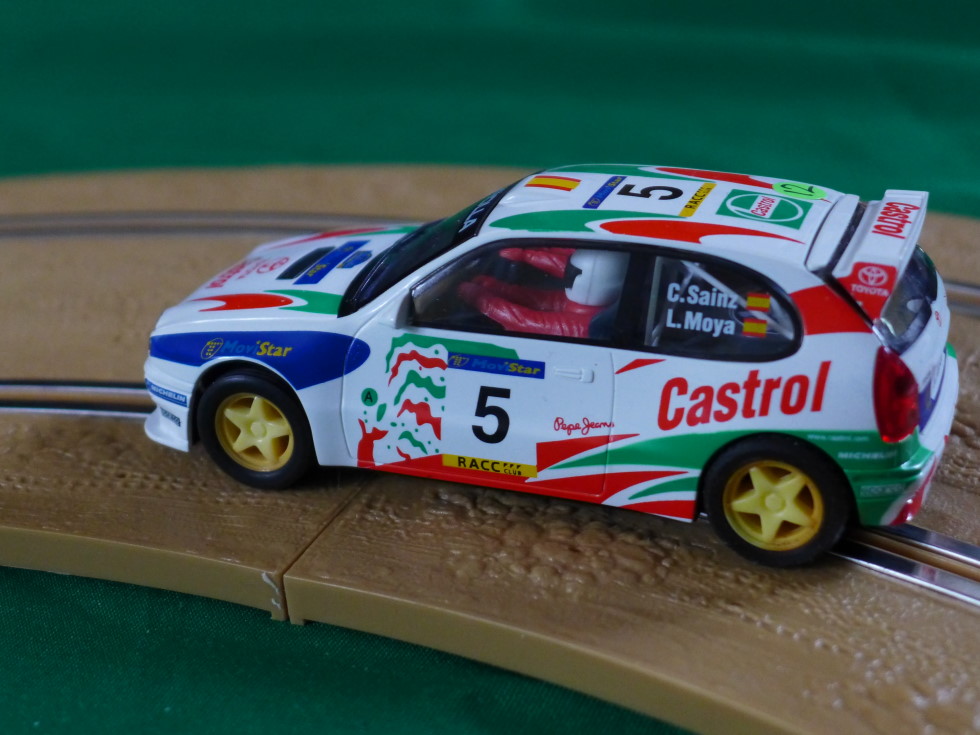

Woodcote
Could you describe what you were seeing when the cars raced over the 'textured' sections of track?
How do the fast cars manage to go fast?
What is slowing down the slower cars?
Thank you
(Just asking for a friend...)
Let's go...OFF ROAD!
#64
This is a pic of one of the Scalextric cars on the Ninco off-road track...
You can see how the surface is both textured and - in places - raised by 1-2 mm.
The guide still sits on the flat rails, so it's mostly the front tyres and also the bottom of chassis (and any low-slung body-work) that will be worked by the bumps.
Some cars simply had their guides bounced out of the slot. 'Good' cars responded predictably - ie getting through fine at a slower speed. 'Bad' cars were completely unpredictable - sometimes getting through, sometimes not - even at crawling pace. Like with real-life off-road driving, going too slow can accentuate the bumps - so cars that couldn't get through really couldn't get through. It was a case of sitting on the floor and marshaling an off almost every lap. Thankfully, that was only 3-4 cars out of the 46.
Even if they didn't de-slot, a lot of cars were bumped about, with less-than-perfect power, rubbing the chassis etc. The overall experience hitting the off-road section was of suddenly slowing - like wading through treacle - and then jerky power and very noisy!
The faster cars skipped over the rough stuff and didn't come off. There was a little more noise and a slight sensation of being held back.
The Ninco and SRC cars did well - they have a sprung guide, independent suspension on all 4 wheels and a long can motor with some magnetic traction. All these factors keep the cars more stable. They also have decent ground clearance. The more modern SCX cars also have a sprung guide - so consistent power, even if the front wheels are being bounced up and down. Some of the older SCX and Scalextric cars also ran well over the off-road section - probably the extra ground clearance and loose front axle helping?
On the Scalextric Class A & B cars, there wasn't much to do to make things better - lower-profile front tyres maybe. For the Class C cars - a sprung guide is recommended.
