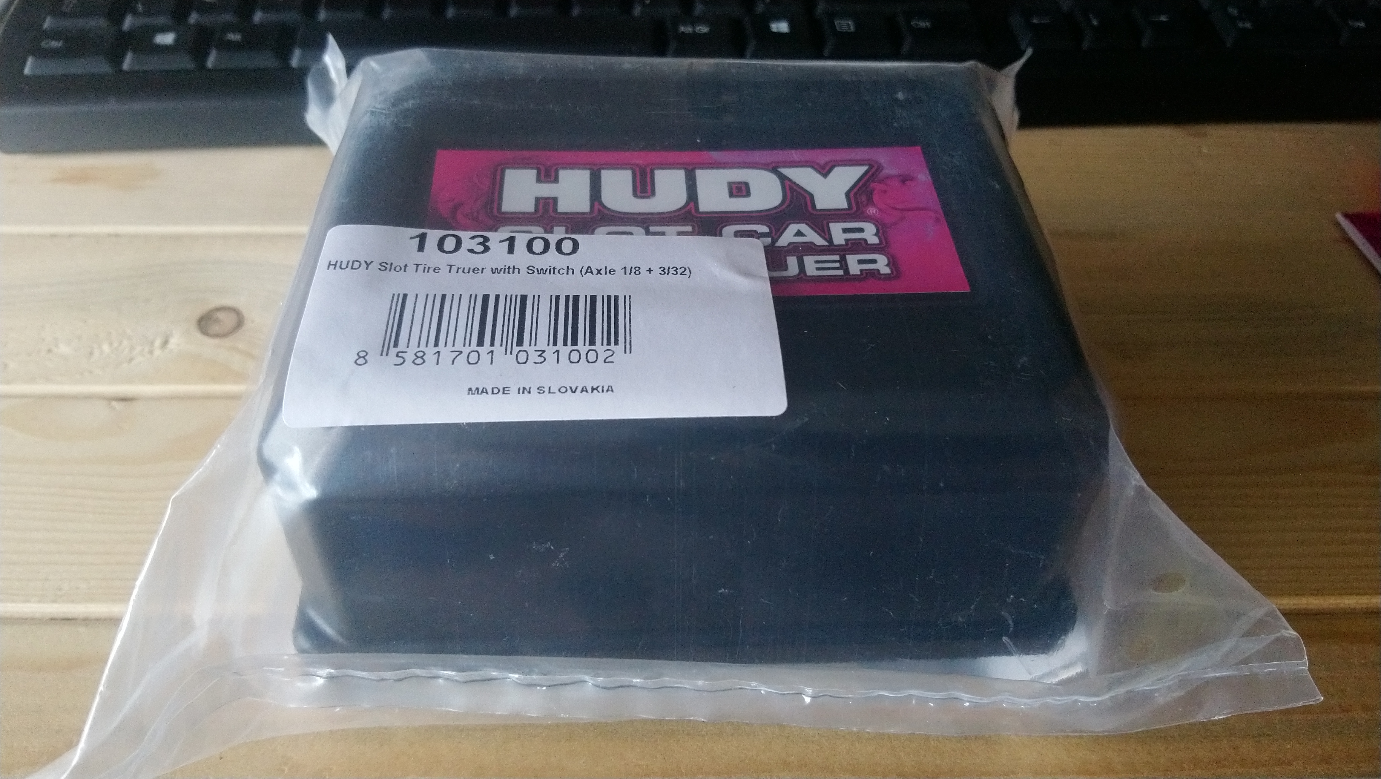

Hudy Tyre Truer 3100

Along with the Hudy, I had to raise enough funds for a power supply as well. Recommendation was "adjustable down to 0v, with at least a 5a output". Quite a few 0-30v/10a units available, but I could just imagine myself accidentally pumping too many volts though the truer with the wrong twist of a knob. But managed to find a 0-16v/10a unit, and this is on it's way to me from China as I write.

First question to all Hudy experts...
How do I know when the headstock is parallel to the grinding drum?
Let's go...OFF ROAD!
#26
The bolts are counterbored so as not to be missaligned. It's machined straight. You'll have a hard time throwing it off unless you drop it.
There are a few changes I did to mine.
1) I true the tires at a very slight angle tapering smaller to the outside. It's actually very hard to try and missalign that system. I had to loosen all the bolts, give it a twist, and tighten the bolts again. You can barely notice the angle. Along with proper profiling, the slight angle helps the tires break-in on the track in without grabbing and flipping the car.
2) I found that the drum was leaving deep score lines in the tires due to a few high spots in the sand on the drum. So I took a wide file and barely touched the drum while rotating it one turn by hand to remove the extremely tall bits of sand. Be very careful, or you'll be buying a new drum. It takes me a few minutes longer to true the tires now. But the end result is much smoother.
Buy several fine grit nail files from the dollar store for profiling. Every tire needs to be profiled before it goes on the car. The sharp corners where the sidewalls meet the tread need to be rounded slightly.
Congrats on your new truer!!!

(16th-Feb-21, 01:50 PM)BourneAgainRacer Wrote:  First question to all Hudy experts...
Hello Jeremy, It is definitely worthwhile to check/adjust the alignment on your Hudy...(Martin Hudy himself has always suggested you do this prior to its first use).
The good news is that it is simple, and does not require any special tools, but, it is a bit fussy to explain............luckily (for my two typing fingers)  "Triggerman" posted a Youtube video a few years ago that is quite east to follow (if a bit longwinded).....look for,...."Adjusting the ground plane on your Hudy tire truer".
Most of the folks I know have their own variations on this procedure , but, it will give you all the info you need.
