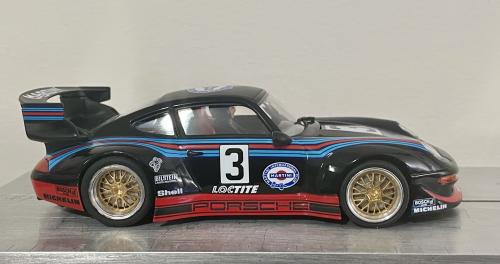

[attachment=37275 Wrote:Graham pid='40116' dateline='1725691347'] (7th-Sep-24, 05:52 AM)Brumos RSR Wrote: The teammate is built but I have a few questions based on this car performing poorly in other proxies. Will I need a rear valance and factory interior?
The rear valance is part of the standard Revoslot “body parts” as supplied, so in my proxy they are expected to be fitted. If the chassis is too close fitting, then up to 1mm of the valance can be sanded off to allow for body float. The factory fitted interior can be replaced with the equivalent Revoslot lightweight part.
I fixed all of the above…. And after kit bashing 3 different GT2s, I have 1 ready to go. Everything is flat, straight, aligned, glued, trued, squared and mildly lowered but still higher than 1.5mm. I had no idea these cars sat sooo high until I measured.

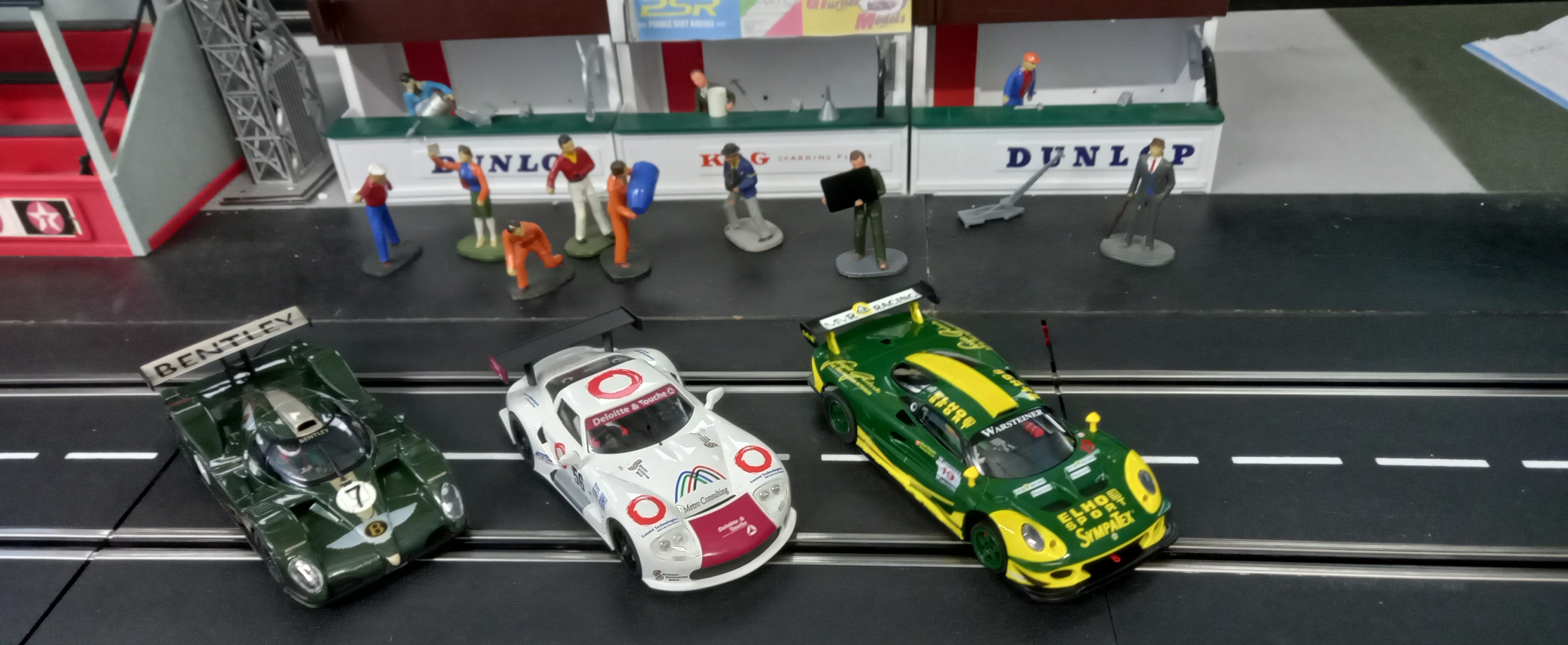

My proposed cars for the proxy
The Avant Lotus Elise for GT1 was a particular favourit buy for me for last year, so this may be the opportunity to let it shine.
The Revoslot Marcos for GT2 has been in service once before, so should not need much work done on it.
And finally the Carrera Bentley EXP Speed 8, for the LMP/Group C, (had to brush the dust off the box for this shelf queen) but having done such a successful job my previous Carrera conversion " De Tomaso GP5" car, I think this will be a noble project for this otherwise static slot car.

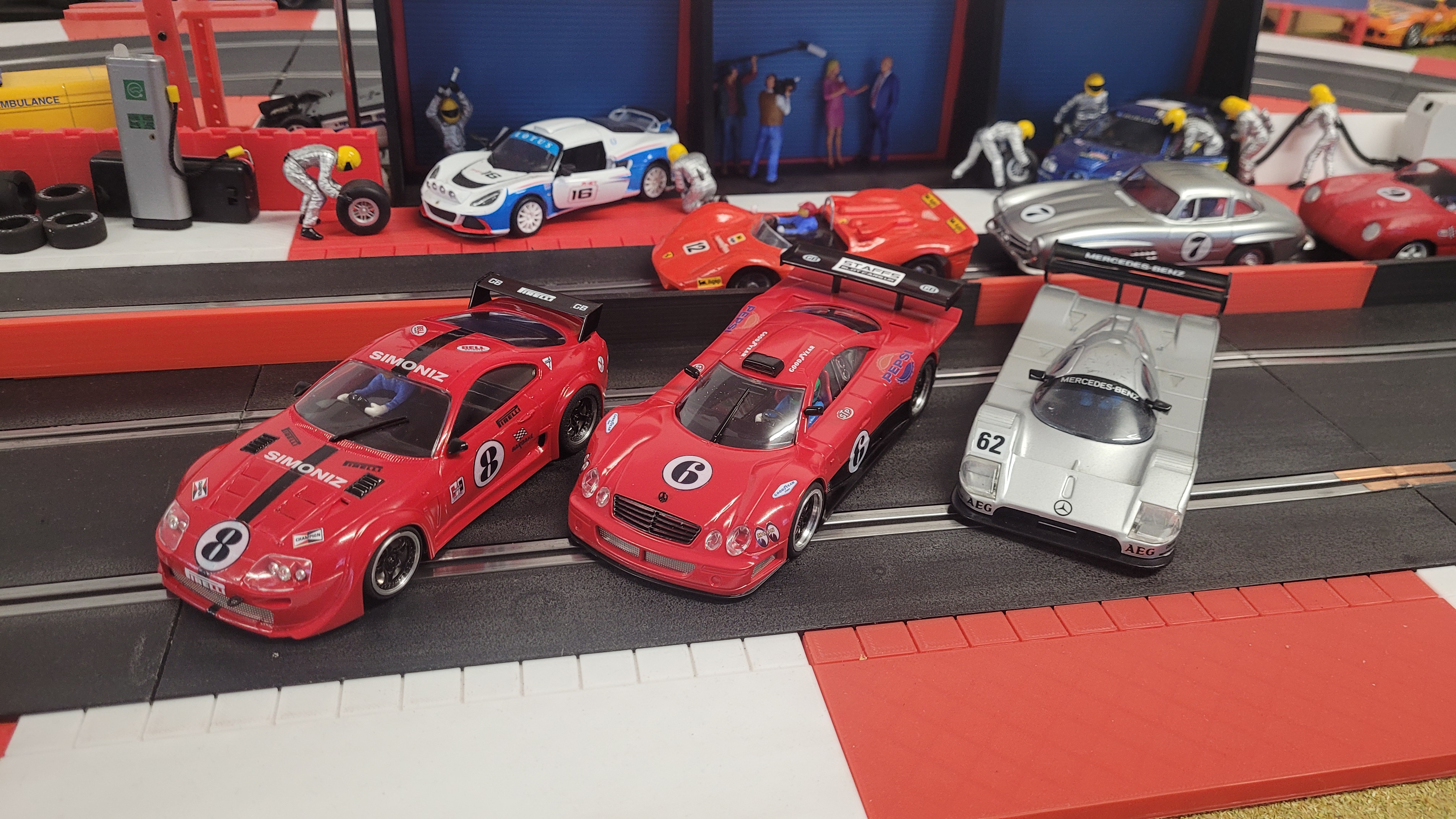

my proxy entries
Stock Revo SUPRA #8 (white kit )
Stock Revo CLK #6 (white kit )
Stock Scally Sauber Merc #62 ( TS rear tyres )

Looks like a good set of cars Kev, I have one of those Scaley Saubers and did consider using it in this proxy.

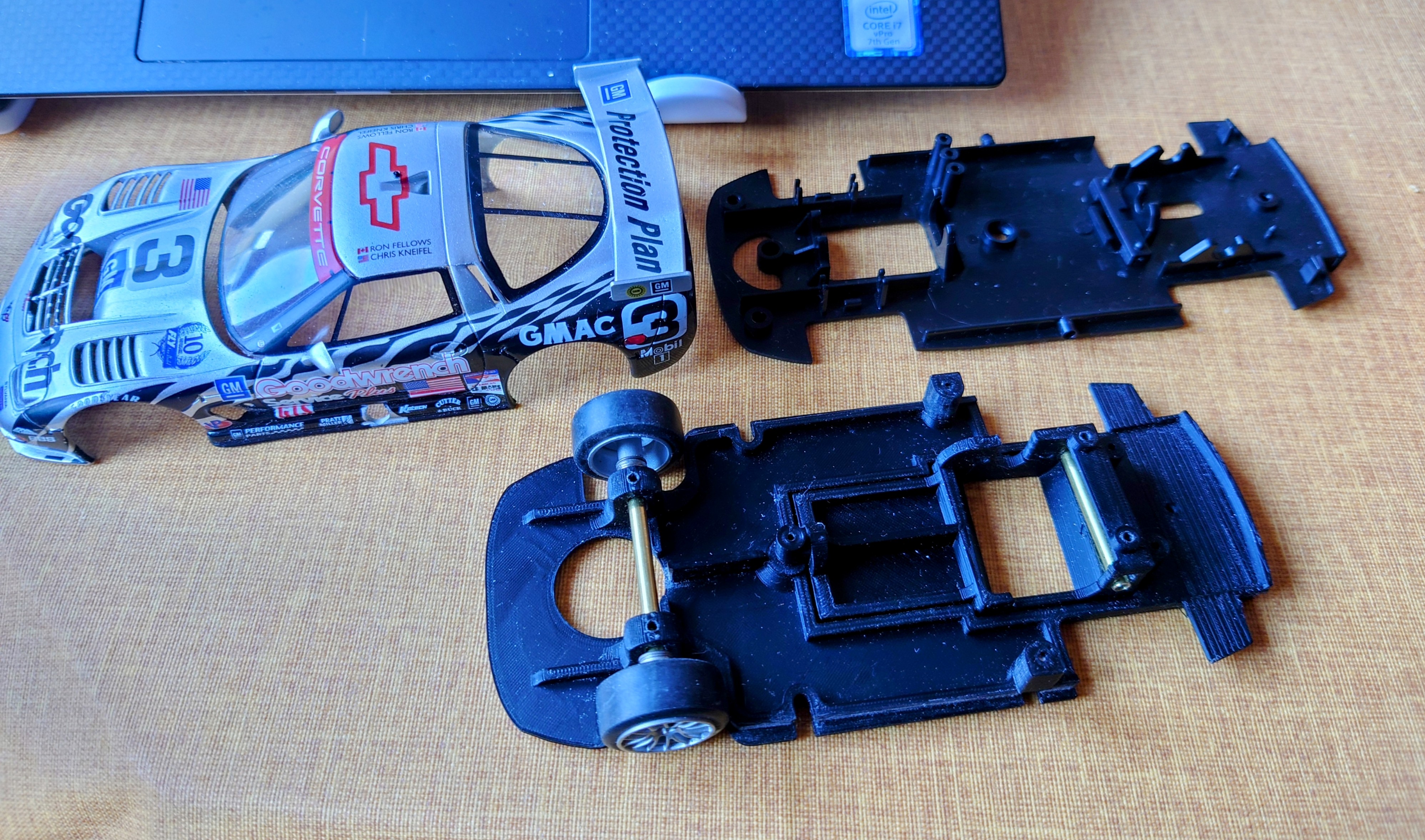

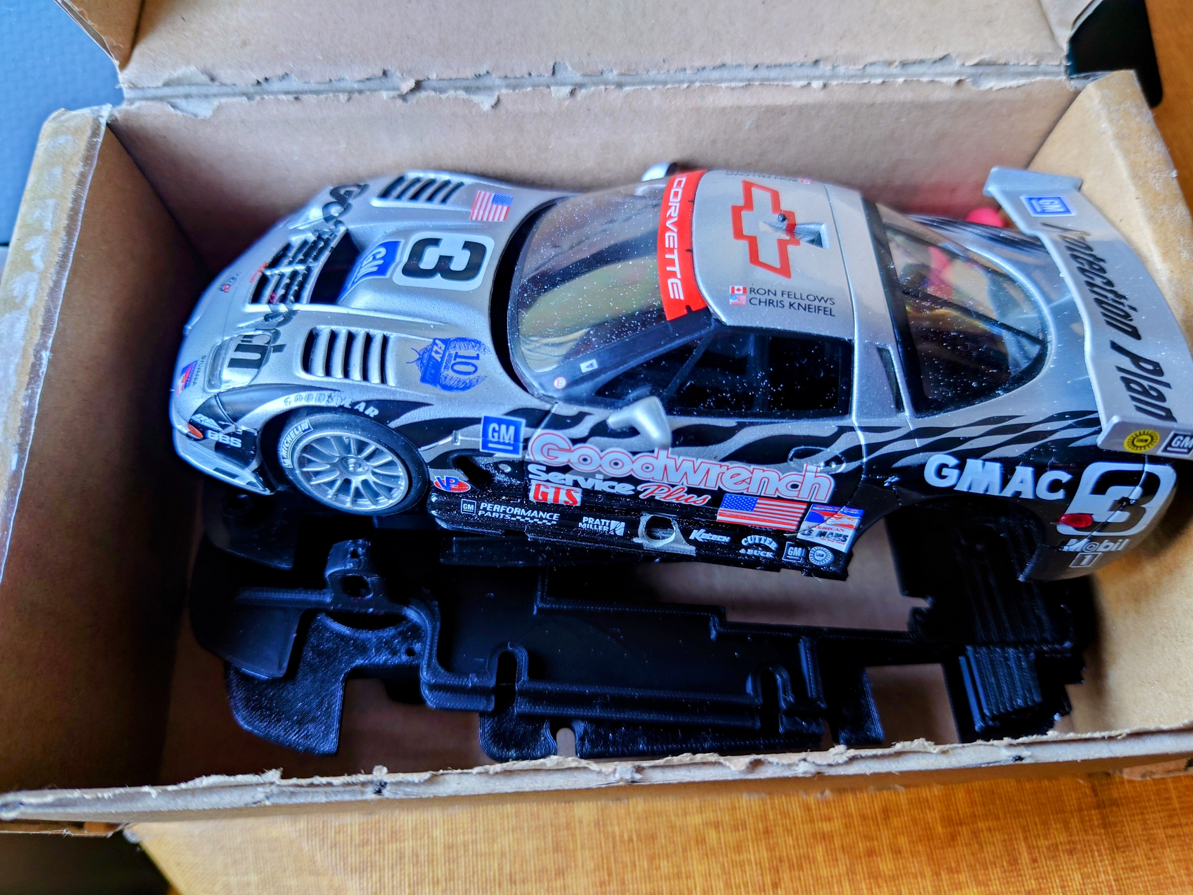

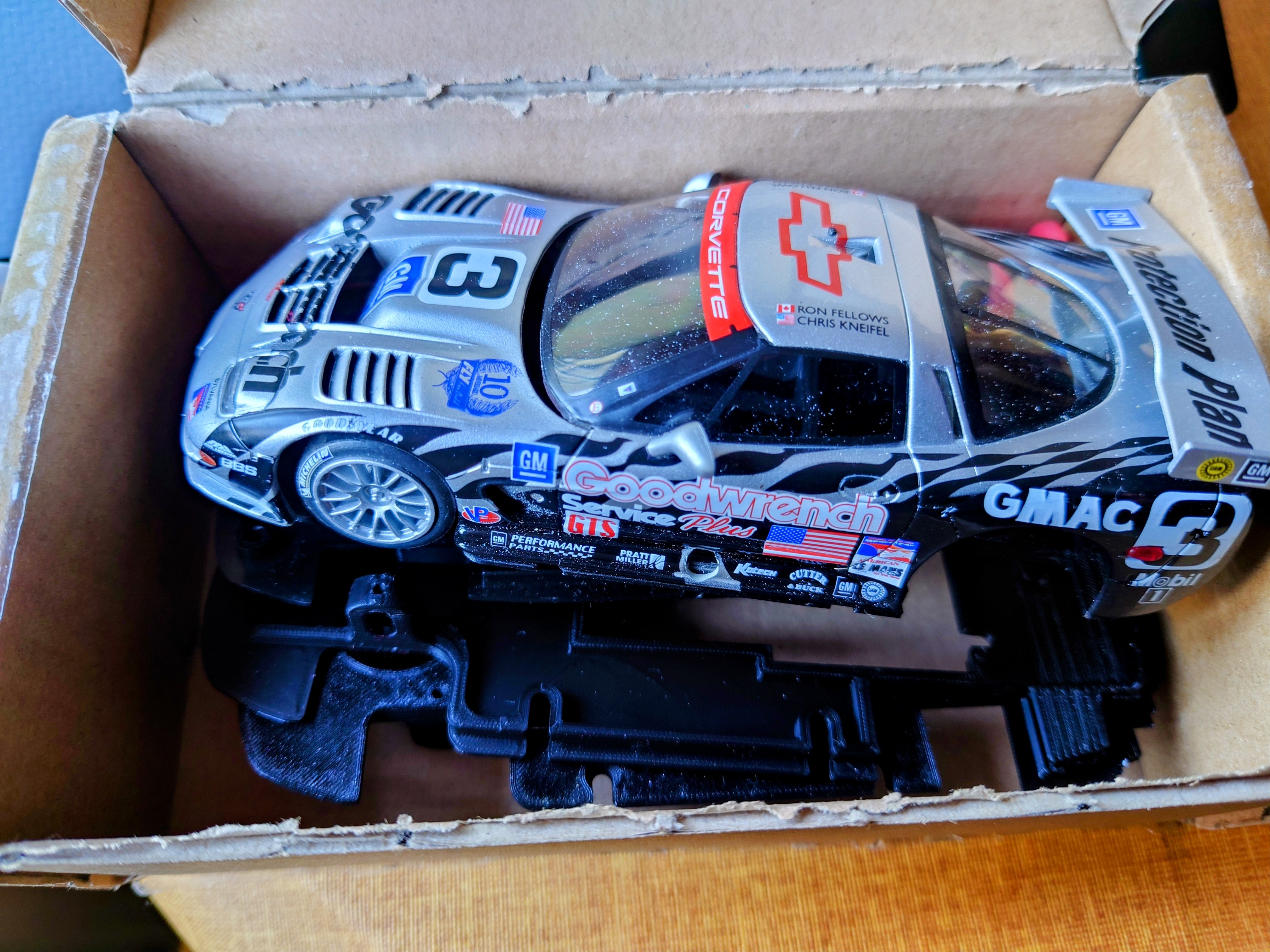

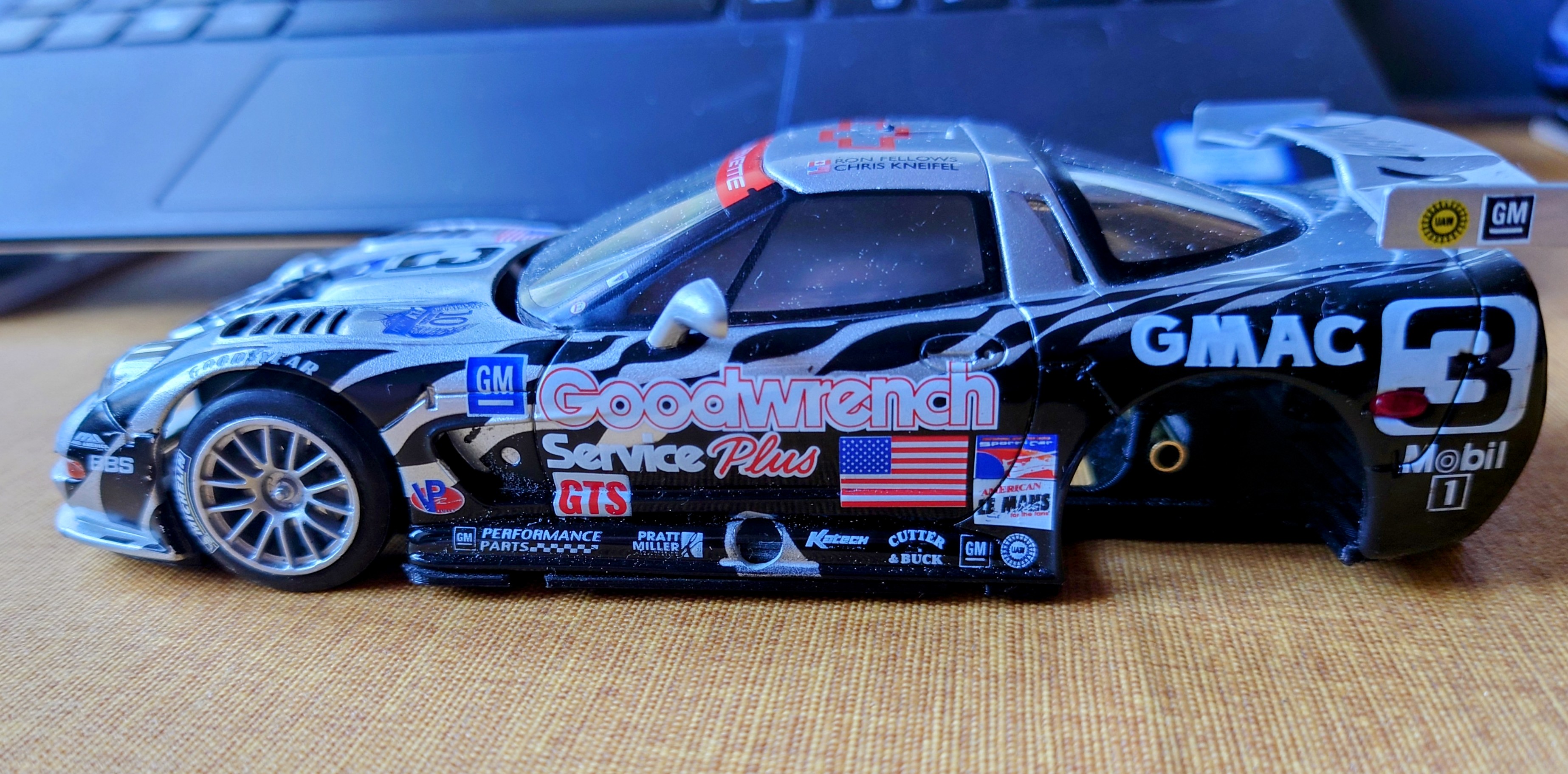

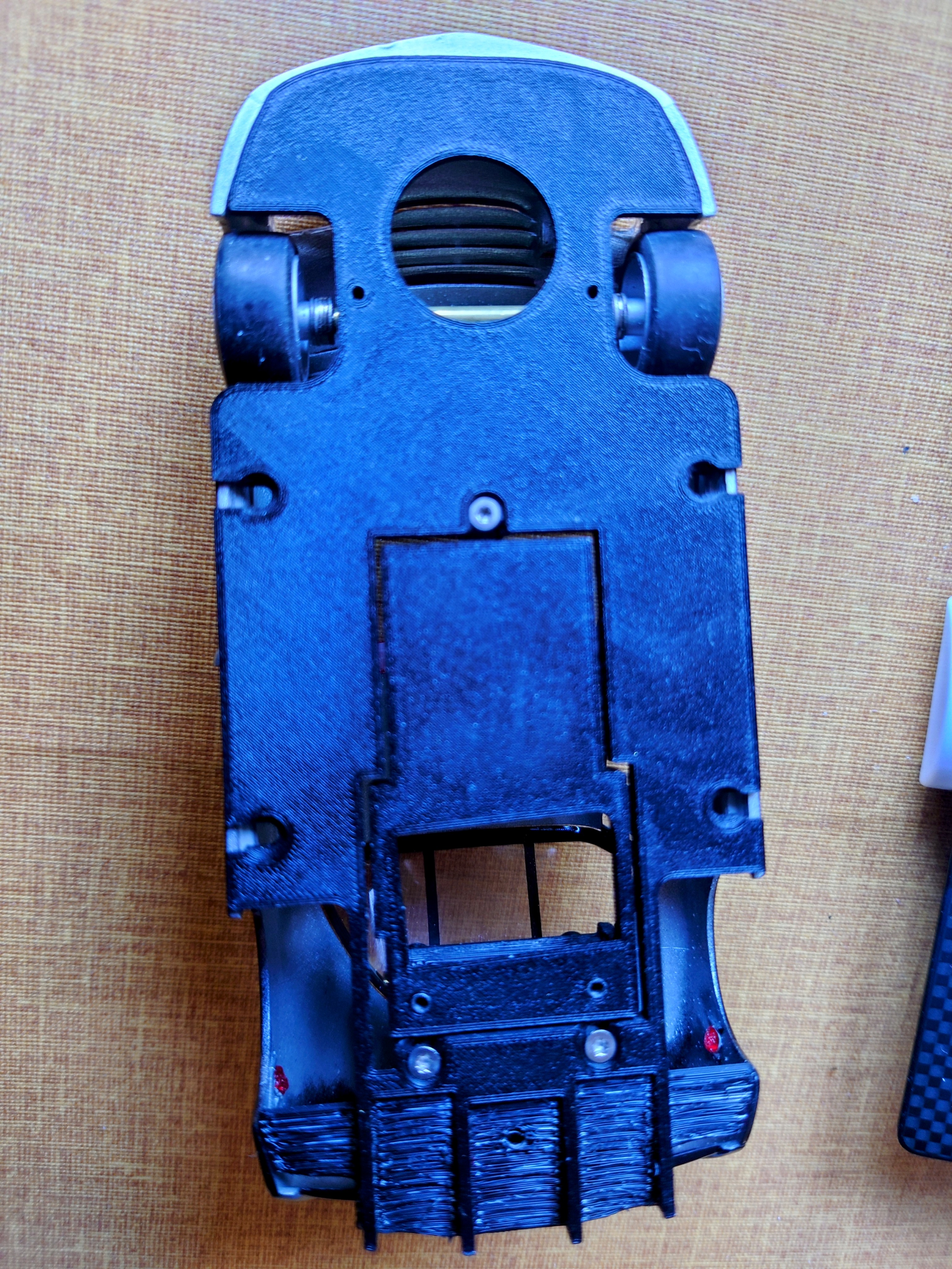

Fly Corvette C5R build.
You never get a 3D chassis perfect first time no matter how well you measure, print one, see what needs tweaking (usually the wheelbase and extremities of the chassis as I like a chassis to fit properly)
The chassis in the pics is MK2...MK3 final is in the box (the body mounts had to be moved inwards nearly 2mm and the guide is moved forwards 4mm)

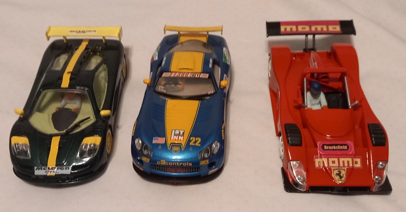

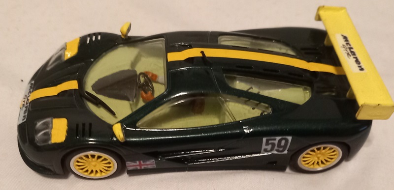

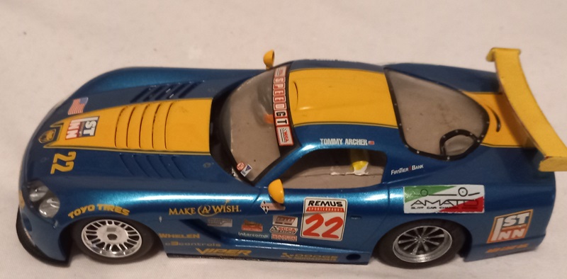

My three are all ready.
Track test on Thursday at NERCS to make sure they are slow enough to keep up my reputation.
Revoslot White Kit McLaren F1 GTR
Dodge Viper - Scaley Body, Amato Chassis, Slot it motor.
Revoslot White Kit Ferrari 333SP
