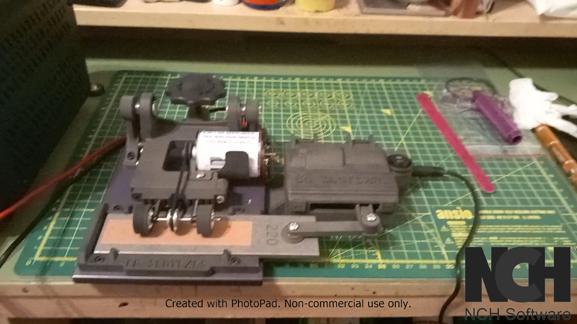

All glass is in place as delivered from SCX.  I have lightweight replacement but I usually only use it where potentially needed.  No B &W chassis on this one as the CG Slotcars 3D chassis kit, Richard Mack chassis and Olifer offer great alternatives.
#14
My new toy
Much better than a Hudy for truing rubber tyres much gentler.
#15
That last post will not have made any sense, I was trying to add a video, but the site wouldn't take it.
My new toy is a CG tyre truer and a Reciprocator attachment.
Much gentler for truing rubber tyres that have a tendency to melt, and you can true wheels/tyres that are an interference fit on an axle.
Have resorted to a photo.
I hadn't come across this before, but I am sure others will have.
Gerry

#16
Nice set up.
(And just for the record, you can true tyres gently with a Hudy if you are gentle with the controls)
Let's go...OFF ROAD!
#17
Some tyres yes, but no matter how gentle you are (I use the Knob Job) some rubber tyres just don't like even the finest grade HUdy cylinder.
Gerry
[+] 1 member Likes Makem's post

There is probably a whole thread there...but even Greg's World Wide Chat participants struggled to come up with any simple guidance with regards to tyre truing.

#19
Although this should really be in a new thread because it'll never get found again as it's in a car build thread and don't know why you decided to post it here but I've recently been using my Hudy at 2V and under 1.9A for soft tyres and 3.5V@ 2A for original Ultragrips.
#20
Good question I suppose I could move it elsewhere
