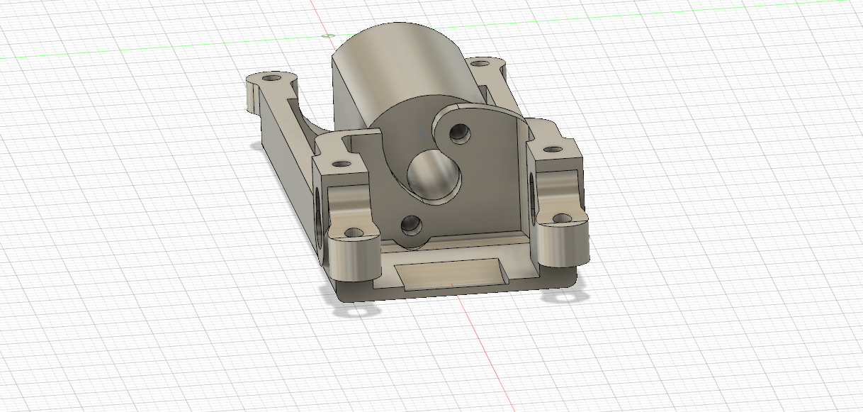

(8th-Jul-22, 08:27 AM)Kevan Wrote: (8th-Jul-22, 06:15 AM)Savage GT Wrote: Hi Kevan, what offset range does the pod cover ?
I don't actually know, my guess is 1.5mm but I'll fire up the CAD and measure...
'Offset' with motor fully down, axle fully up is 1.25mm, It's more than sufficient for the car it's fitted in and the adjustable height worked perfectly to raise the axle to lose excess ground clearance.
Posts: 4,528
Threads: 147
Likes Given: 4,215
I've quickly tweaked the offset slot and it's now 1.5mm

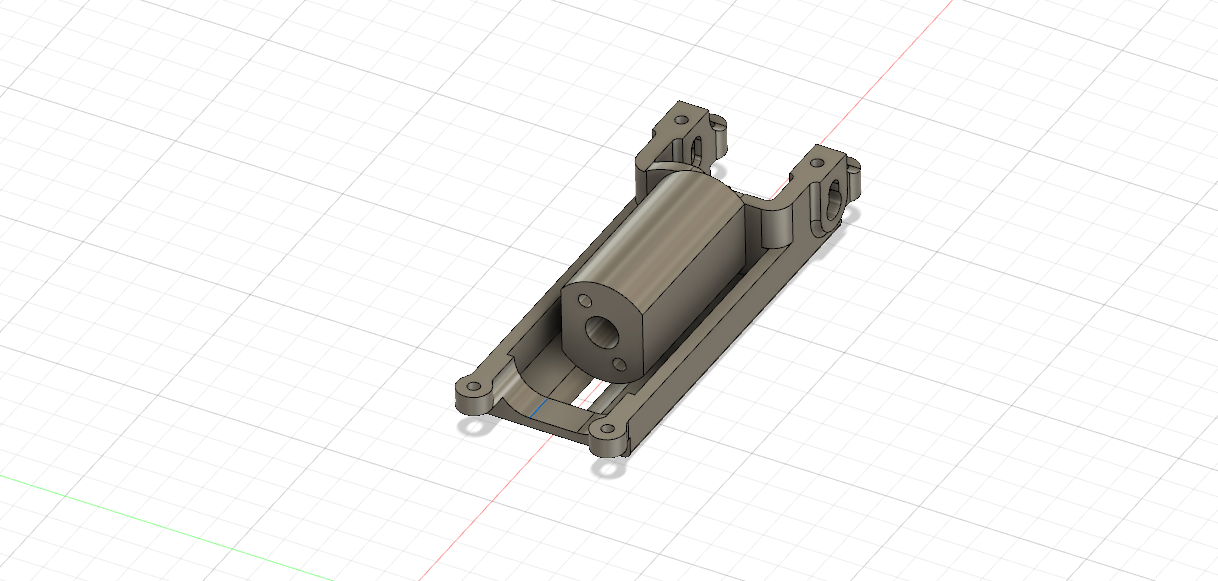

a slim can adaptor for a slot.it type inline pod would be useful
that way you would have your 3 inline pod types , one for each motor
and adaptors for each motor type to suit the original slot.it inline pod
best of both worlds
are you up for the challenge Kevan ?
Kev
Posts: 4,528
Threads: 147
Likes Given: 4,215
I made one last year, the problem is the fixing screws.

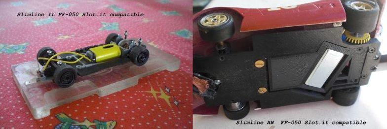

(9th-Jul-22, 06:30 AM)OXO cube Wrote: a slim can adaptor for a slot.it type inline pod would be useful
best of both worlds
Is this you are looking for?
Posts: 285
Threads: 53
Likes Received: 402 in 177 posts
Likes Given: 39
I make them both,they accept Slot.it spherical bushing and have adjustable ride height
