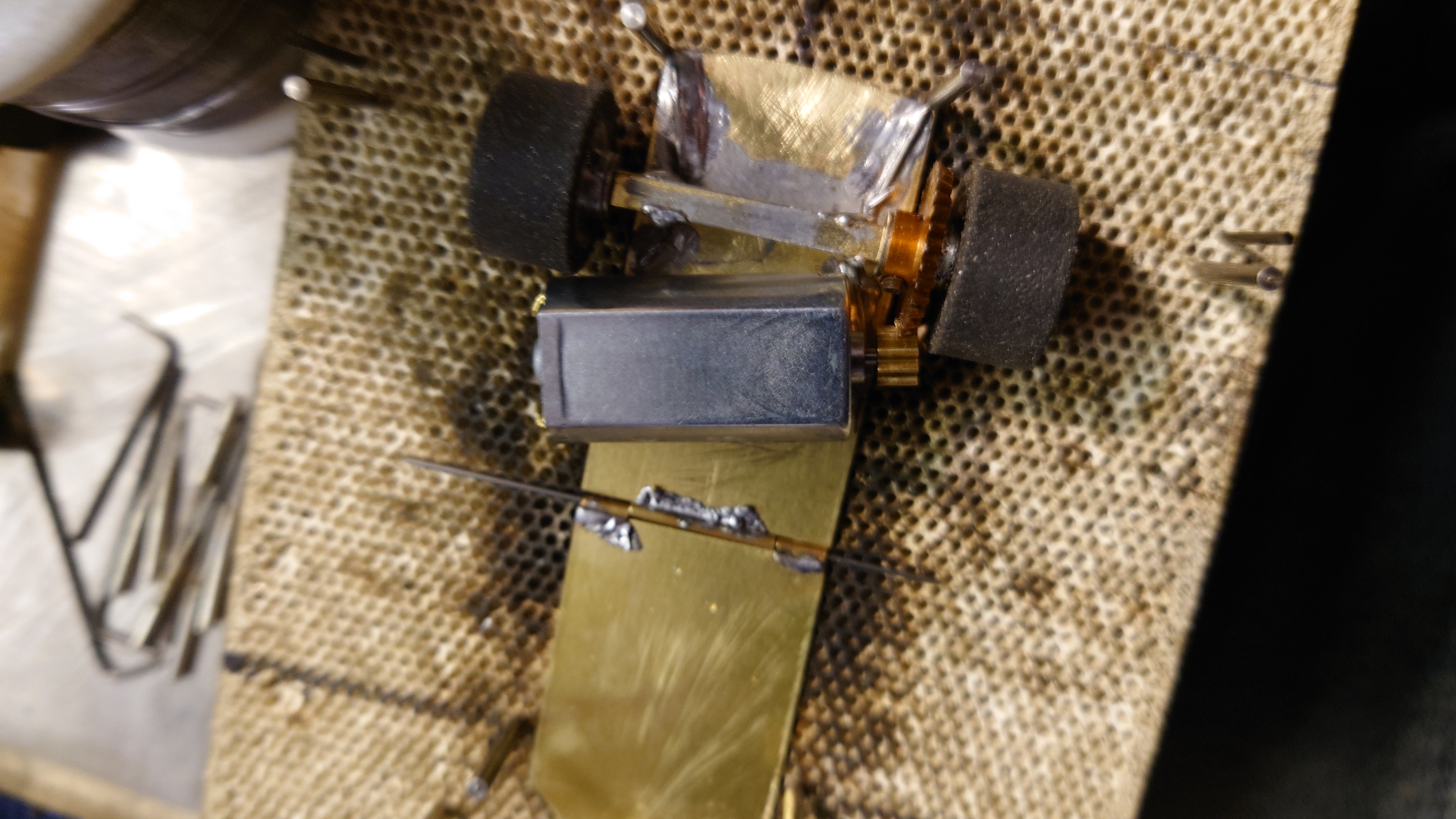

I need to get this monkey off my back, for far too long I've put off making a brass chassis for a Mini that's not inline.
So decided to make a new one rather than modify a current inline one.
This will be a first for me, slimline anglewinder with the added restriction of 50mm max width across the tyres (our club rules for small cars allows 54mm).
This is the bare bones so far with some decisions to be made regarding mounting the motor and side pans.
