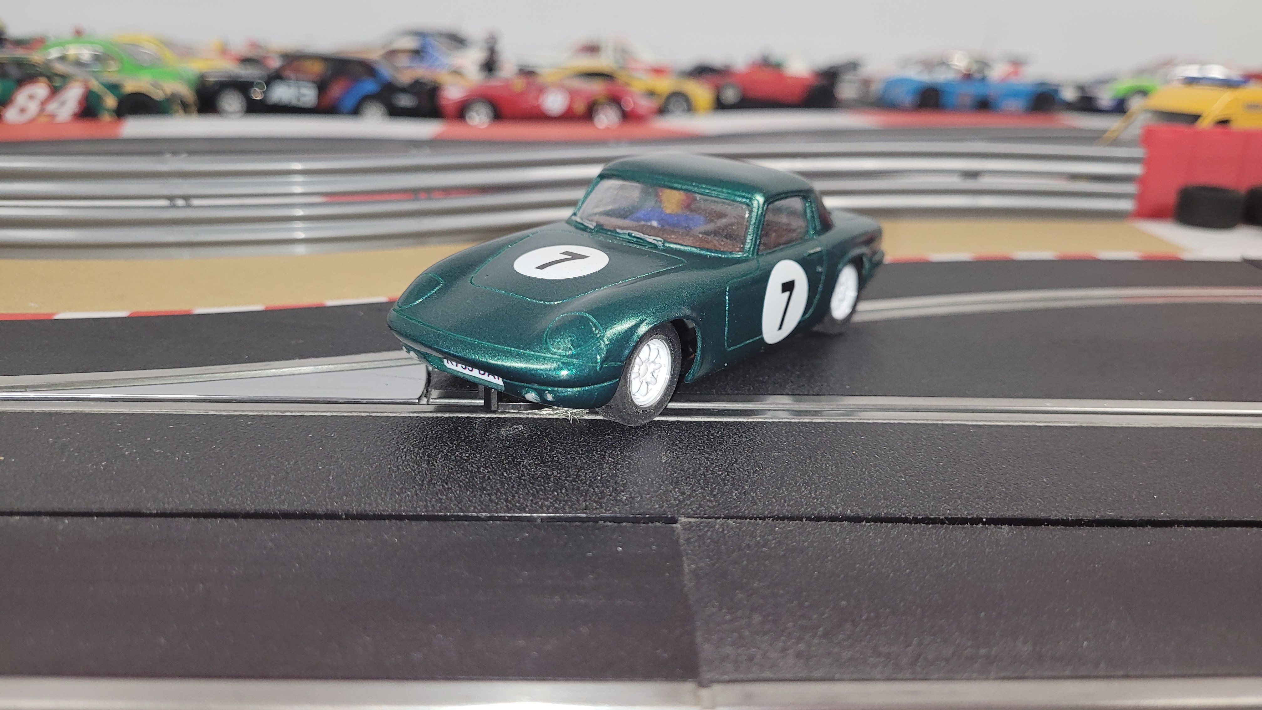

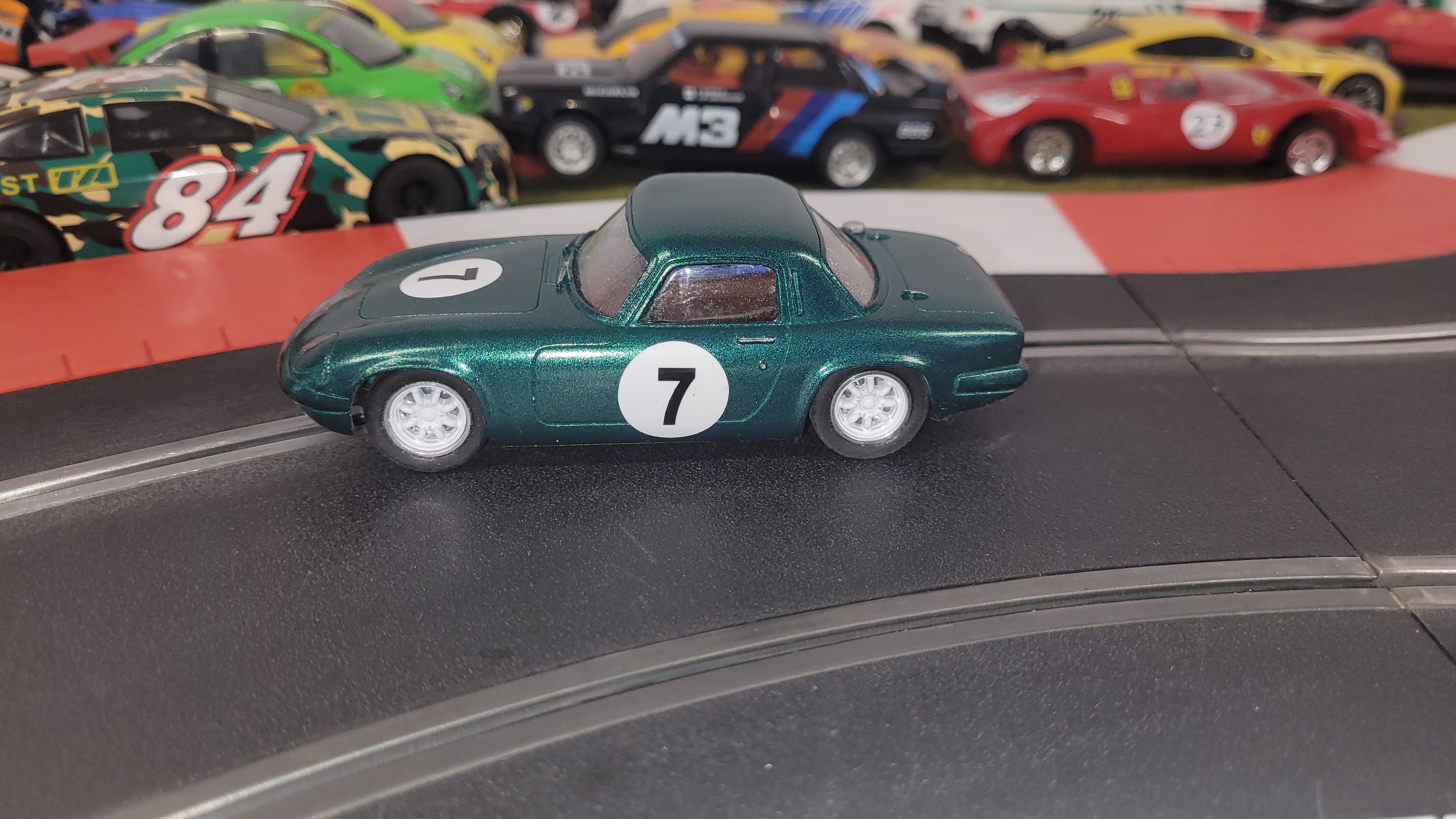

finally got around to building this little George Turner Lotus Elan , i received as a prize from one of Graham's proxies couple years ago
PCS wheels , tyres and minilite resin inserts , paint is what i had laying around but turned out real nice imo
the supplied interior and glazing were a very nice fit

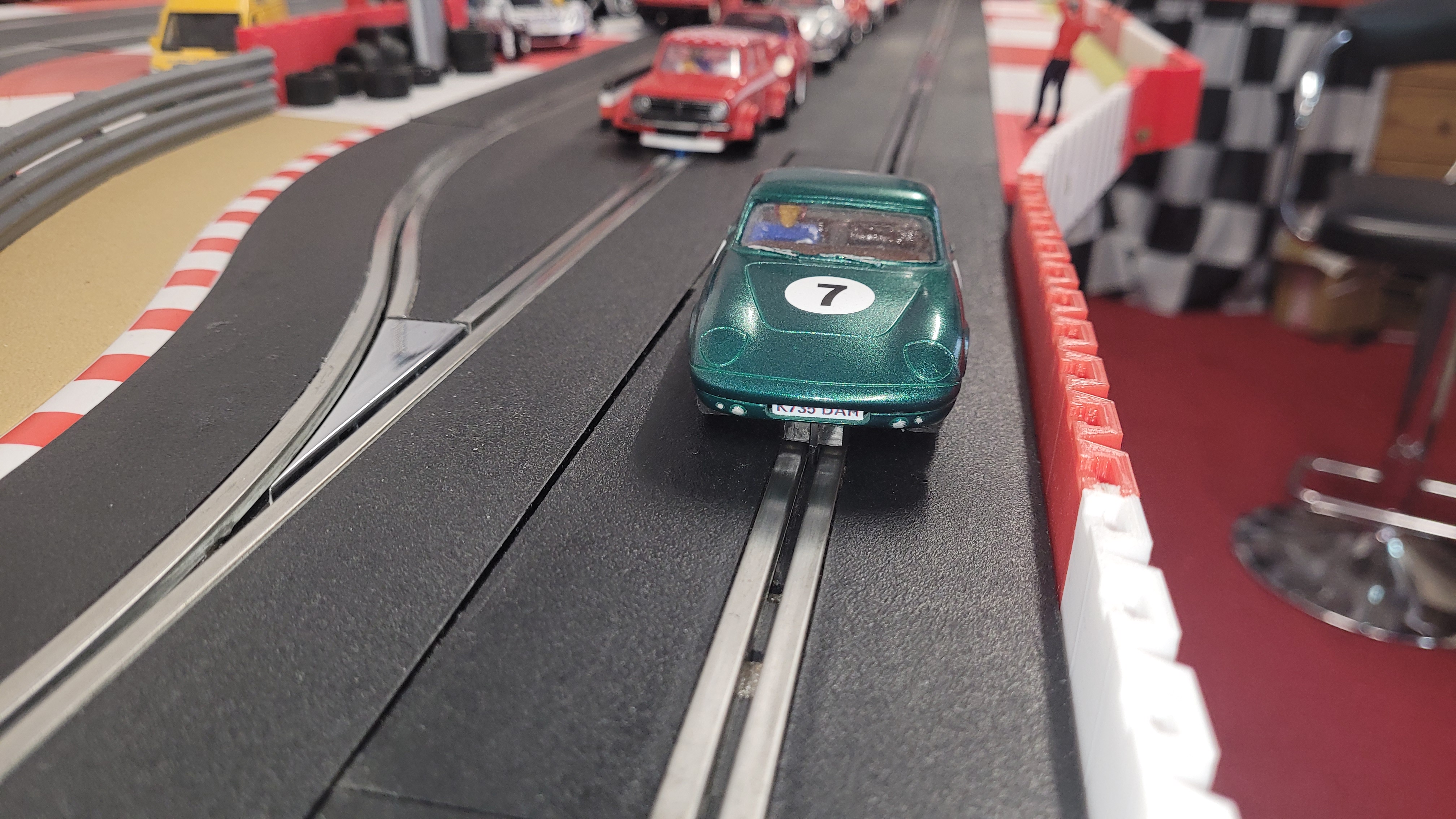

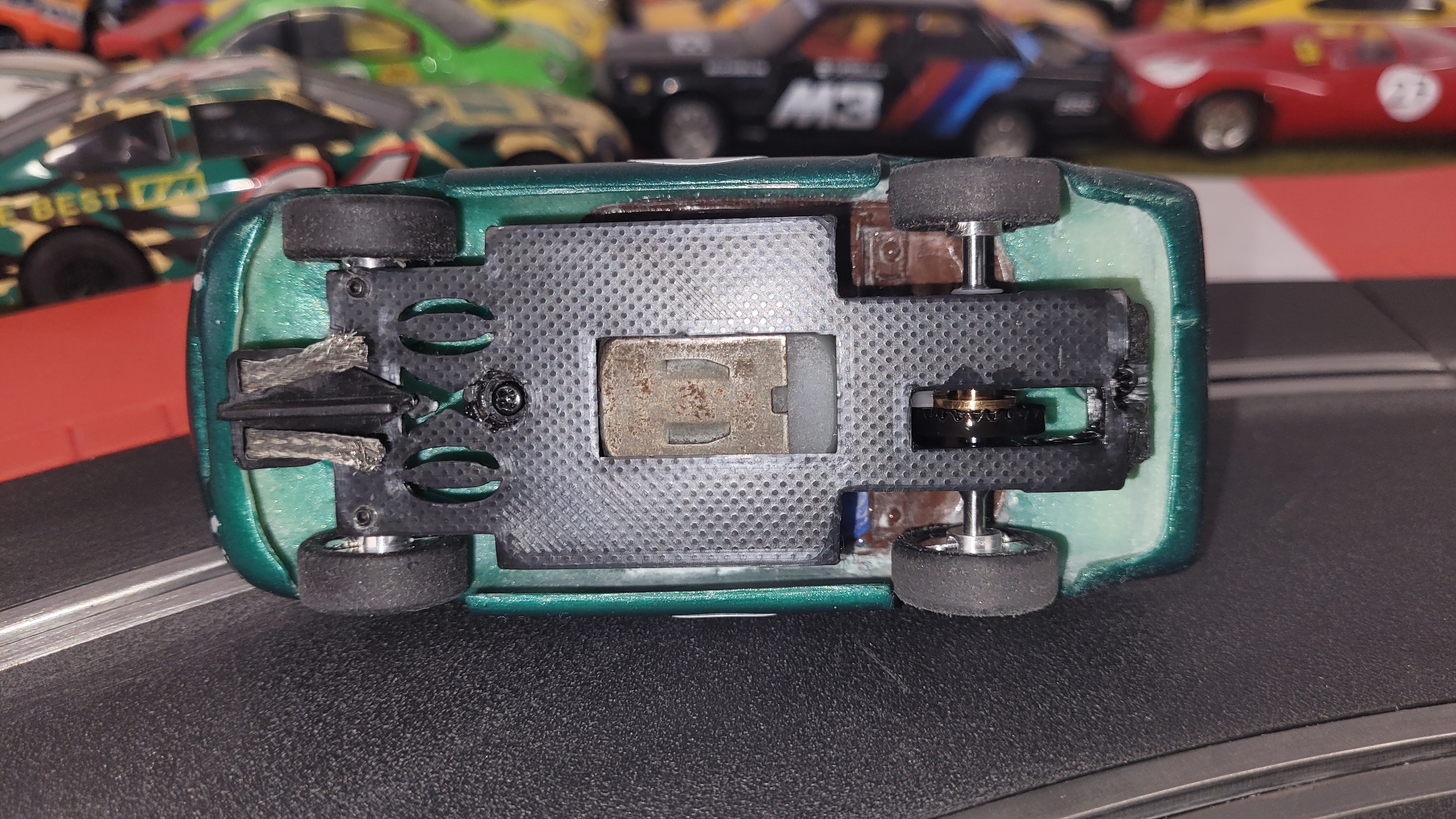

the stance of the car using the supplied resin chassis was awful , i 3DP'd my own chassis and that transformed the stance , fixed the front axle wobble and lateral movement , guide is an old scally guide , slot.it 9/27 gearing
but lowering the stance meant that the old 15k s-can motor i used was a very very snug fit , runs well enough , but body float is Zero!
obviously the reason for the supplied chassis higher stance
will have to redesign the chassis for either a slim can or a flat 6
which as a bonus should be easy to adapt for a little Honda S600 kit I've had laying around for ever
