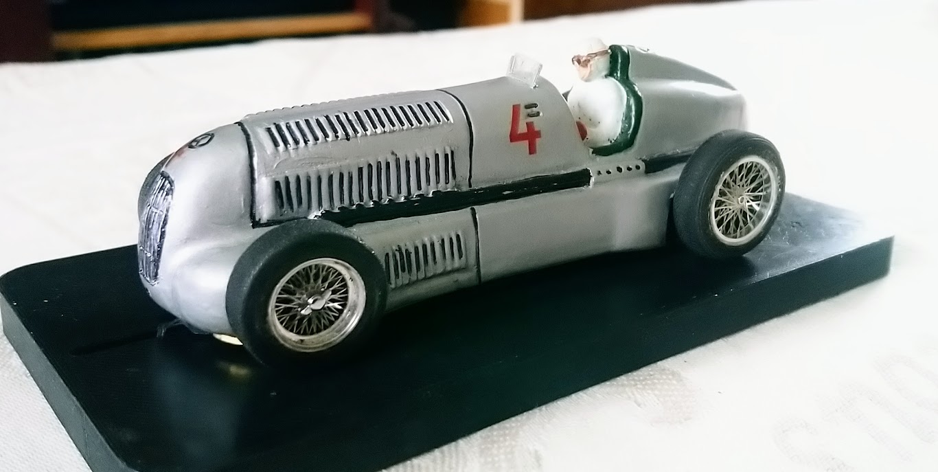

A couple of pre-war GP cars I've re-chassied, both were the late Mike Dove's cars.
Betta & Classic fibreglass Mercedes W25B.

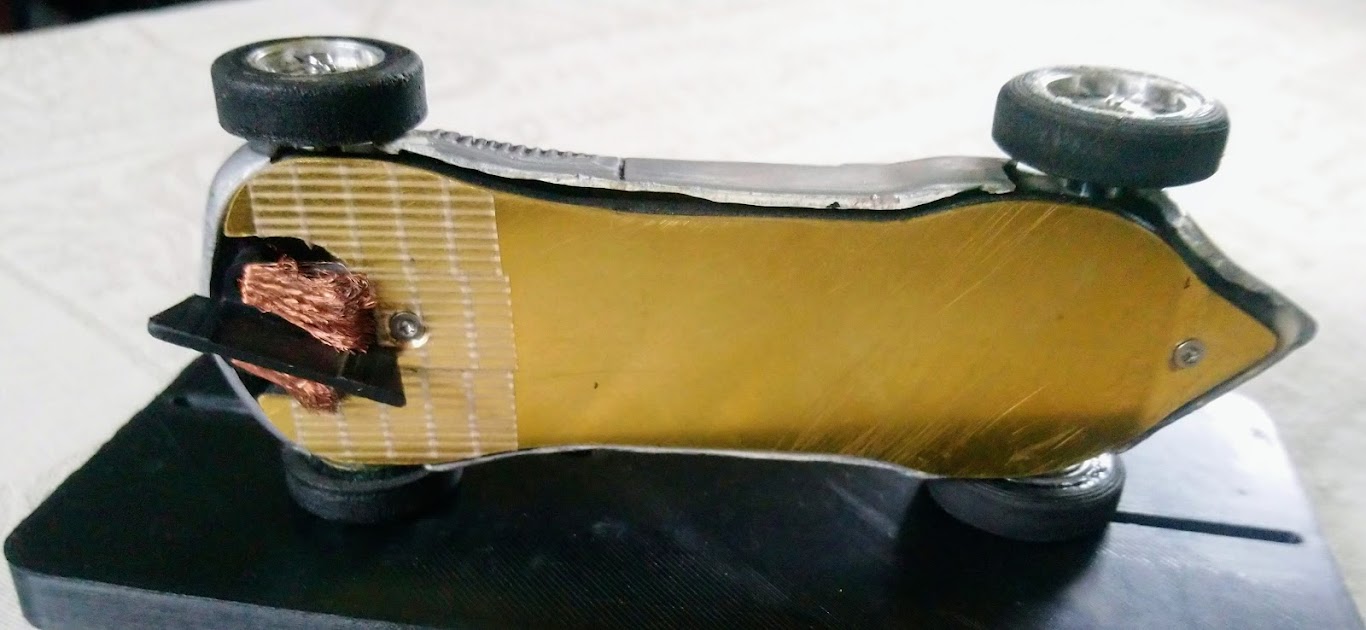

This originally had a brass chassis that sadly didn't work very well and was massively overpowered...so I made a 4 part 3D chassis for it which was better but never really raceable.
In the last week I redesigned the 3D chassis to take a resin 3D printed pod that I also designed and printed.  There was plenty of ground clearance (3mm) so fancied getting the piercing saw out and making a brass plate to hang underneath so some of the old and some of the new.  There's still 2mm ground clearance which complies with CSCRA rules for the era.
This has a SlotIt 21k boxer motor, nice and smooth.
Front and rear axle height can be adjusted with screws before fixing in place with a dab of glue.

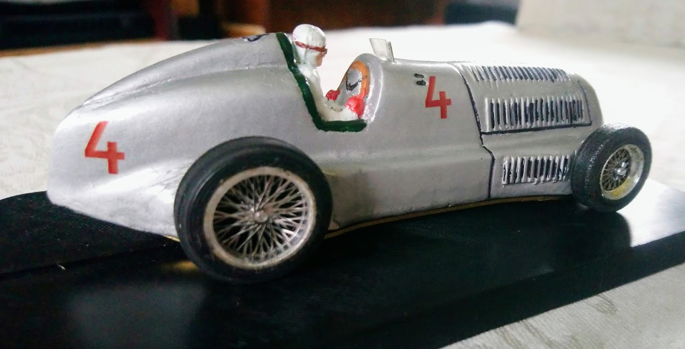

I must admit I don't like the front wheels on this, they look too small in diameter and will change them some time in the future.
...first track test will be on Thurs night (it's Grand Prix + Prewing F1 this week)
