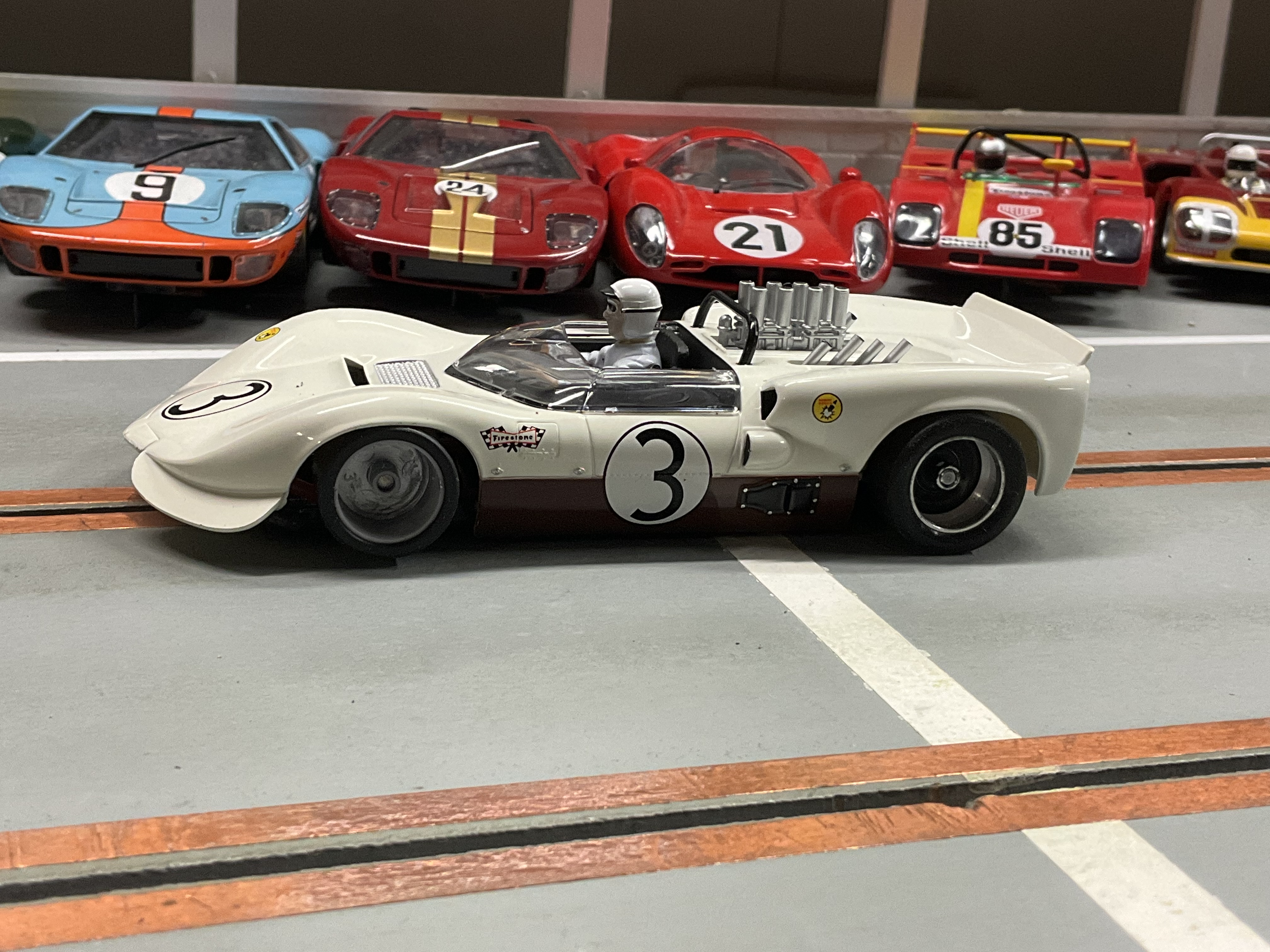

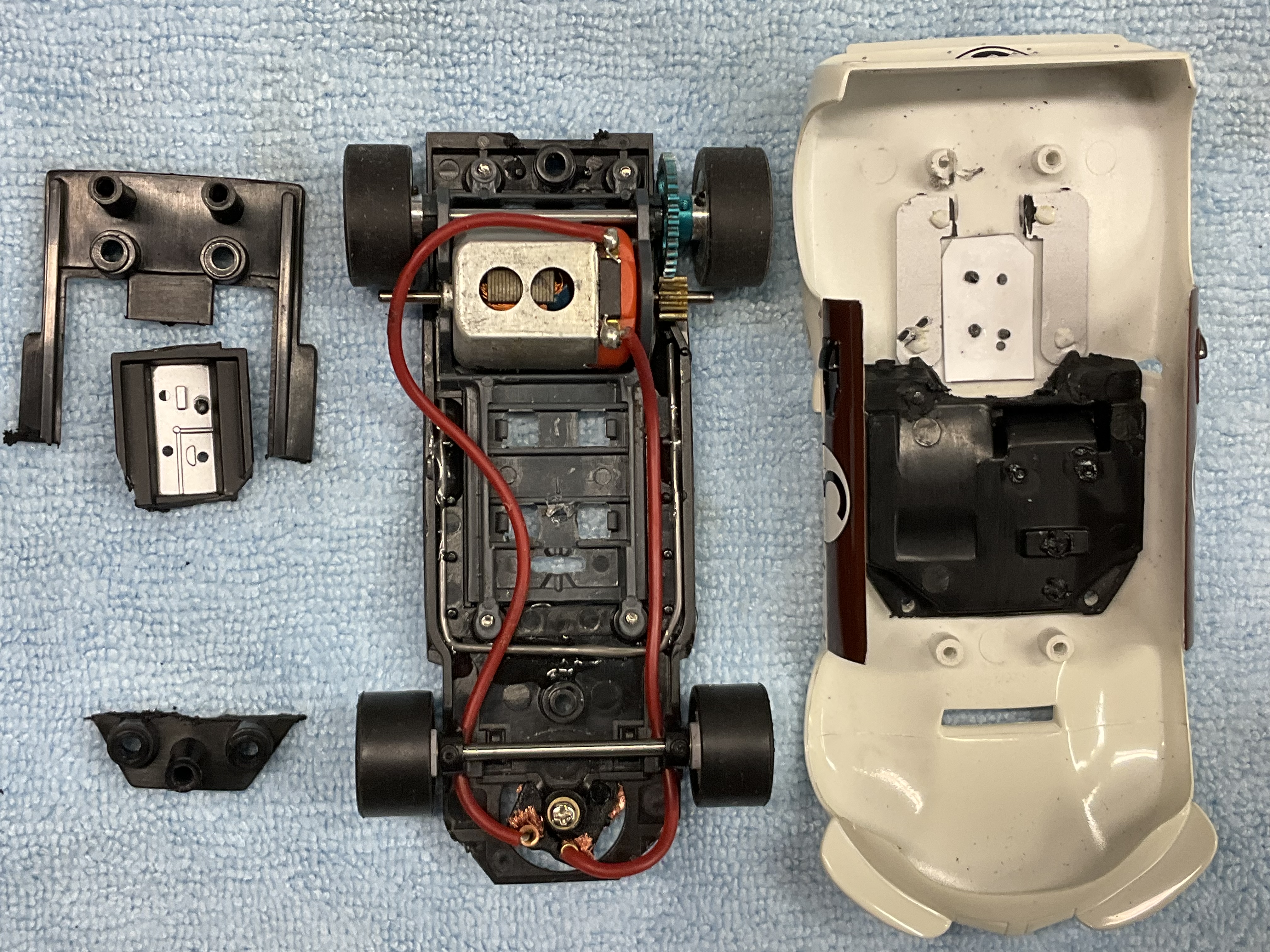

The slot.it chassis for the Alpha Romeo 33/3 is a perfect fit for the MRRC Chaparral 2C body. Needed to trim some of the interior and move the intakes up a bit for clearance. The sides of the chassis had to be trimmed so a U-shaped piece of piano wire was epoxied in place to strengthen it. The stock slot.it wheels make the rear track a couple mm too wide so hubless CB designs wheels are on order as are proper inserts. I will probably end up changing the motor and pod as this one is a little old and tired.

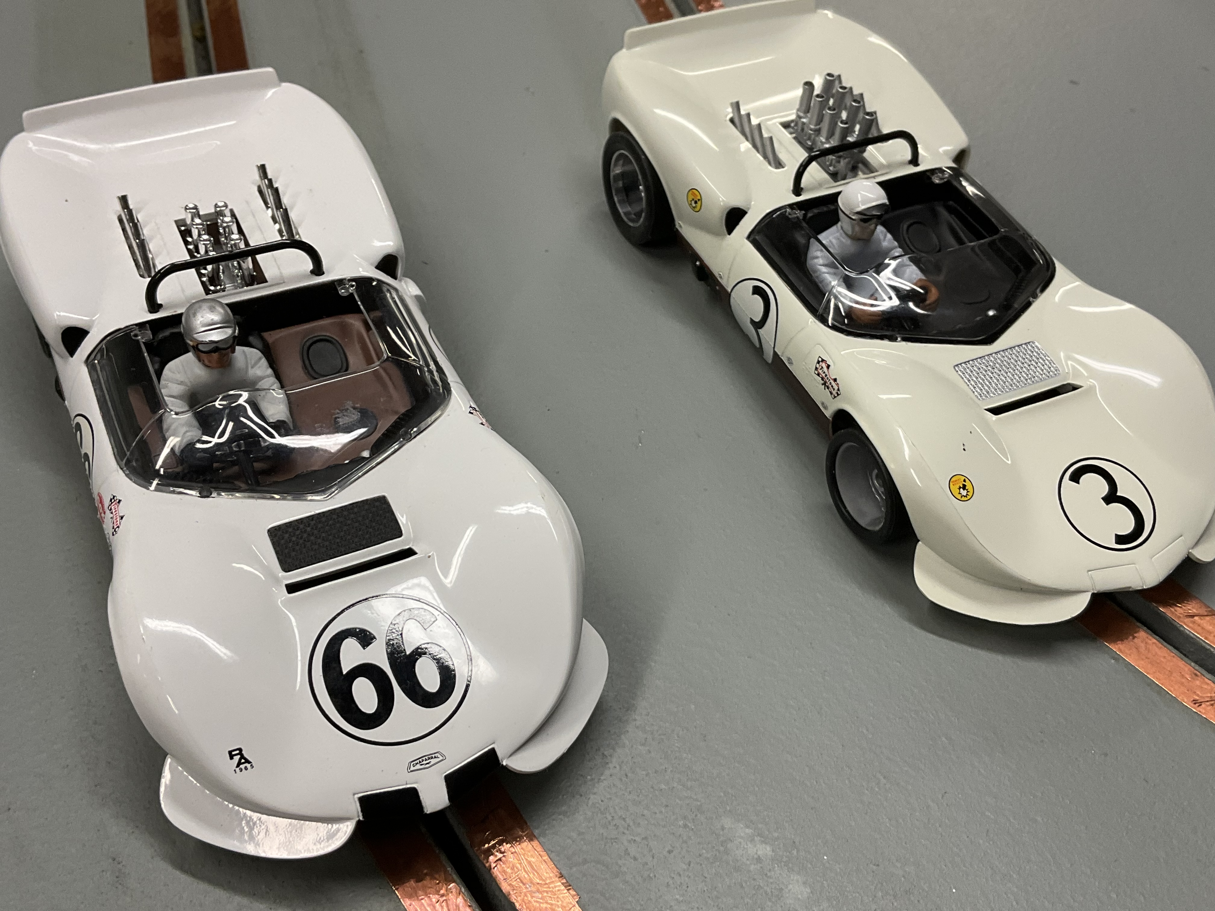

Alan Smith at 132SlotCar in the US has these finished bodies and some 2F ones for sale. Pictured next to my RTR MRRC car.
