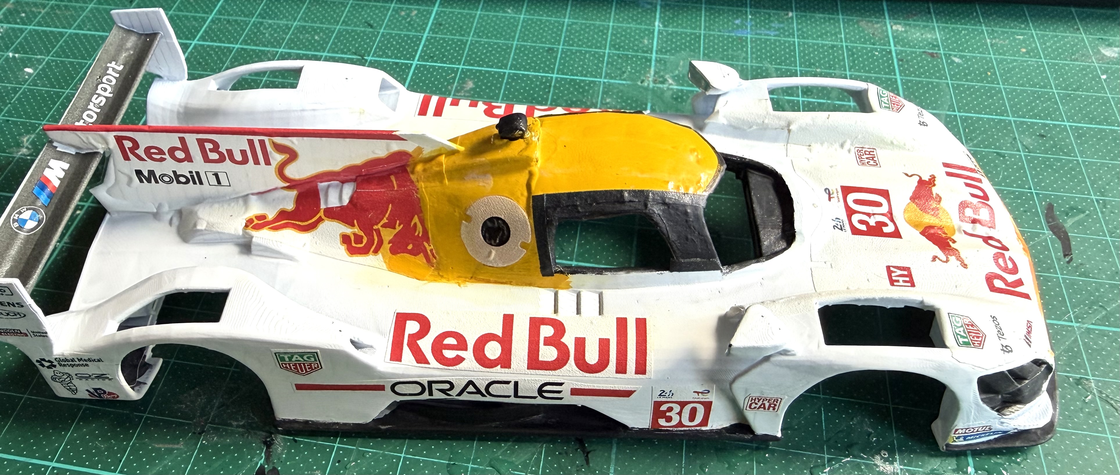

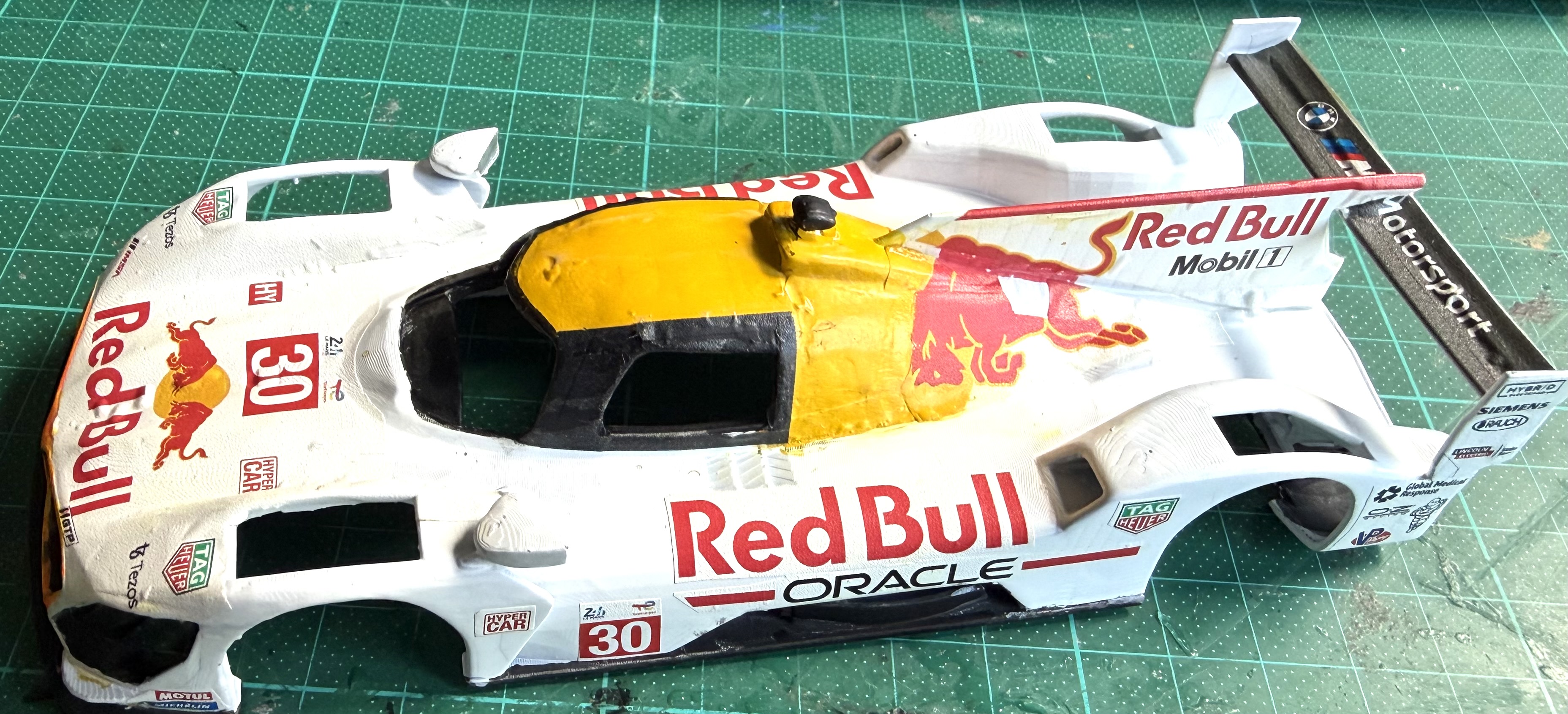

11th-Sep-26, 11:54 AM
Busy times at work has kept me away from the club for a while, hoping to get back for a race day soon.
Meanwhile after seeing a post of someone making replacement body panels on their cars for a diorama from foil so they could show damage, I thought it would be good if you could show similar damage on a slot car. Originally I had thought about similarly using foil panels, but along the way I also thought the same forms used to make the foil panels can also be used in the vacu-former.
This will not show damage, but does make the body lighter and can maybe permit some more changes.
Not sure where exactly I am going to end up with this yet. But next I am going to make up some negatives for the forms so that I can press shapes from different materials.

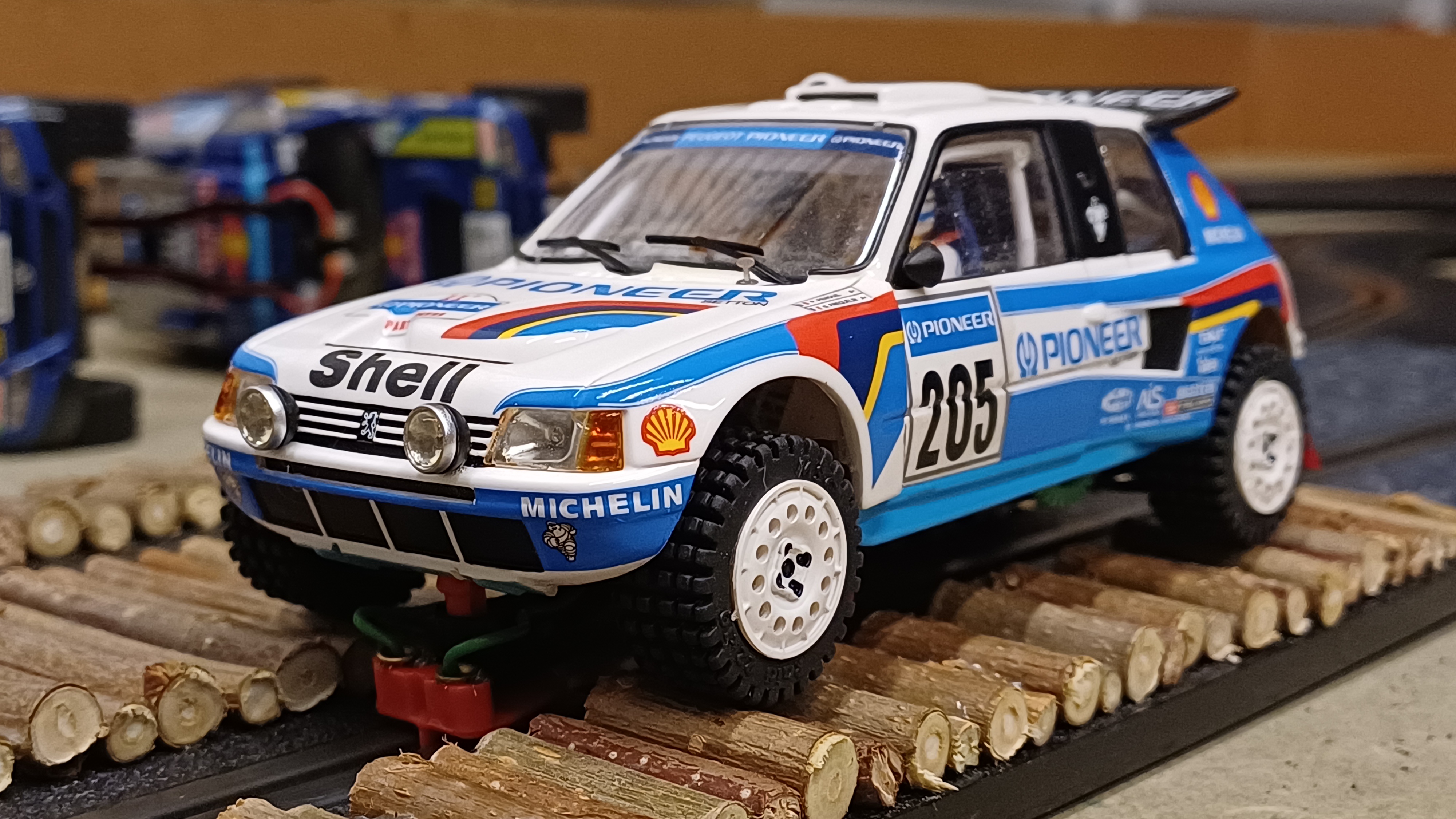

Swapped out a Mitoos chassis for a Scaleauto Dakar one in order to revert this MSC Peugeot 205 to standard spec, and suitable for the C2 FOLM race category.
Found the chassis at Electric Dreams, who have what I would regards as a reasonable £12 postage offer to the UK.
Let's go...OFF ROAD!
