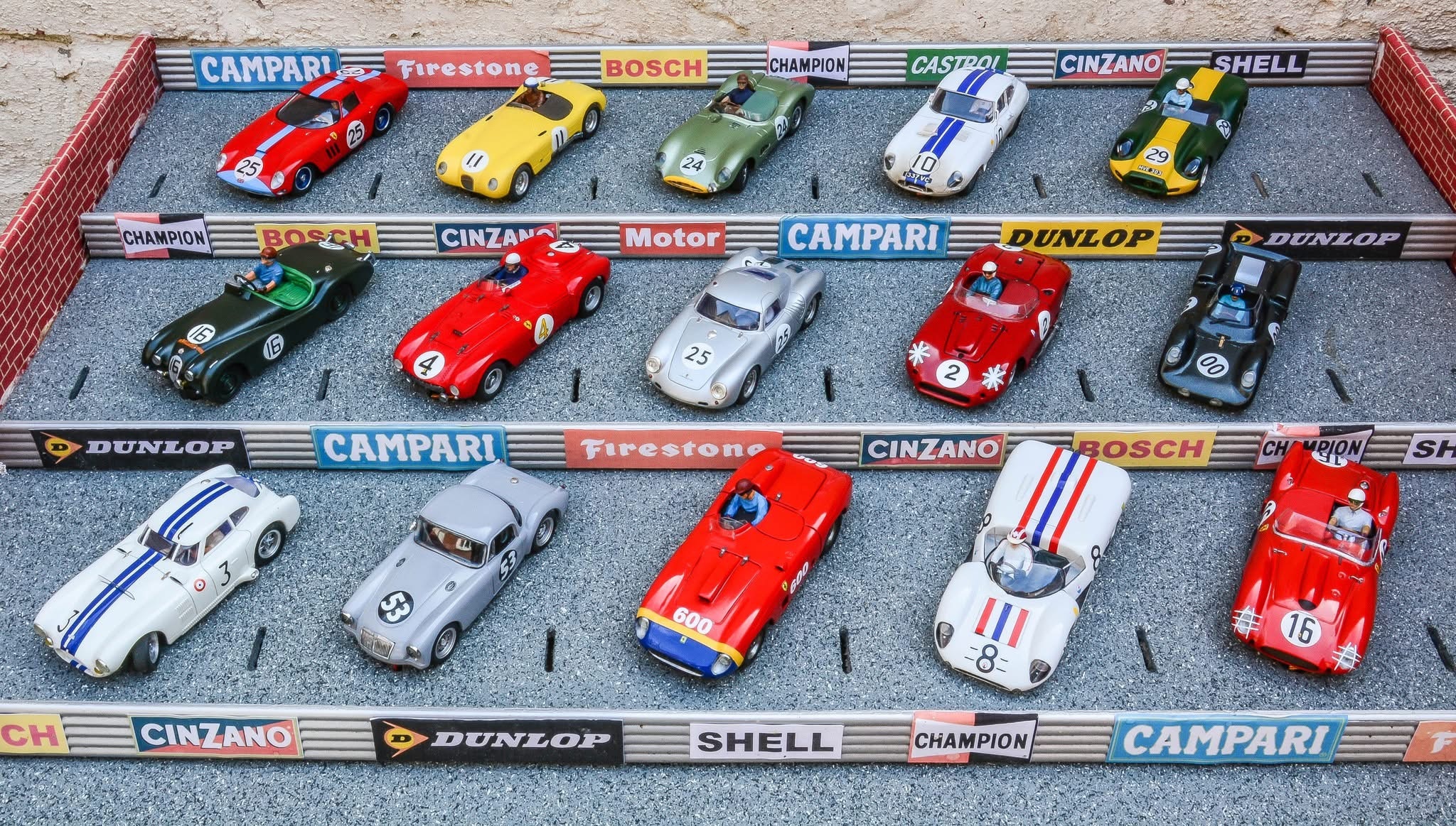

This is a photo of the entrants cars from the 2018 Scratch build proxy
David tells me that he intended to follow up with GP & Touring cars proxies of the same type, but life got in the way.
This makes me think that perhaps it should be a one shot exersize, as you never know whats around the corner.

#3 car has steering... very nice

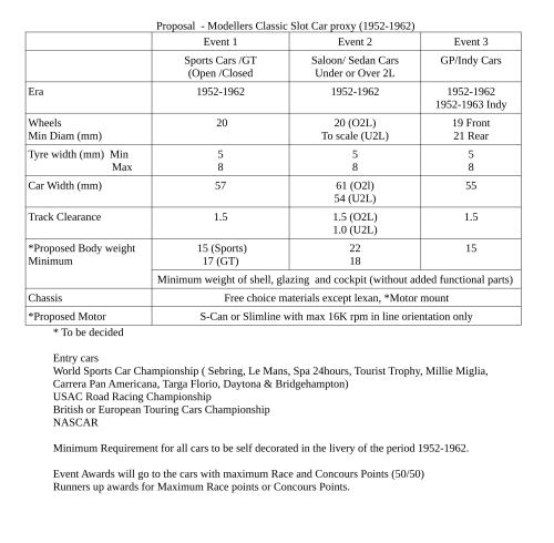

I have widened the scope of the proxy to include RTR cars, as I think something else maybe happening in regard to a "Scratch build" type proxy on facebook (if I read the runes correctly). So I will keep the theme the same as I originally proposed but with less bias towards the modelling side, although there will be the usual Concours Award or in this case perhaps Awards for each Event depending on the entries we might receive.
[attachment=44849]
I have settled on Max 18k rpm motors as I think it offers a wider available choice, but I think we might ask the participating tracks to run at 10volts to keep these cars in the slot as much as possible.
(This post was last modified: 22nd-Nov-25, 10:16 AM by
