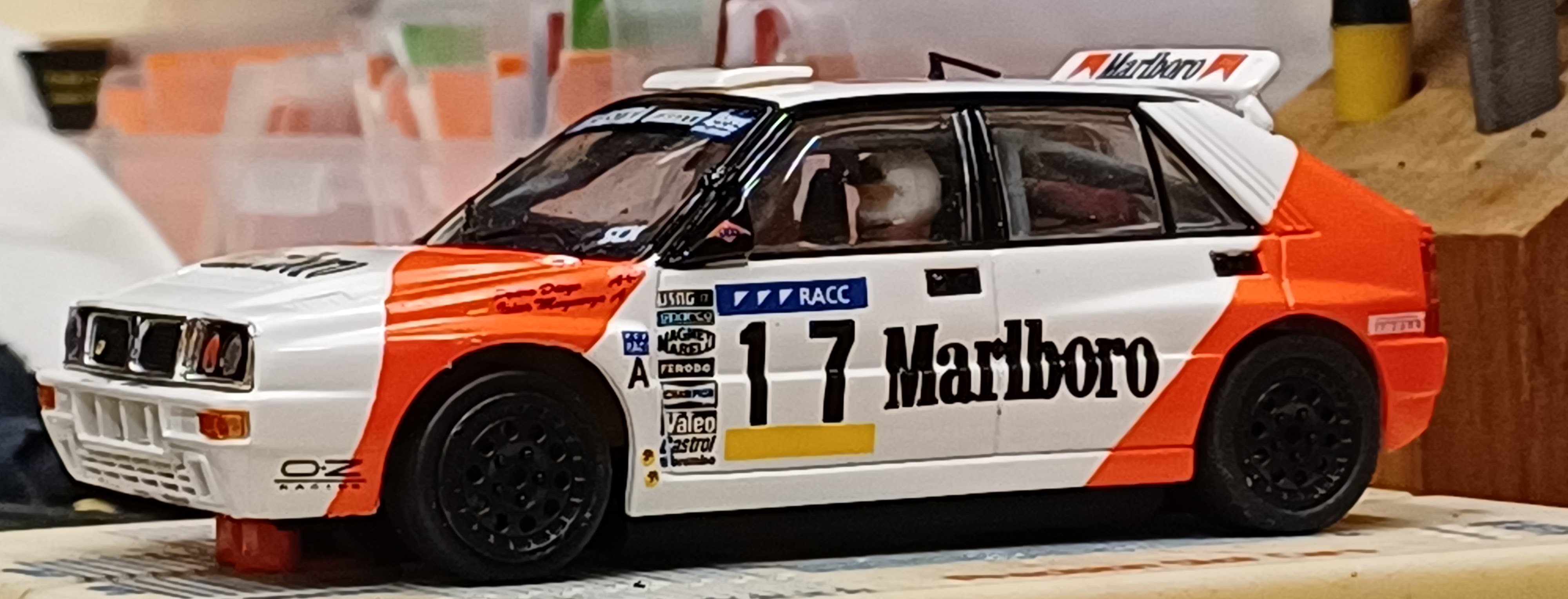

Lots of benchwork here now that the nights are drawing in.
Bought this SCX Integrale because of the Marlboro livery and hoped it would run as good as it looked...sadly not. But it gave me the perfect opportunity to re-build it into something hopefully more competitive for next year's Worthing Rally Stages. So I have paired the body with an Amato chassis, an SRC M3 motor, and some SRC Delta wheels (black of course), et voila!
First run in a week or so...fingers crossed that it's sorted.

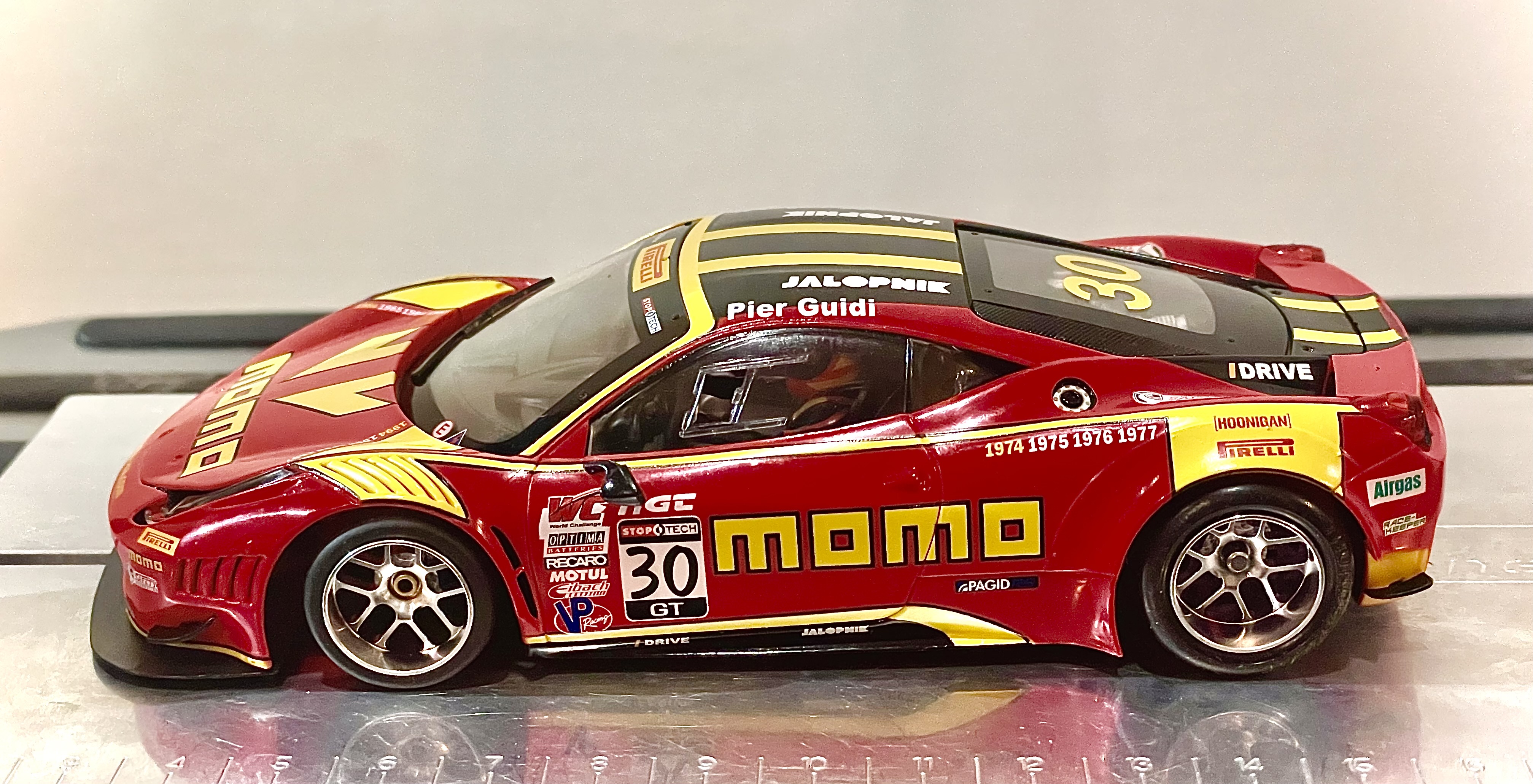

Factory chassis, hard spring on front medium
on sides and soft on rear
Independent front
Slot It spherical bushings
Thunderslot rear tires
SRC Zerogrip front tires
19k NSR motor

(15th-Nov-25, 04:49 AM)Brumos RSR Wrote: Factory chassis, hard spring on front medium
Independent front
19k NSR motor
Those wheels really look good, which brand are they?

(15th-Nov-25, 10:26 AM)Henk Wrote: (15th-Nov-25, 04:49 AM)Brumos RSR Wrote: Factory chassis, hard spring on front medium
Independent front
19k NSR motor
They look like Staffs wheels.
Posts: 195
Threads: 23
Likes Received: 328 in 127 posts
Likes Given: 926
Thanks Ken
I've found them on Pendle's.
