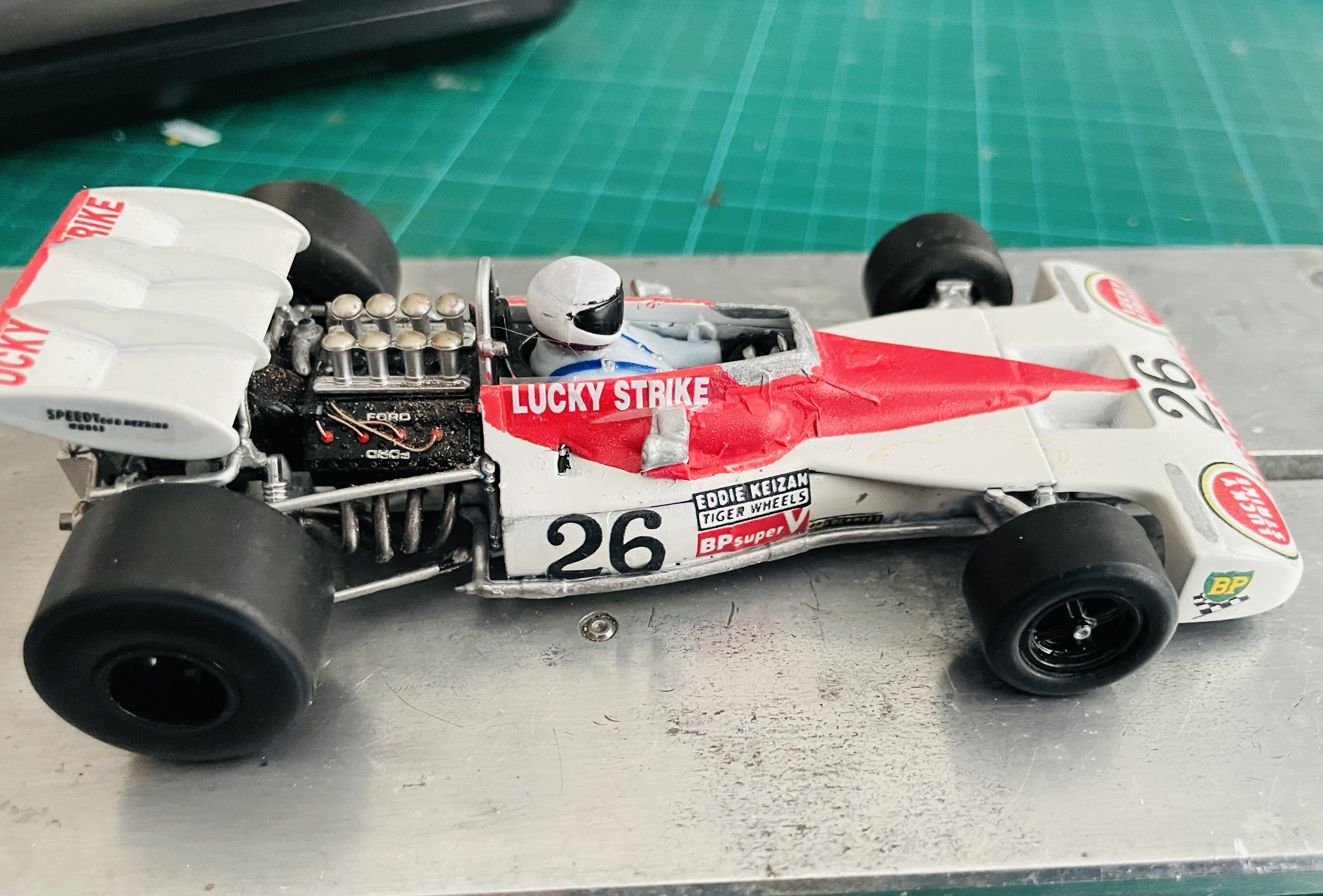

Progress on a John Warren Tr 58 and on a destroyed Scaley Tyrell - this raced in the Locsl SA F1 series of the 70s. Rebuilt completely - sadly missing an airbox

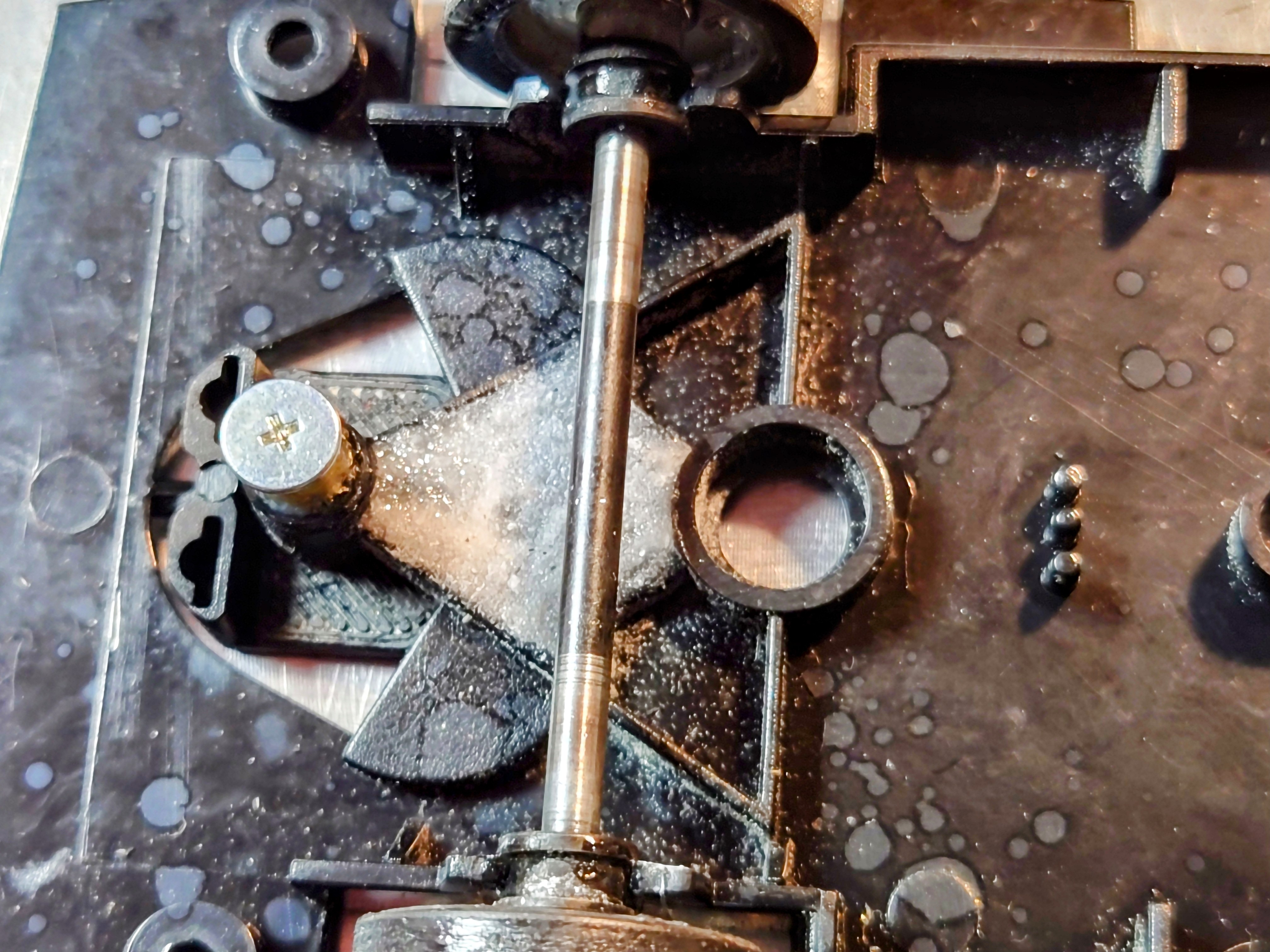

First job, reinforce the guide mount as it was slightly split and flexed too much...superglue & bicarb will fix that!
...then sleeve the guide post hole with 4mm 'thinwall' brass tube.
Next, a job that you should do before going any further, glue/true the tyres.
Then sit the chassis on two Stanley knife blades so the chassis is flat and parallel to the block of steel I use.
Then glue the bearings in...
It's now a nice smooth roller, motor is next... tomorrow

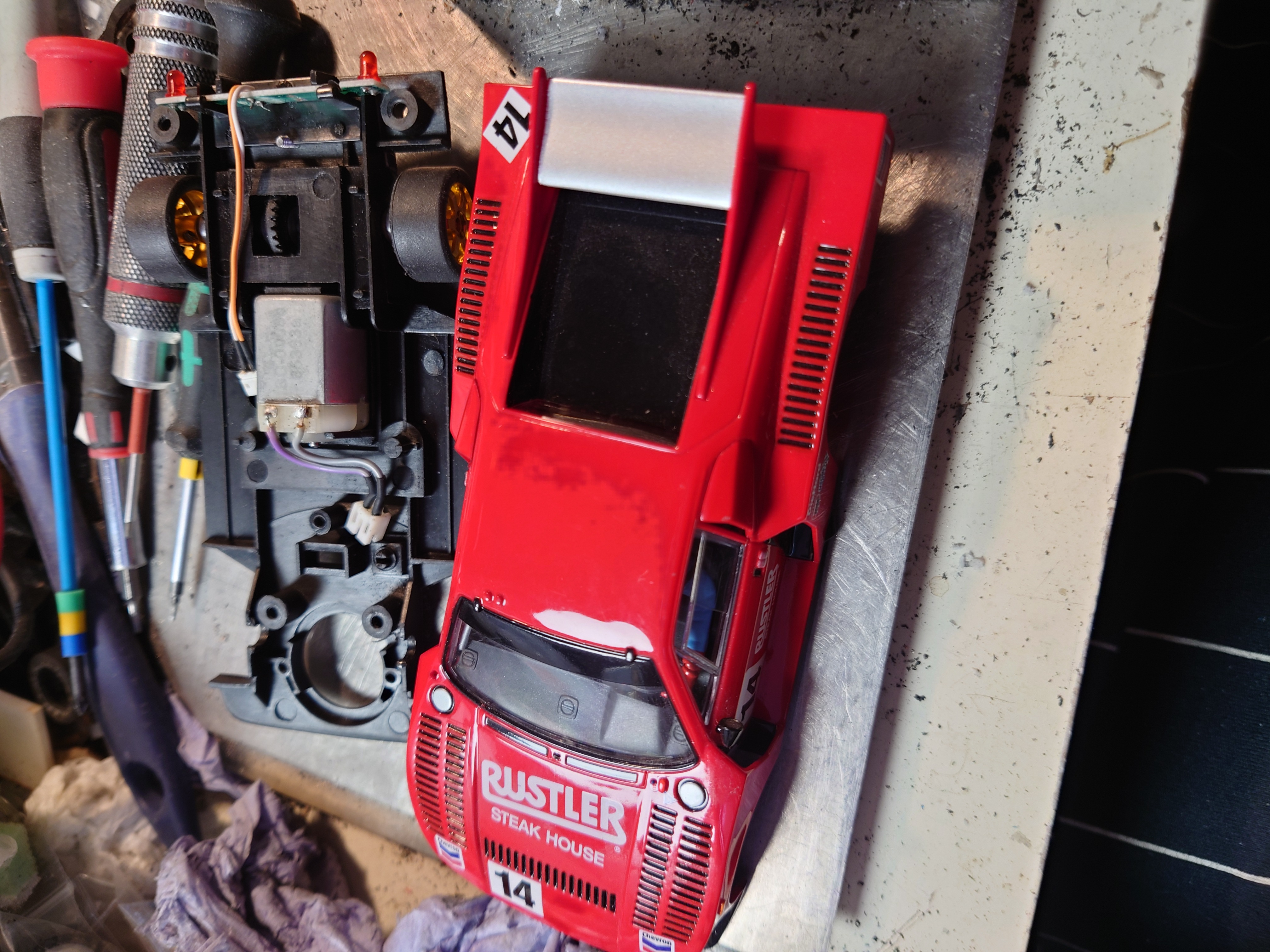

Raced it on Thursday in our Gr.5 racing, managed a 6.19" lap and finished 2nd overall, only beaten by Andy's Gr.5 with a brass chassis and 46k Falcon motor...
...I'll definitely be racing it more regularly.
This weekend it now has a lightweight interior and independently rotating alloy wheels so should be more consistent and slightly faster...love it!
