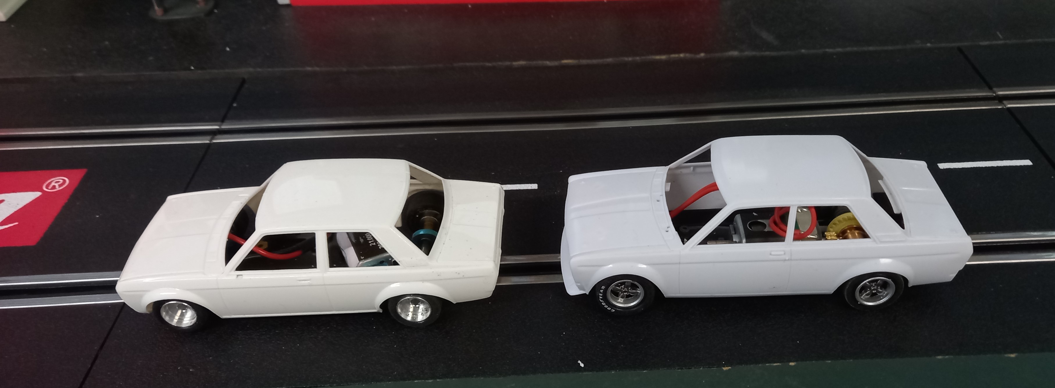

Well I kinda had to buy my own Christmas Slot car presents
Decided to get both the Revoslot & Slot it white kit versions of the Datsun 510, just to see how they compared to each other and my other similar cars.
The slot it body version is longer (with longer wheelbase) and higher than the Revoslot model but the same body width. The wheels are the usual sizes for each brand, so the slot it 15mm diameter ones contrast quite significantly with the Revoslot smaller 11mm ones.
The new wrapper motor on the slot it is quite intriguing, is it the same 23k rpm motor as previously used, but with a wrapper covering, if so why ?
Personally speaking, proportionately I think the Revoslot looks more to scale.

Revo is closest to scale width and wheelbase.
I'd put my money on the SlotIt in a competitive race.

I had a good old test run of both cars, or basically the bodies and chassis without the interiors over the last few days. From the box the slot it Datsun was faster than the Revoslot with original tyres etc by a fair margin.
So I decided to upgrade the motor on the Revoslot to a 35k rpm SRP short can….which made quite a difference and narrowed the running difference with the Slot it quite considerably.
But then I thought to improve the Slot it Datsun by changing the motor to a Flat 6 25k rpm and change the tyres……..now I have the same difference as when I started
I like a challenge so I will see what else I can do in the new year with the Revoslot version.

What is the ground clearance under the motor of the Slot.it Datsun with the car sitting on track ?

The wrapper on the motor is probably to provide some isolation from the rails, as per digital racing regs.
