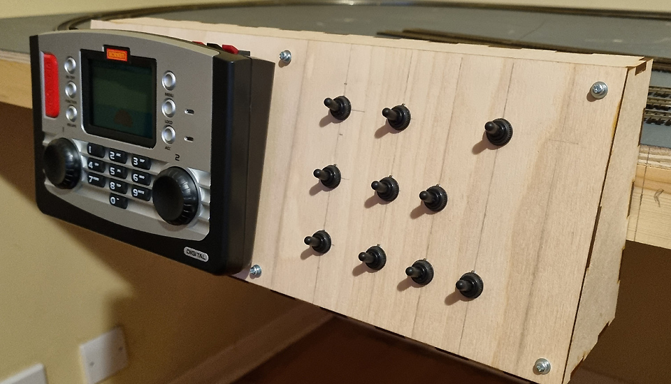

I am nursing another headache and bad mood after my points controller died AGAIN !
I was near completing the final fine adjustments and it decided it wasn't going to play anymore.
So yet more delay, and I have the pleasure of finding which points went on what channel all over again  Angry
On the plus side, the control panel is functionable, although does require finishing.

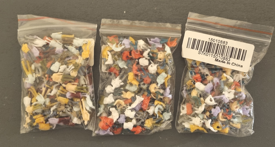

And on the non-plused side, A while back I ordered 100 sitting and 100 standing pre-painted little people from china.
Today they arrived, I got 200 sitting and 100 standing, but half are half painted and the rest are not painted  Tappingfoot

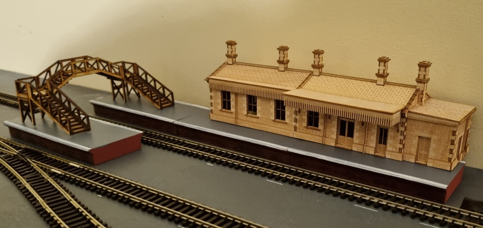

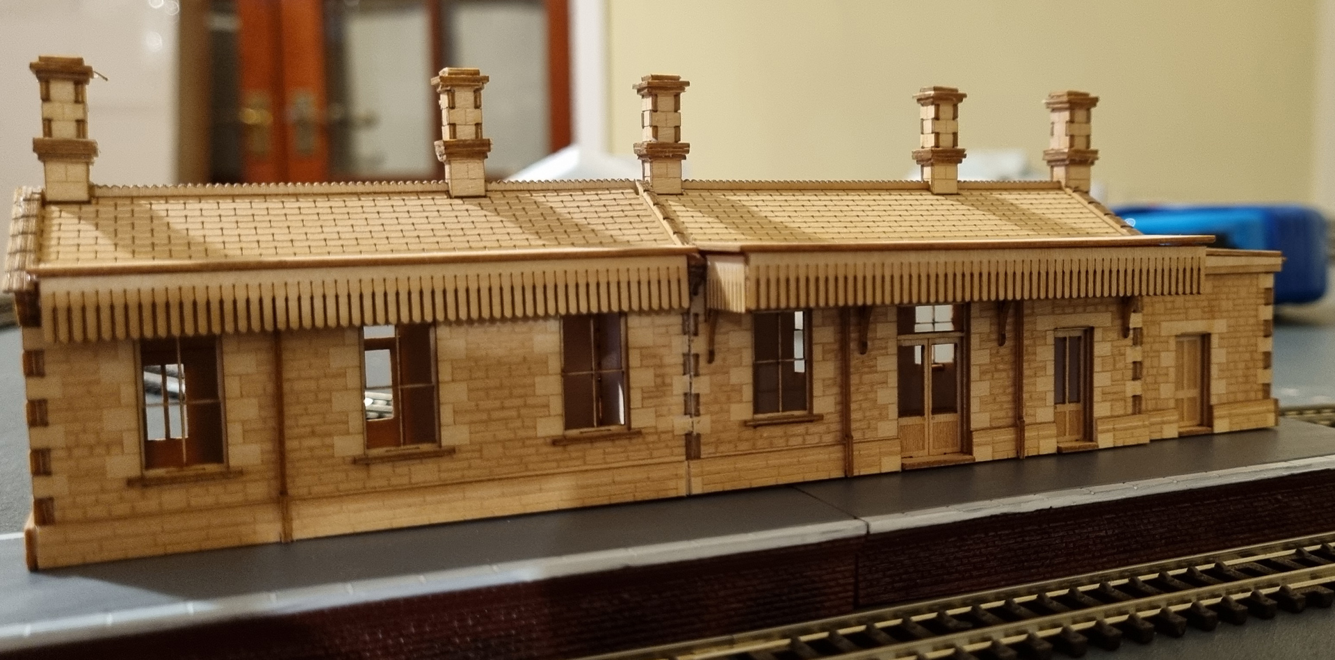

Anyways, as I can't complete the points and therefore full track testing, I decided to build up a couple of laser cut ply kits.
The footbridge looks a litle chunky but it will do until something better comes along. It was a double span, but I only needed a single for my planned platform layout, so I cut'n'shut it !
The Peco station building is made out of two kits, because I wanted a longer one, the kit detail and precision is very impressive IMO, I look forward to making the Peco signal box kit I have.
Obviously everything needs painting and glazing at some point, but that's for another time  Sun

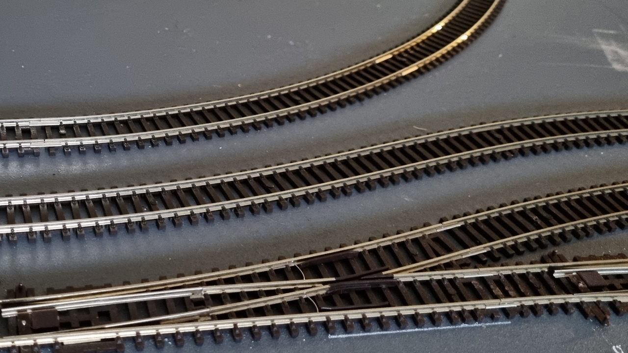

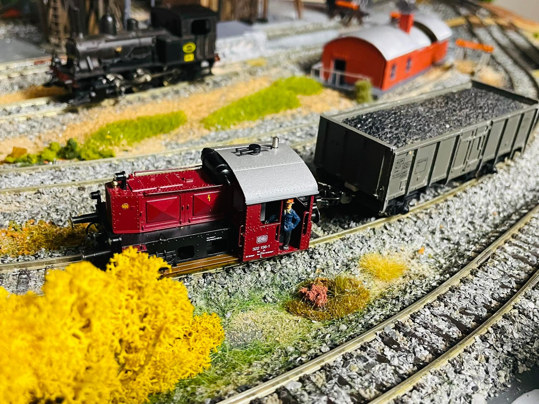

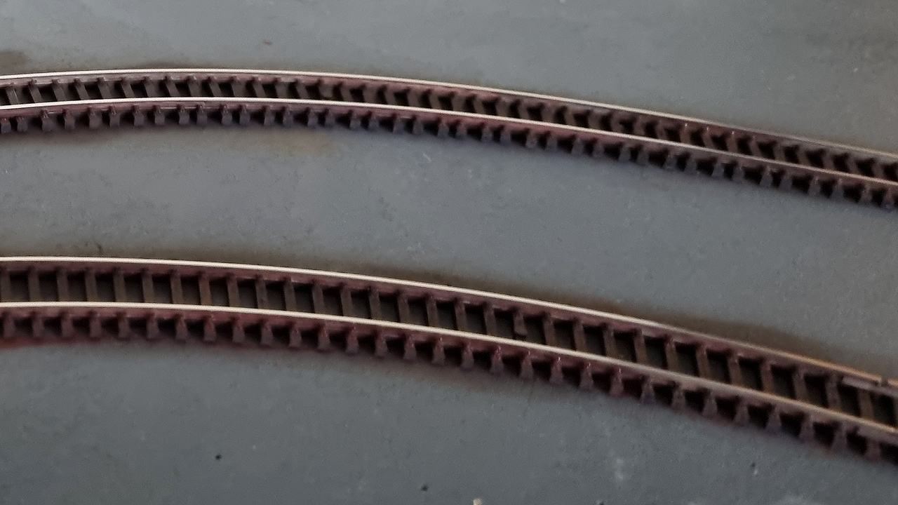

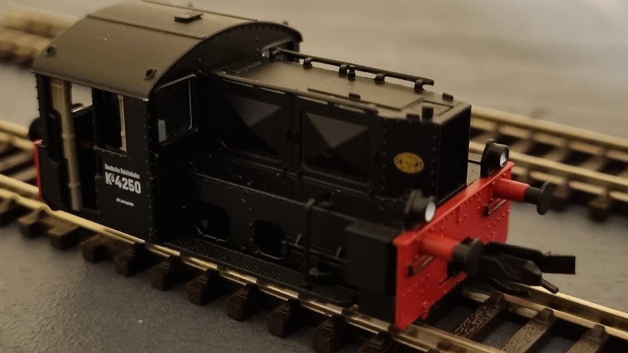

Touch wood, I think I can move forward, servo powered points and track fully tested with a tiny tittle Gerrman shunter (KOF II, smallest wheels, lowest track clearance, shortest wheelbase). Fast and slow speed crossing points no problems.
So this afternoon was spent making my track rust and dirty (well part of it at least).
As it's my first time doing anything like this, I think it turned out OK, once the whole track is done  I will attempt ballast and further weathering.
So the shiny stock track:
And my initial attempt at making a weather worn and rusty effect:

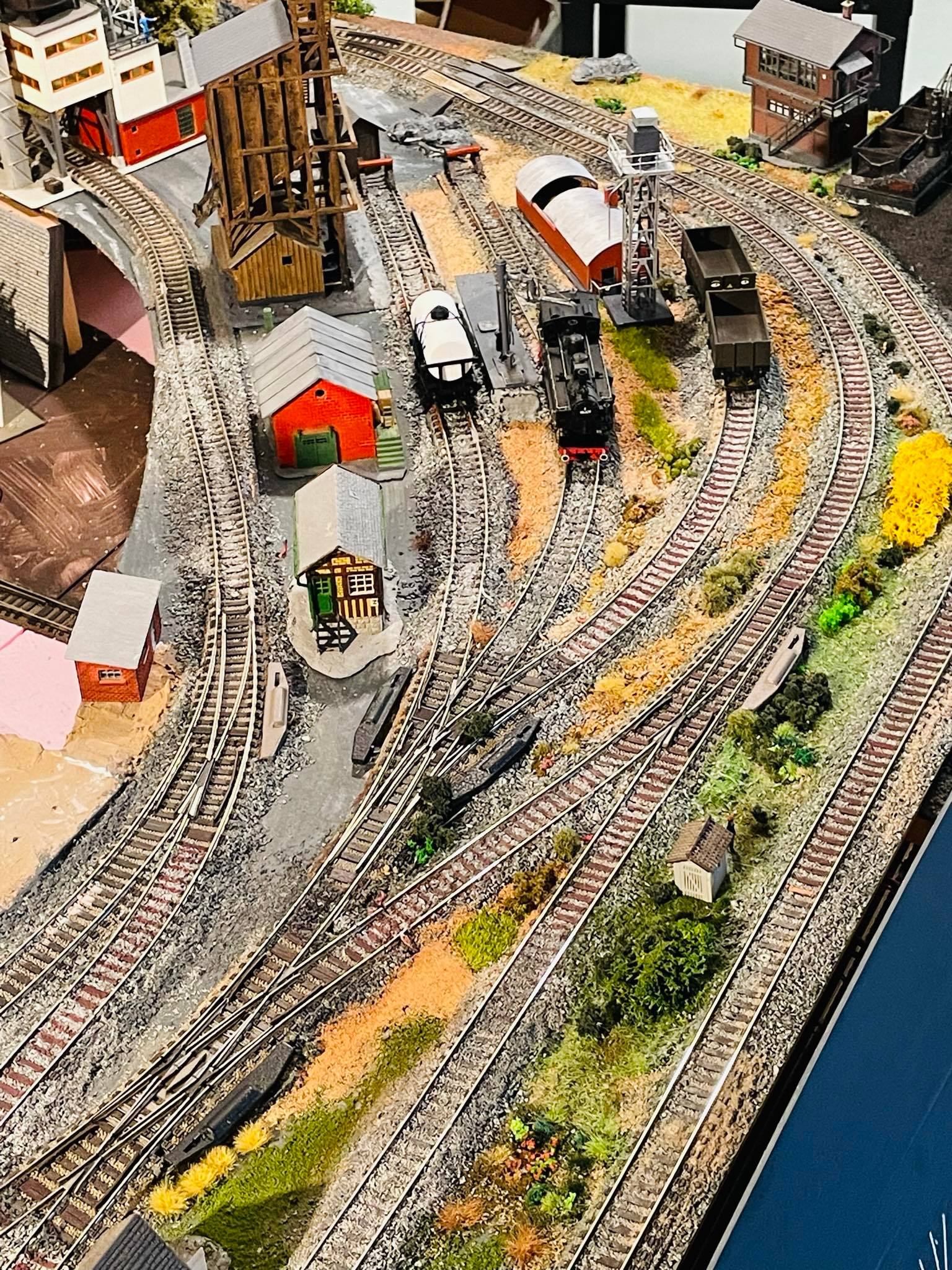

Recently I have spent some time with some ballasting, a lot more to do.
But mostly working on a few of the Peco laser cut kits and a cheapie cardboard kit for terraced housing.
I think a coat of clear is next for the laser kits, then a bit of dirtying !
Next job in between ballasting will be building a plastic factory kit from Auhagen, which needs some cutting and shutting to suit my needs !
This is how it looks when built stock:
[+] 5 members Like Savage GT's post
