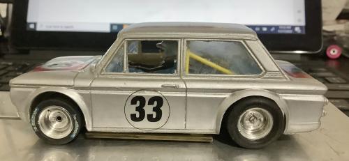

Working on these two for Class A.  I’m not sure if I can shoe horn a navigator in the 904 but it’s just wide enough and with a little more motor it could be a fun car.  If you see a pic with the #33 on it then it’s ready to go.  The Imp is just a cool car to watch on track as it’s it fits in the palm of your hand easily.
[+] 4 members Like Brumos RSR's post
