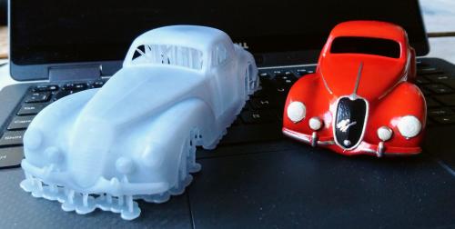

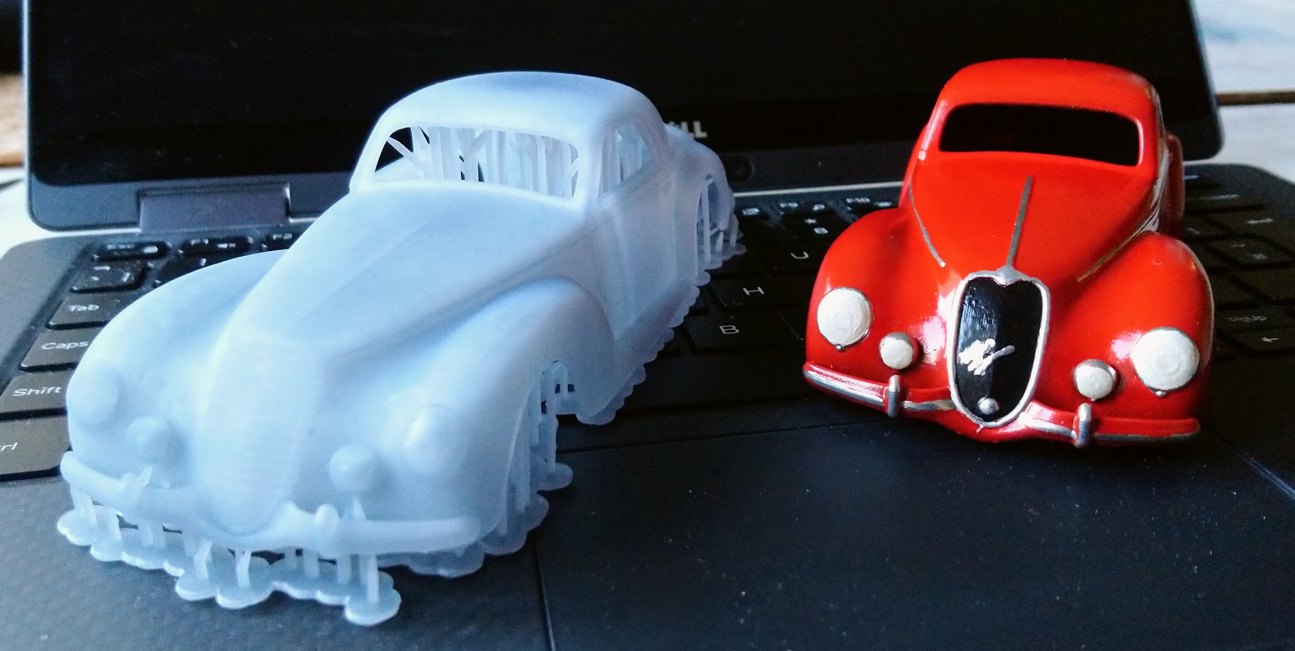

I wish I'd seen this post a couple of hours ago, I printed a Minisprint last night and removed the supports earlier. However, here's an Alfa 6C 2500 I printed a few weeks ago...

Thanks - looks like you don't have a raft just the base for the support.
I will experiment a bit with my settings and see how I go.

A raft is a huge waste of resin for something as small as a slot car body, you'll easily throw more resin away than it took to make the bodyshell.

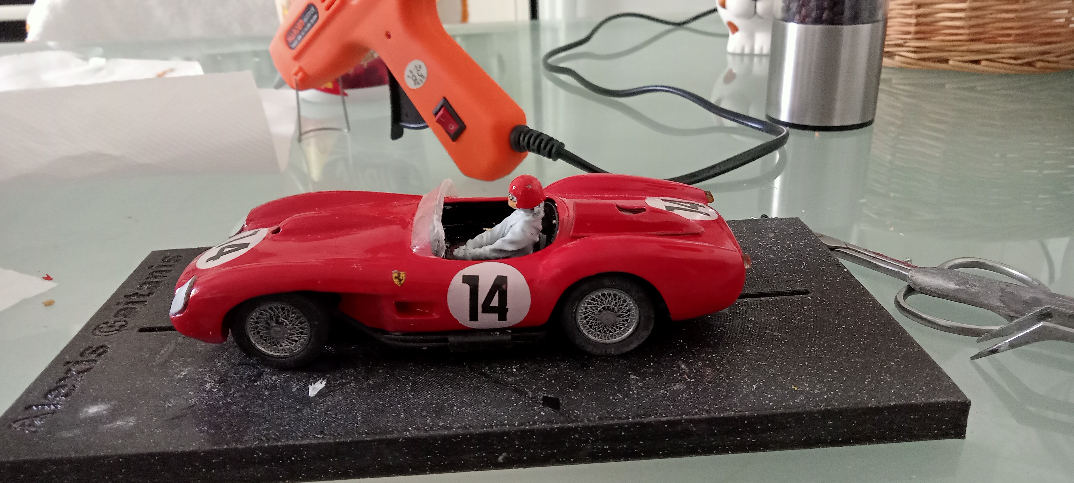

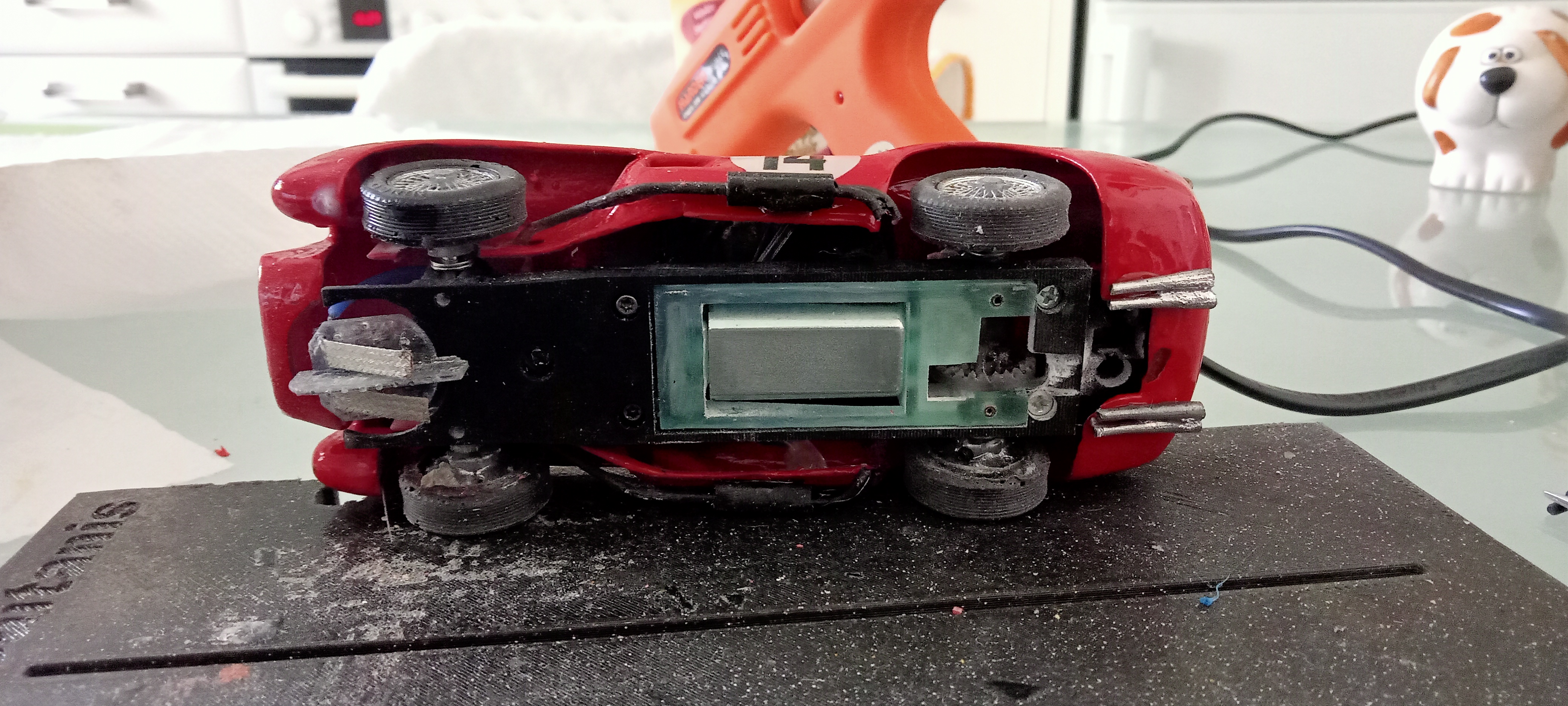

I just finished a Ferrari Testarossa

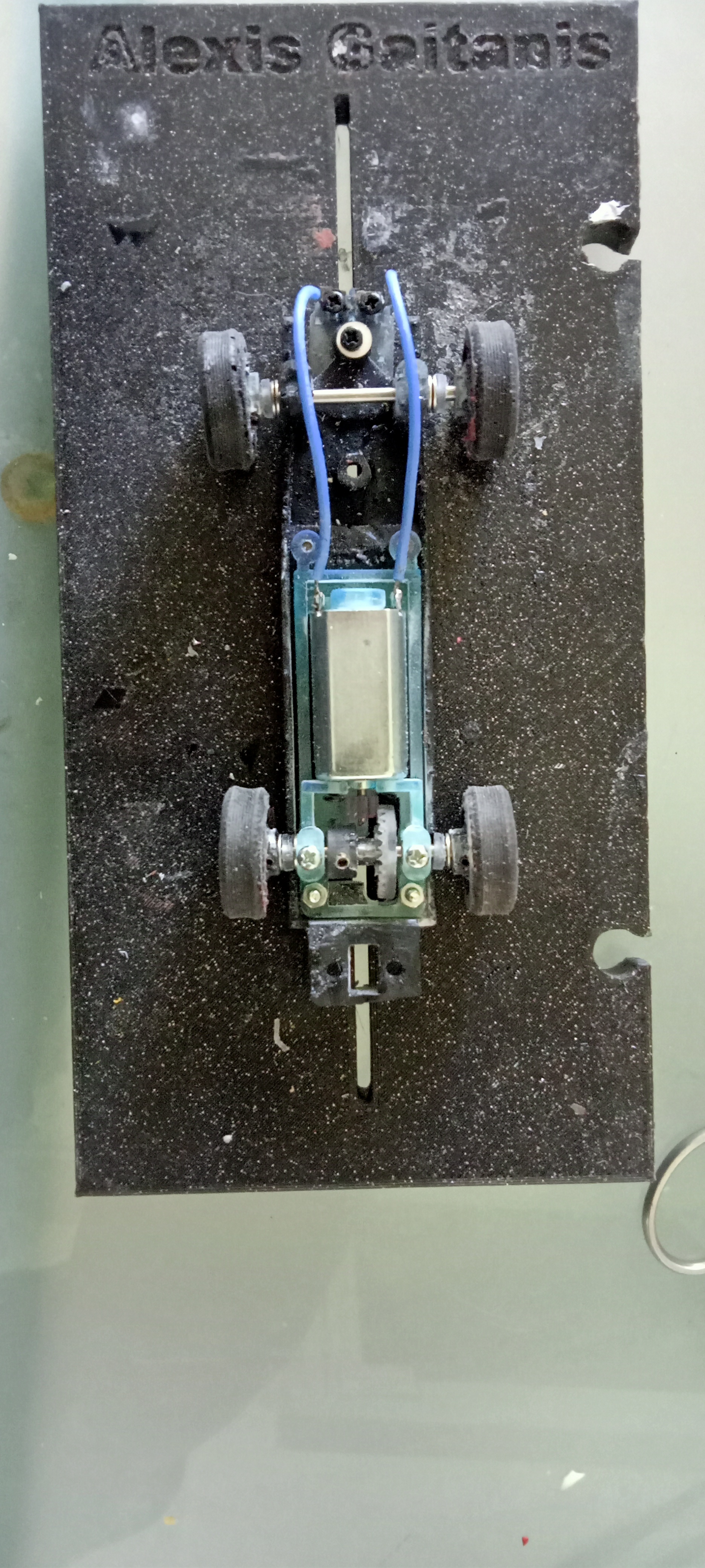

the chassis is very simple,pod designed specially for slim motor because there is not much room in front .
Everything,except motor axles wires screws and braids,is home made,either 3d printed or vacformed
It was the best file i have printed so far,with the body removed
and the body with body posts added

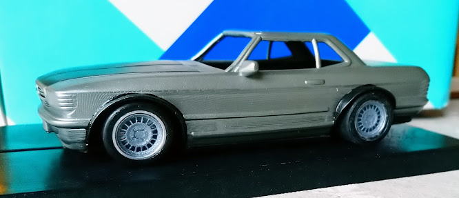

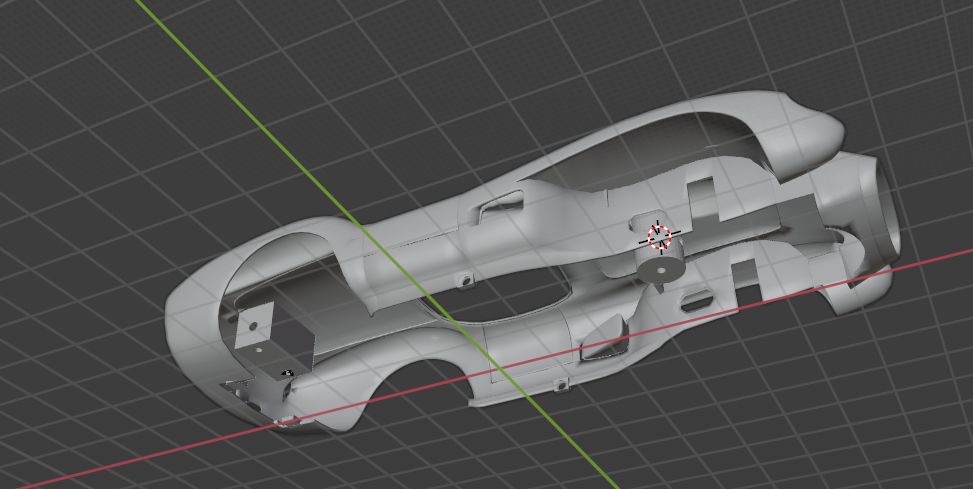

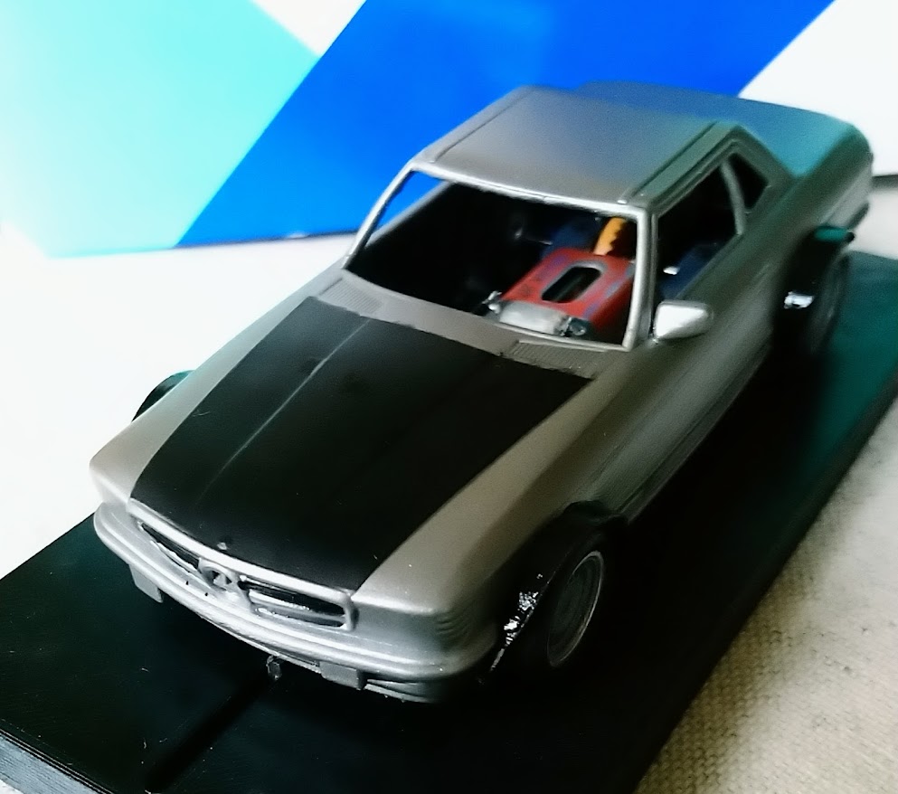

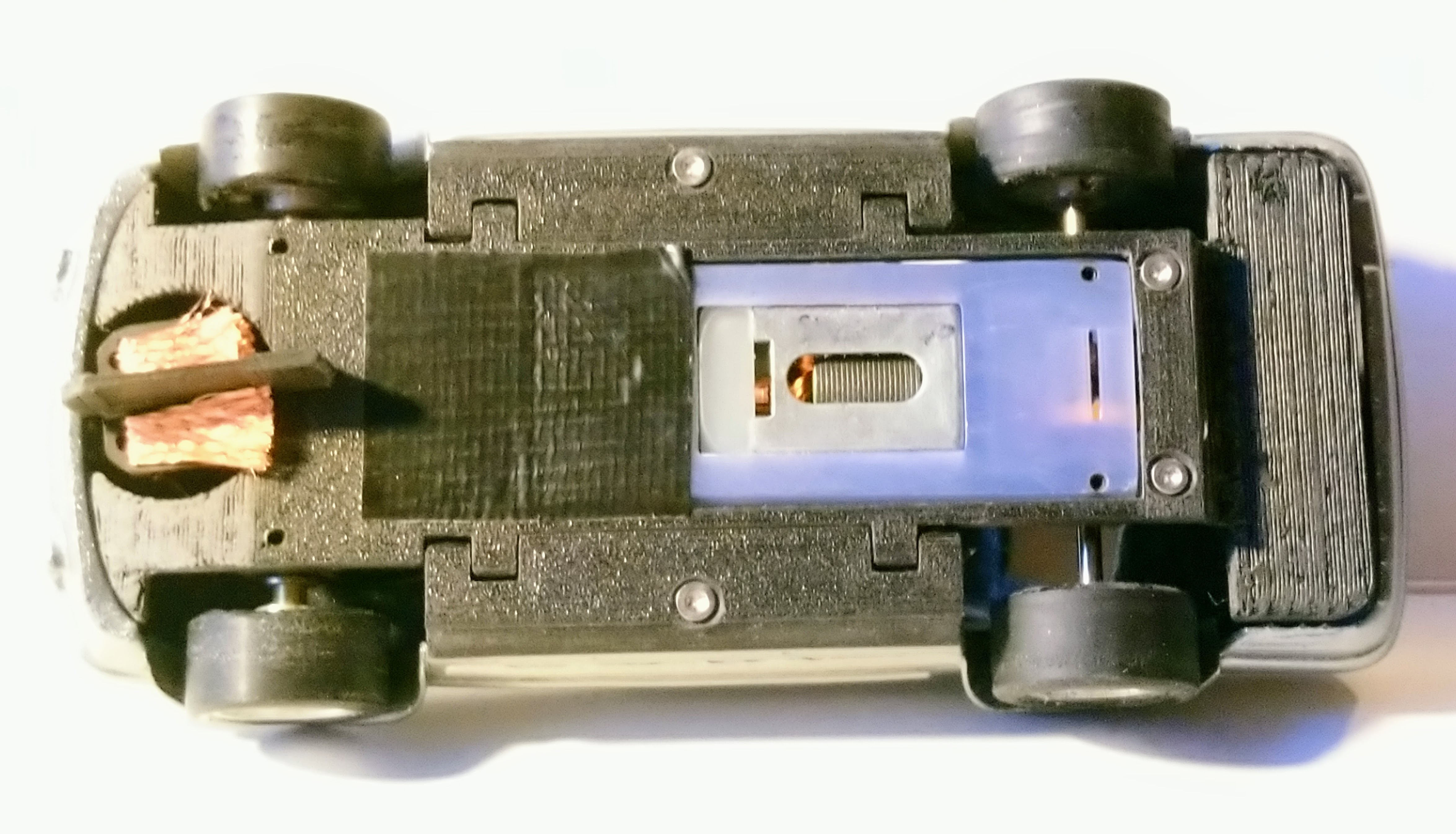

Interesting chassis Kevan, what does the top side look like.

Hi John,
Yes an interesting experiment. I've built two like this, one for a Mini and this Merc. It's a lot more work to get finished compared to a rigid chassis, to be honest there isn't any performance gain so I've gone back to the rigid chassis for future builds.
I'm currently working on a '65 Mustang for the Rally Slotting Proxy and that's got both types but the flexy pan chassis isn't going to be used as two centreline body posts and a floating bodyshell seems to handle better.
