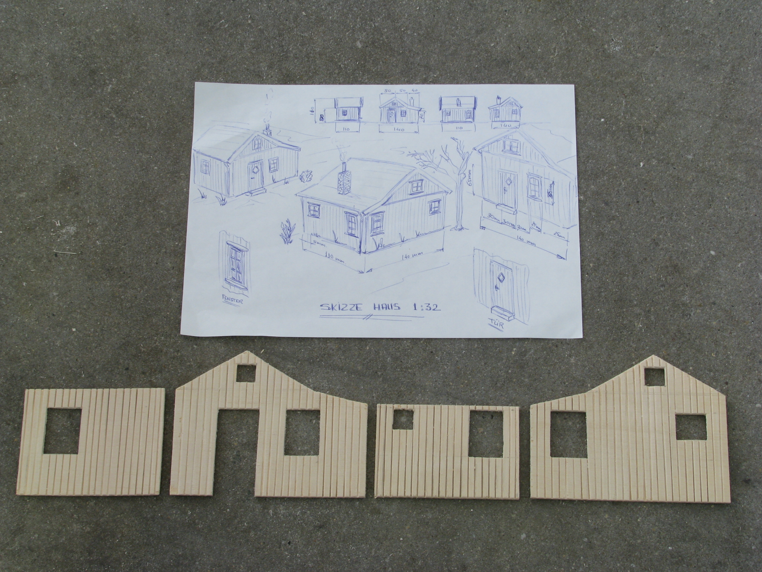

If you want to make your own buildings, here's an example of how I did it on my Swedish Rally Track:
Hub Thumbup
An example could be found in a holiday brochure about Sweden.                            The drawing of the house and the four 3mm plywood walls.
Testing all parts together.                                                                                                             Sawing the walls to get that typical plank structure.

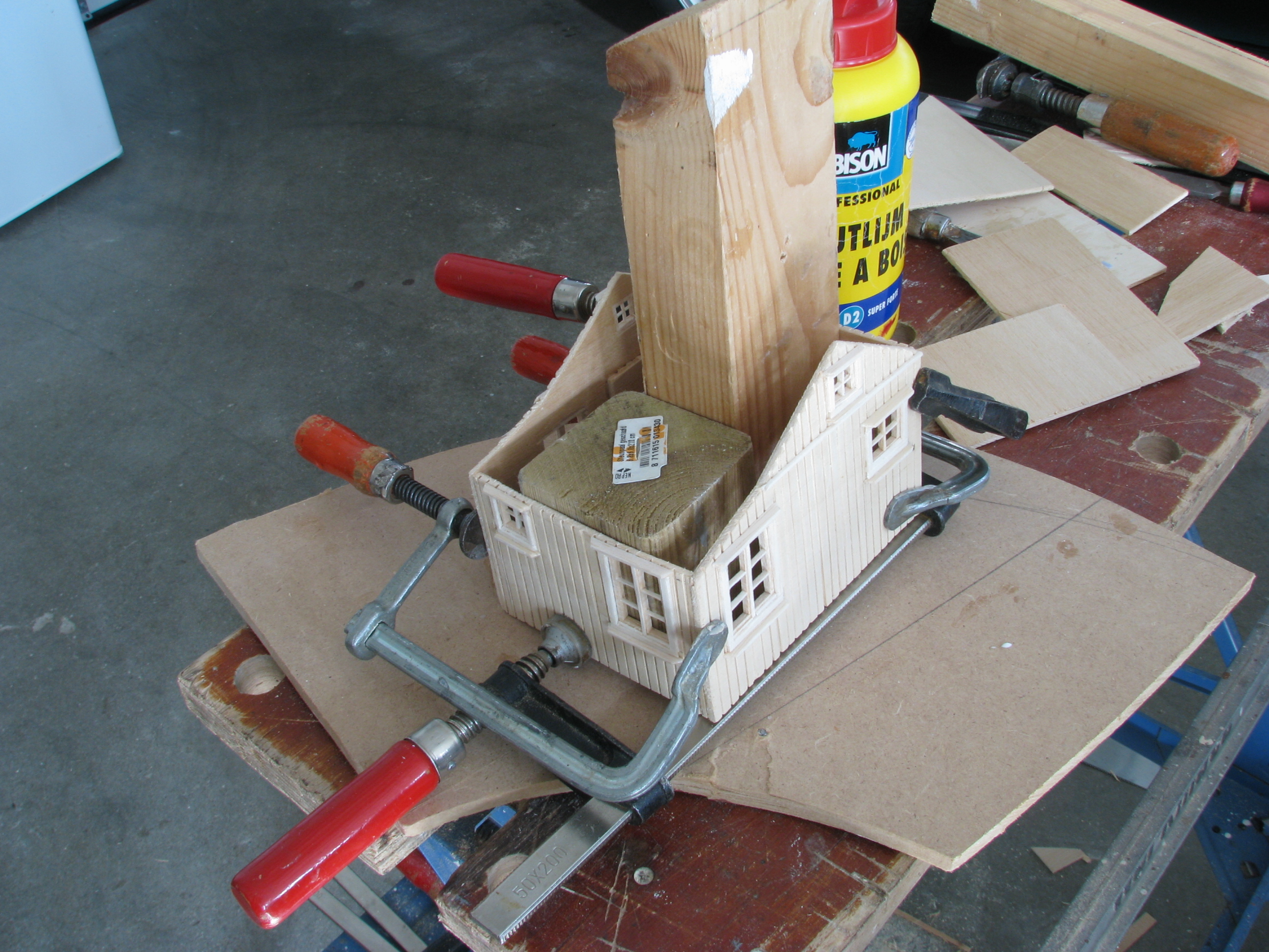

Testing all parts together again before gluing.                                                                    White glue on the walls.
Clamping the walls.                                                                                                                        Clamping the roof to the walls.
