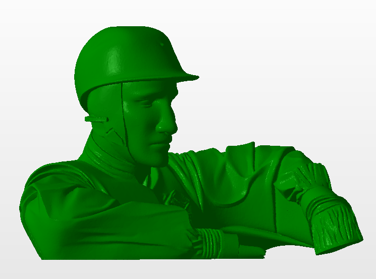

It takes a few minutes to generate a 3D image which will look slightly different as you'd expect but it's passably good.
I run the .stl file through Netfabb to repair the mesh and the end result is pretty good actually.
[attachment=44917]

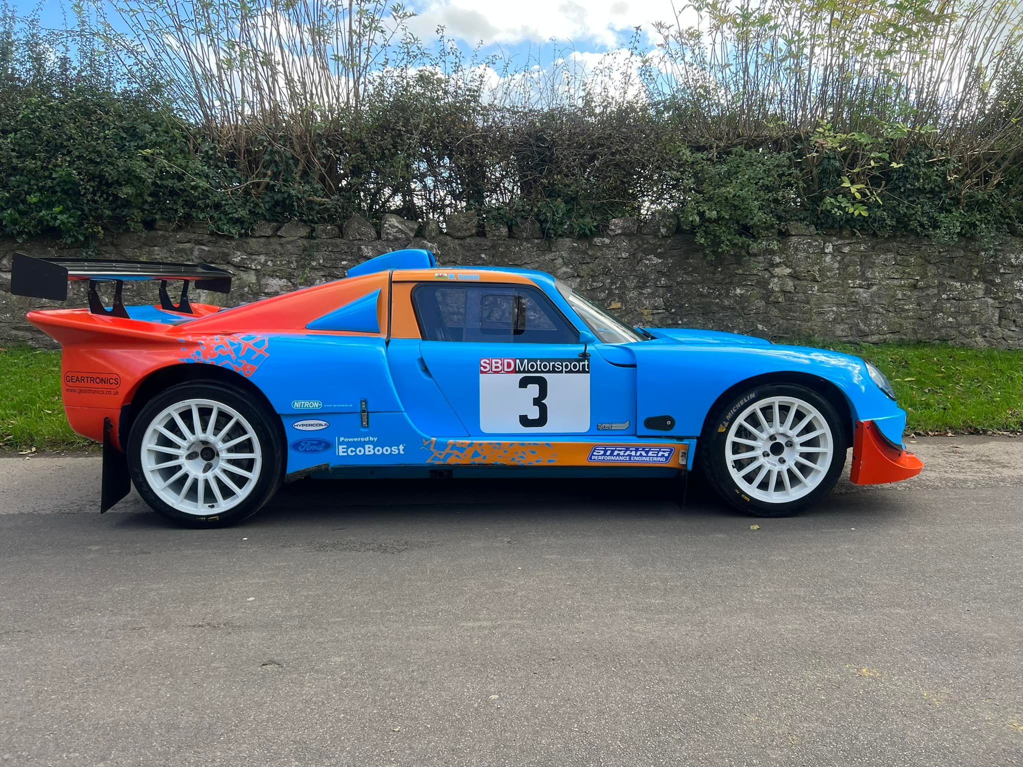

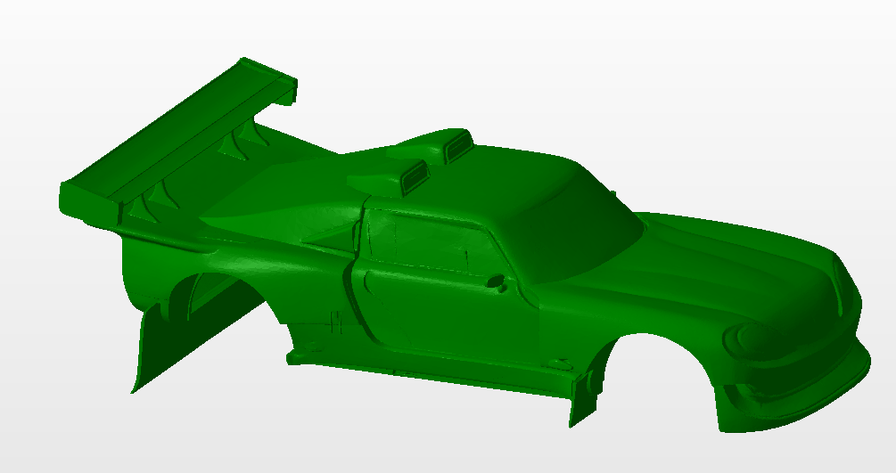

I always fancied a Darrian T90GTR... no 3D file is available and I've even contacted Darrian with the possibility of a 3D file... with no luck although he liked the idea.
[attachment=44918]
After hollowing the file to 1mm in a 3D printer slicer and removing the wheels and floor with simple blocks in 3D Builder... it looks similar enough to a Darrian T90GTR to be worthwhile printing.  The windows can either be cut out like a resin cast bodyshell or further work in 3D Builder to remove most of them that just needs tidying up.
