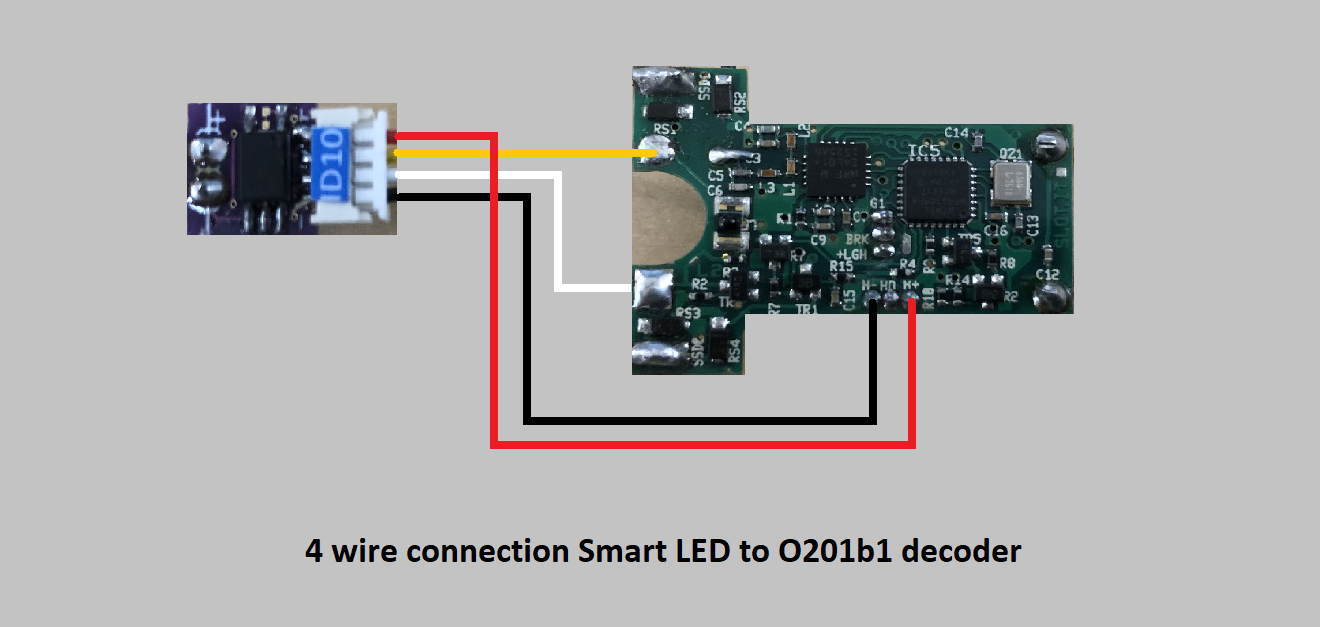

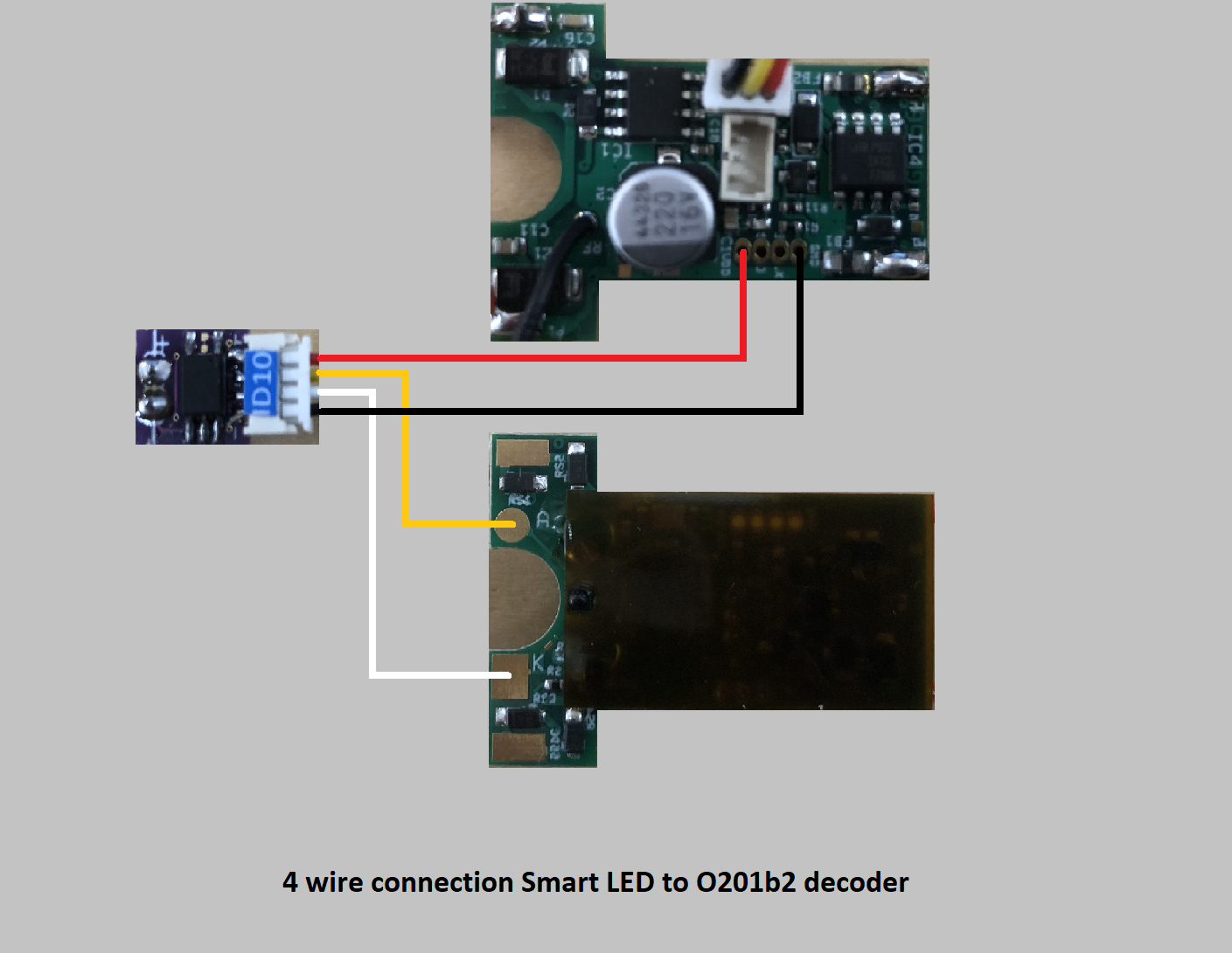

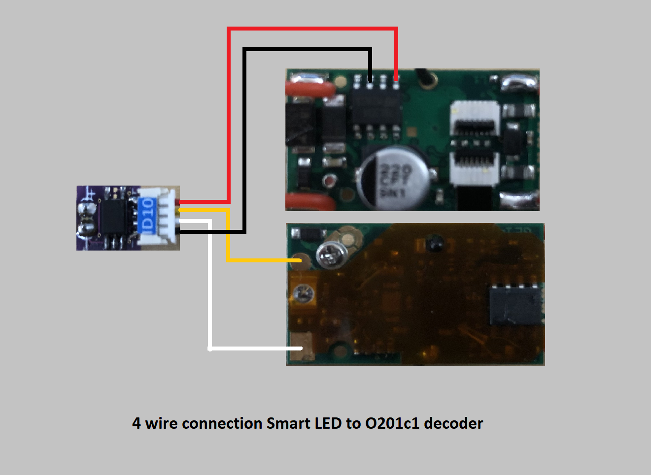

In this post I will focus on how to wire a Smart LED onto each of the three recent/present versions of oXigen wireless decoder.
In each case the Smart LED requires connection to four points on the decoder:
RED: +3.3 Volts
YELLOW: LED+ (or LED Anode)
WHITE: LED- (or LED Cathode)
BLACK: Zero Volts
Equipped with a fine tipped soldering iron the correct wiring points are shown below for each of the recent/present oXigen decoders. As you will see, the external LED attachment points are used in each case plus two further connect points for power.
c
[attachment=34975]
[attachment=34976]
