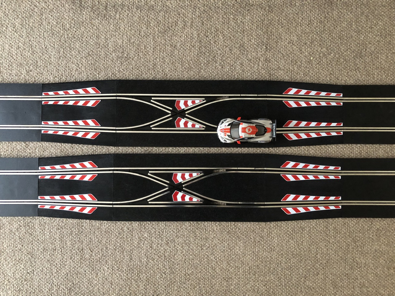

Dr_C - Dr_C2 - 12th-Mar-24
[attachment=34240]
The test hardware is starting to take shape. It’s always nice to show a photo :)
Initially the Ninco lane changers will be integrated with Scalextric Sport track using off-the-shelf adapters.
Next to add the under-track continuity wiring, the flipper mechanisms and some home-brew LC electronics and firmware.
