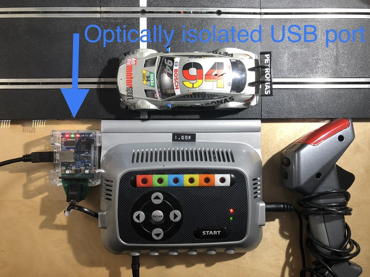

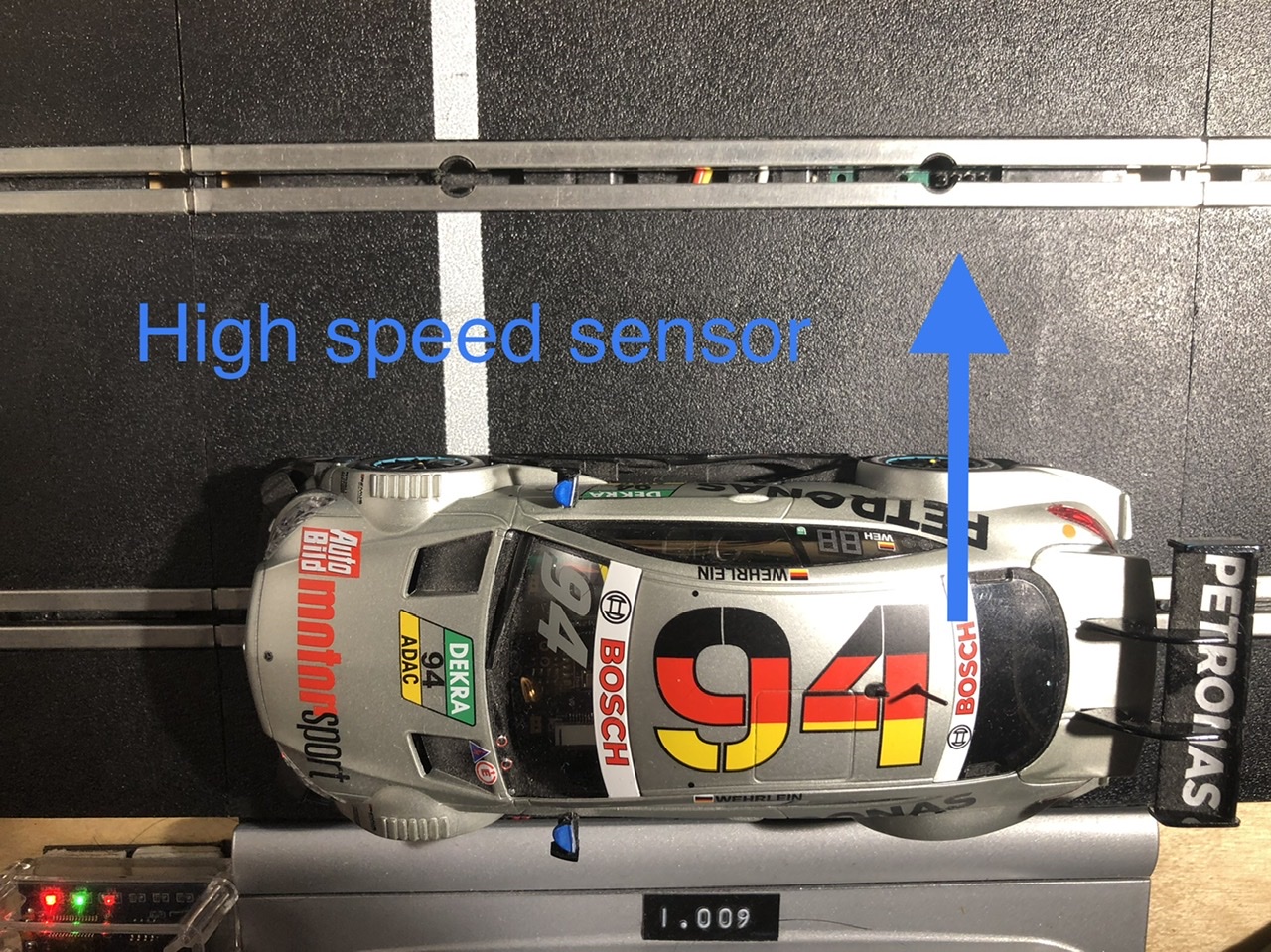

I’ve been exploring upgrade options for the APB C7042 including the addition of an optically isolated USB port (first photo) and upgraded high speed lap counter sensors (second photo).

Upgrade 1/ Optically isolated USB port
The purpose of this upgrade is to add industry standard techniques which are designed to reduce risks of electrostatic damage and/or ground loop effects when using RS485 serial communications hardware. The approach replaces the ‘standard’ hard-wired USB-RS485 cable with an ‘off-the-shelf’ optical isolation module. Optical isolation means there is no physical electrical connection between the USB port and the internal workings of the APB so there is no route for electrostatic conduction or ground loops. In particular this should eliminate the APB problems associated with accidental ‘hot-plugging’ or ‘hot-unplugging’ which has been reported to damage APBs.
Upgrade 2/ High speed lap sensors.
These replacement sensors address the issue observed with the standard APB (firmware v1.009) where lap detection is unreliable for cars on ID6 when travelling at speeds in excess of 6.7m/s. Three users have reported experiencing this problem on real raceways (both routed and plastic). In each case a 4-four phototransistor upgraded sensor board has fully resolved the issue.
Although the APB has been around for many years it is interesting that new upgrade opportunities are still possible snd worth considering.

RE: Upgrading the Scalextric APB C7042 - woodcote - 14th-Nov-23
The isolation on the RJ port is a nice upgrade. Despite being super-careful, we’ve fried two of Riko’s cables in ten years.
Any lap counting issues we’ve avoided by APB placement - but that’s not always an option on a permanent home track.
RE: Upgrading the Scalextric APB C7042 - Dr_C2 - 14th-Nov-23
Thanks Andy,
And just to add, the ‘riko cable’ is a well established and well liked solution. For most, a mean time to failure of 5 years sounds pretty good. The opto-isolator approach is simply another option for consideration. As mentioned the module is available online from computer stores.
‘DSD TECH SH-U11F Isolated USB to RS485 RS422 Converter Built-in FTDI chip for Industrial Application’
If anyone is interested, it does require a three wire connection into the APB i.e. A,B and 0V. And of course, these three wires are fully electrically isolated from the incoming USB wiring - which is the whole point :)

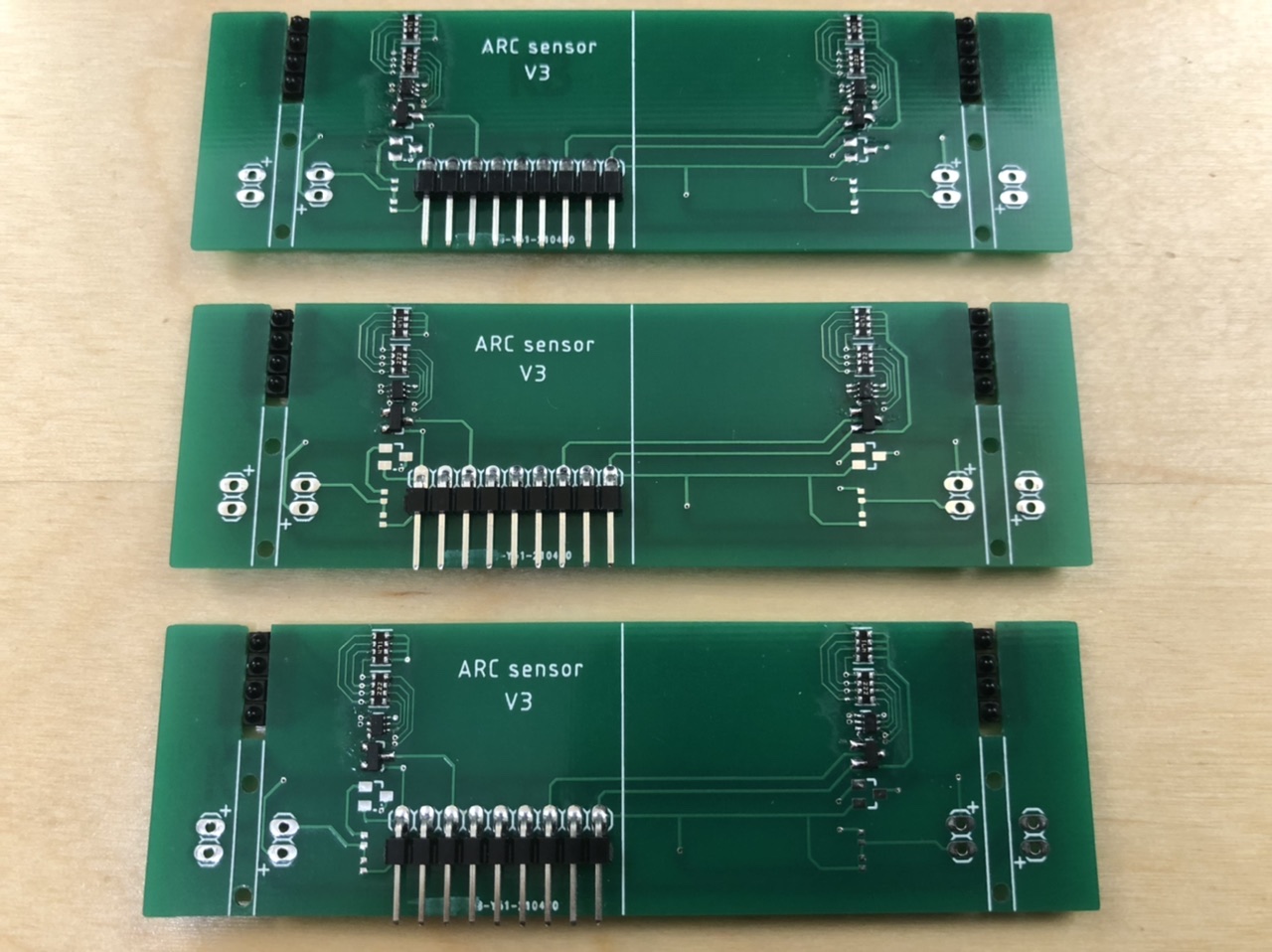

[attachment=32455]
This photo shows the upgraded sensor boards as fitted into APBs. The boards can be used with the APB, as here, or the ARC PRO. When used for the latter, a few additional components are added to enable IR blade detection. These were assembled a year ago and then dispatched to SSD users in the USA.

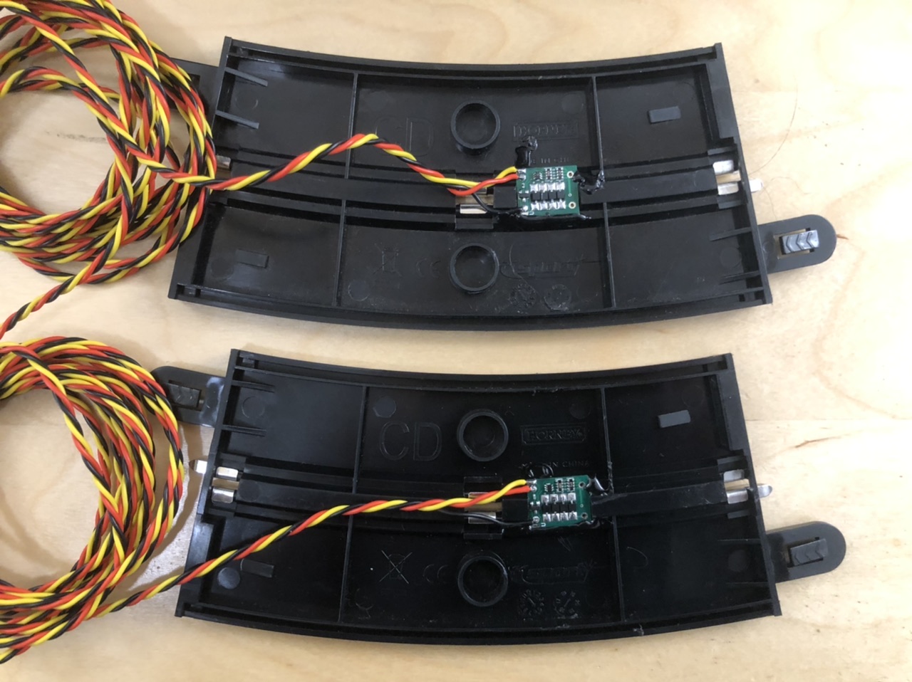

[attachment=32456]
This photo shows a similar four-phototransistor design designed for single lane use or where lane pitch is non-standard. This of course corresponds to pit lanes or more generally for routed tracks. These types of sensors have been in use for a couple of years and build on a prototype design which was first tested back in 2019. All user feedback to date has been highly positive.
Used as pit sensors the boards can interface directly onto Arduino digital input pins so great for DIY-ers too.

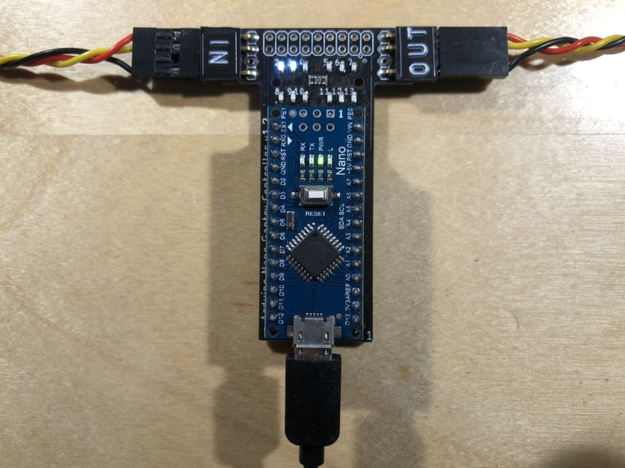

As mentioned earlier, the four-phototransistor ID sensors I have been working on can be used for pit lane sensing and they can interface directly onto the GPIO pins of an Arduino Nano. So now there is another option for pit lane sensing.
[attachment=32699]
The red/yellow/black wires connect to the two sensors for pit-in and pit-out respectively. The Arduino Nano carries firmware - either Kare’s or mine - which reads car IDs and outputs the data to the race management system (typically RCS64). The prototype system has been installed in a digital racetrack for approximately 12 months and has performed faultlessly. Big thanks to Dave for doing masses of kind and careful testing at track level.
Also thanks to Kare - with his firmware we were able to implement the start lights gantry too.
My software currently detects IDs but I’ve not yet go round to adding the coding for the start lights.
Anyway, a couple of sensors and an Arduino Nano make a very nice pit lane sensing system IMO.
