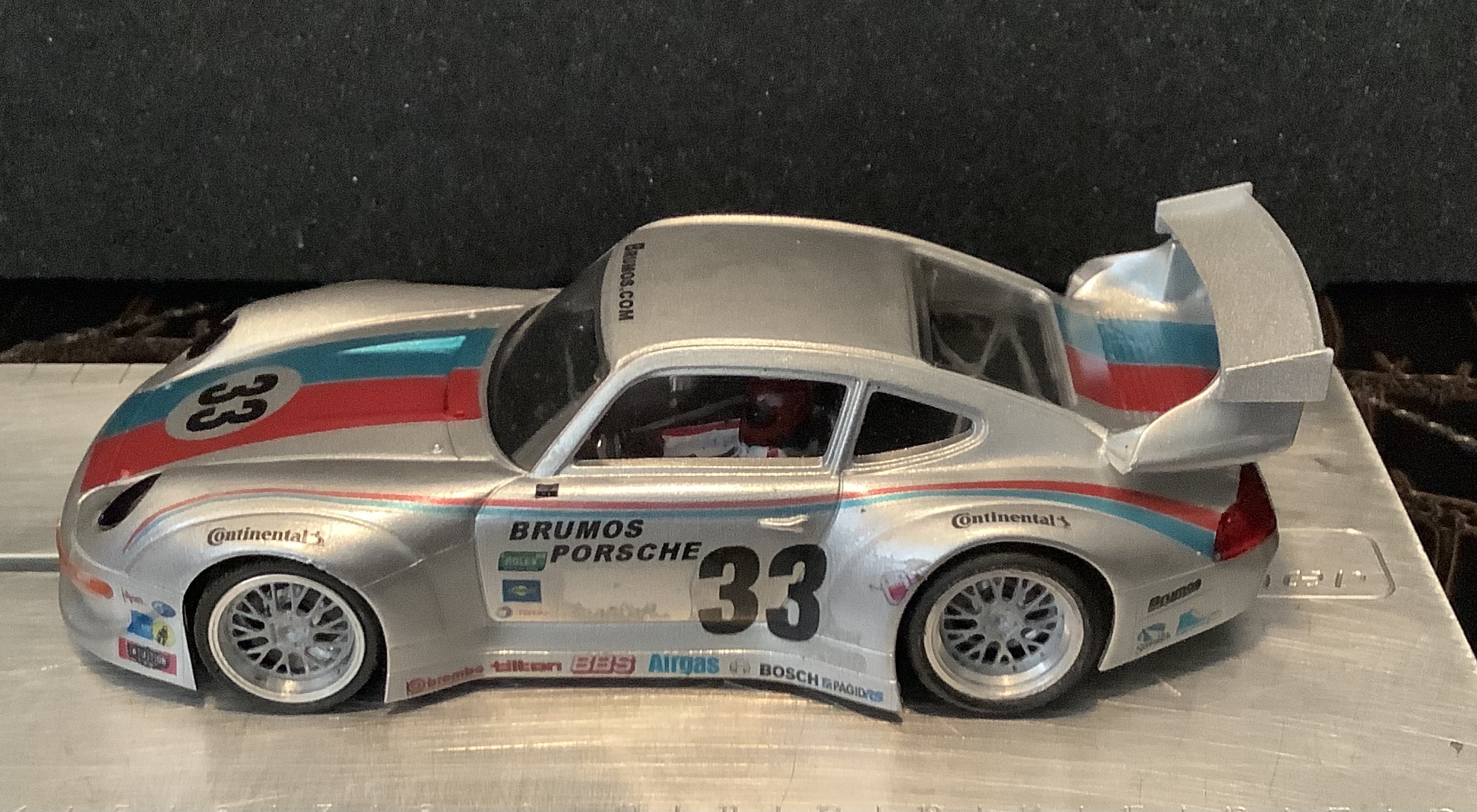

The Revoslot brand drives very different from conventional high end slot cars.  I promise you the more you drive it the better it becomes. Additionally there are minor items that he videos supplied by Kevan address.  Follow the videos, reset your gear mesh and continue to drive the car.  The toughest thing, Revoslot cars are designed to run against other Revoslots. We have a proxy running state side and the racing has been very close with multiple winners and a if your tires are not worn out the performance we have seen is improving at each venue.
[attachment=19463]
